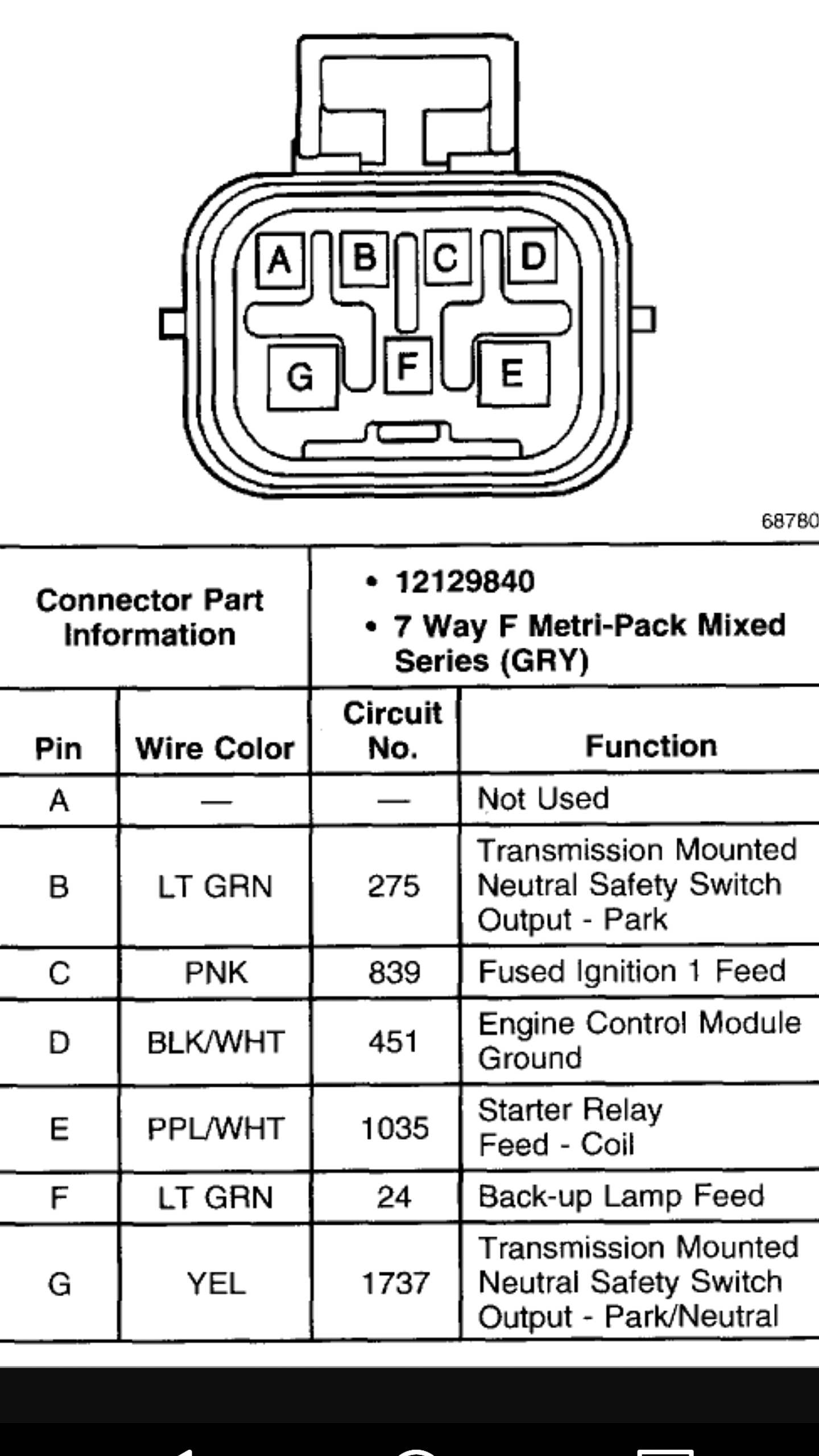

So im not getting any power to those sockets. Got a test light this morning.
Jan 11, 2016 at 12:34 AM
PACO8224
  • 117 POSTS
Ok check the light green wire coming from the safety neutral switch on the trans. With the test light It should be located on the f slot here is a picture of it to give you a better idea.
Jan 11, 2016 at 1:12 AM
CHEVY__88
  • 104 POSTS
So i can just have the key on and not the whole truck? Or should it matter? And does it need to be in reverse?
Jan 11, 2016 at 1:19 AM
CHEVY__88
  • 104 POSTS
Ok theres two plugs. One on the driver side trans and one closer to the back?
Jan 11, 2016 at 1:36 AM
CHEVY__88
  • 104 POSTS
The top right was the only one that lit up and it was not a green wire

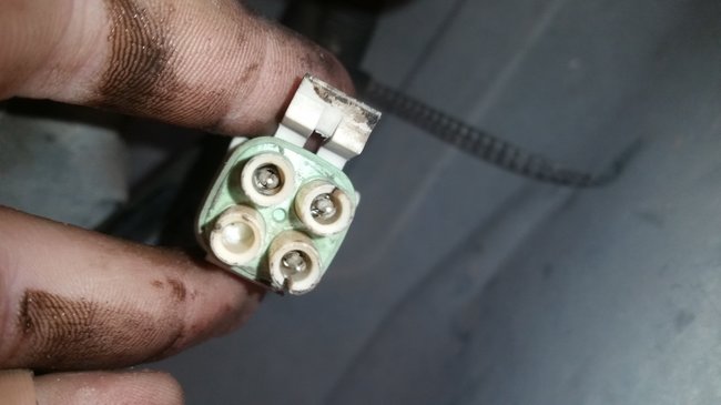

PACO8224
  • 117 POSTS
Ok I think yours is located on your steering column on that year truck let me do some research and I'll get back to you.
Jan 11, 2016 at 2:37 AM
CHEVY__88
  • 104 POSTS
Well if it is then it dont have any wires going to it
