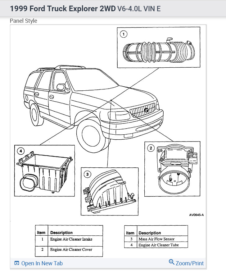

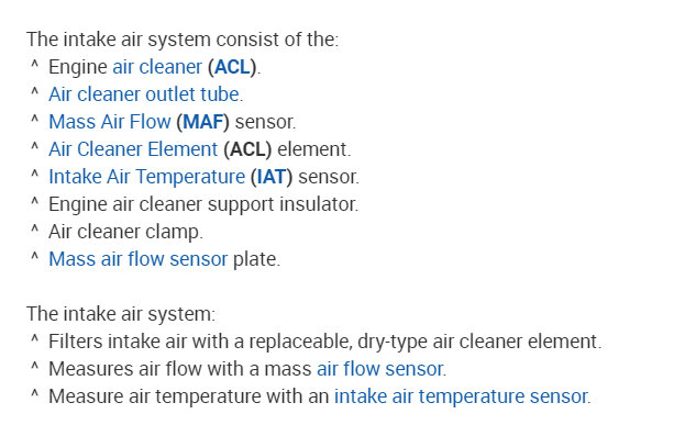

Does is stall in drive as well? If not, I would look at the air intake tube to see if there is a tear or it is loose which will cause the MAF sensor to lose its readings. If it stalls in both reverse and drive please follow this guide:

Did you recently disconnect the battery or clear diagnostic trouble codes? Either of those would cause them to be incomplete.
As far as the stalling, does it do the same thing if you place it in drive? Also, when it finally restarts, do you notice gray or black smoke from the exhaust?
Let me know those things. The vehicle has an idle air control valve that may be failing or the airway to the throttle body may be plugged.

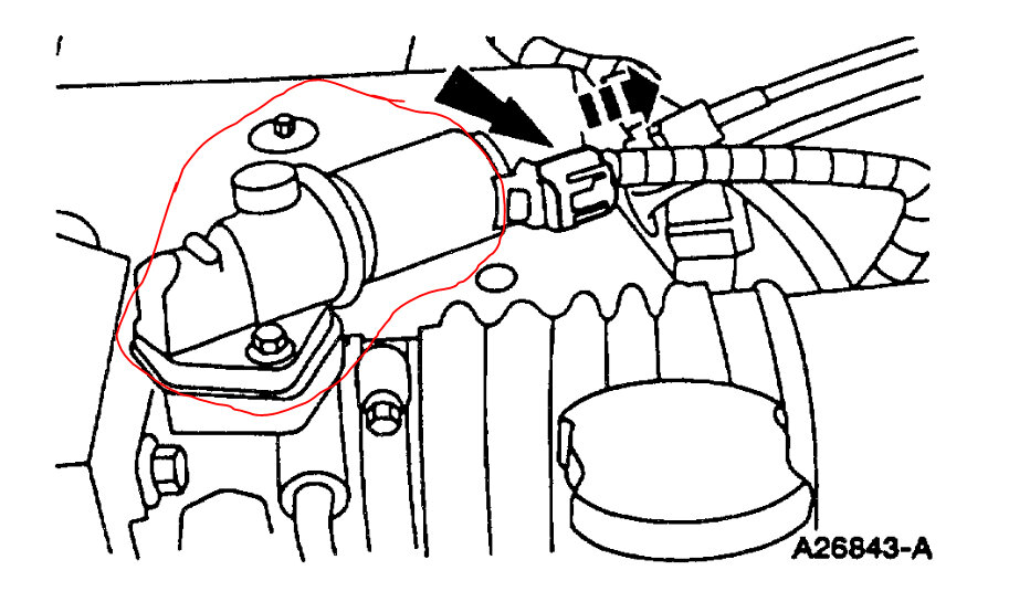

It sounds like you have either an engine vacuum leak or the idle air control valve (IAC) is failing or needs to be cleaned.
Let's start with checking for an engine vacuum leak.
Here is a link that explains how to do it:
If that doesn't prove helpful, the next thing I would recommend is to remove the idle air control valve and service it.
The idle air control valve is located on the throttle body. I attached a pic below to help you locate it.
Additionally, here is a link that explains how to service one:
https://www.2carpros.com/articles/idle-air-control-valve-service
Let me know what you find or if you have questions. Also, let me know if I can help in any way.
See pic below.

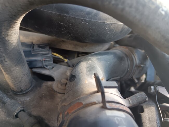

There is a small hose that's connected to the air filter that is cracked, could that be the problem?
Mar 25, 2023 at 7:01 AM
  • 110,244 POSTS
If it leaks, yes, it will allow unmetered air to enter the engine. That can cause a rough idle and stalling.
I can't tell for sure what the hose is going to. Is that the intake manifold?
