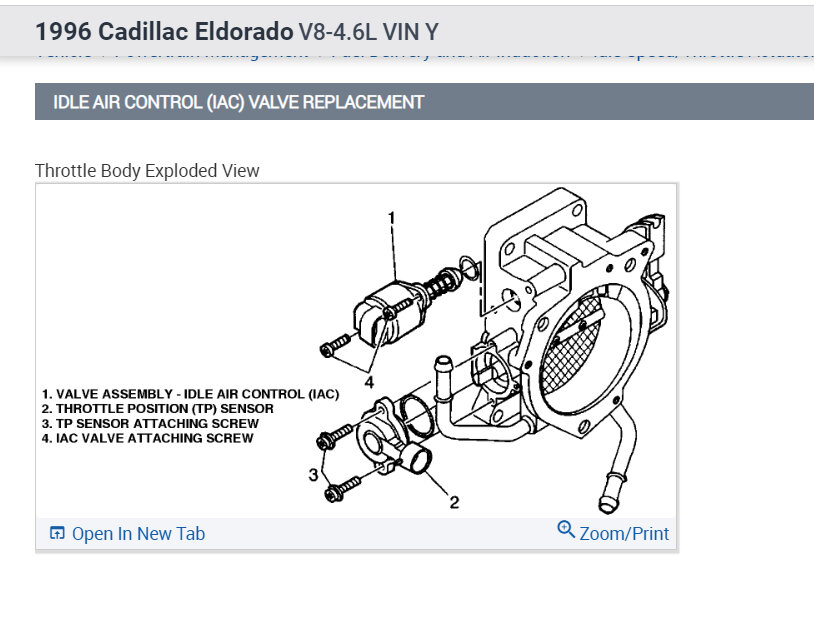

As mentioned, the car gets dangerous when the engine gets to the normal temperature.
A° As long as the engine is cold, it runs quite okay.
But,
B° When getting a normal temperature for its use, the engine goes wrong :
It goes up and down, but never stays stable.
when , and it does, happen when running , then if at low speed the engine stops : therefore the car is not drivable : loss of the assisted wheel system
Let me know where to a) check, and b) to change a temperature sensor , if this is the possible reason ...

Hello Didier,
It sounds like the IAC control is not working correctly, do you have a check engine light on? We should run the codes to see what comes up, here is how to get the codes.

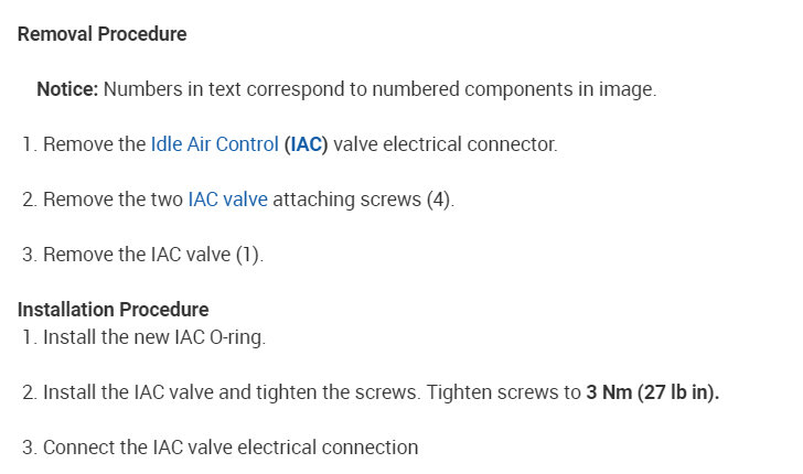

Here is the IAC motor so you can change it out. Check out the images (below). Let us know what happens and please upload pictures or videos of the problem.
