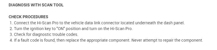

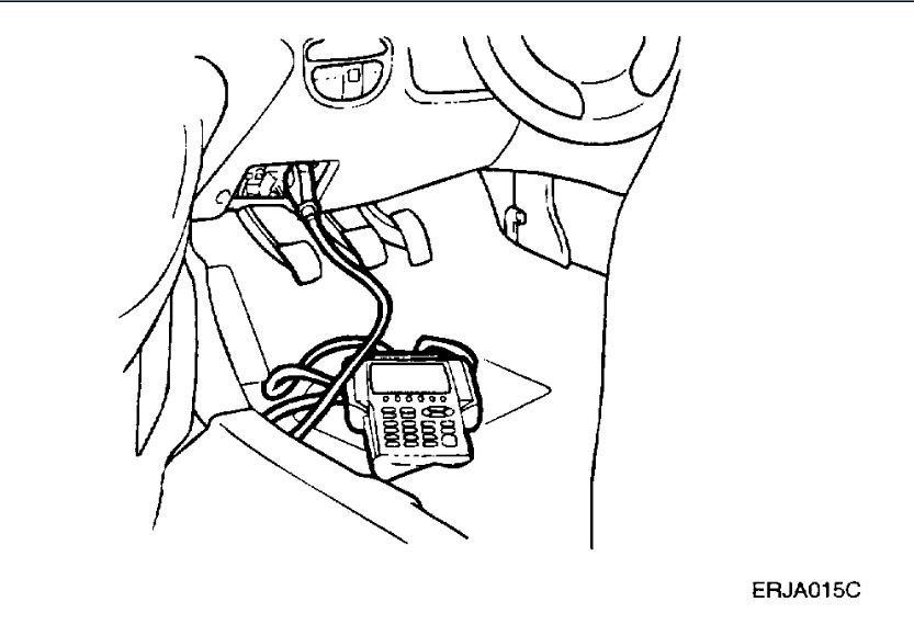

Is there a way to retrieve engine codes without a scanner?
Feb 16, 2020 at 1:30 AM
Good morning,
No, you need a code reader to access the ECM for codes. You can have them read for free at a parts store.
What is the exact issue?
Feb 16, 2020 at 1:42 AM
I attached the location of the data link connector and the procedure.
