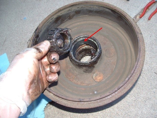

I dismantle the drum and i removed the two tapered bearing (the small and and bigger one). I would like to send it to resurfacing, so i would like to know if i can sent it without remove the inner race (attached photo)? Will it disturb to lock the drum into the axis of the resurfacing machine and the machine may damage the race?or i can leave it as it is?
Thanks.

Here is the attached photo.My drum more or less looks like that.

Most places will turn the drum using a tapered arbor on either side of the hole. The will center up in the cast iron, not the races.

You mean"leave the bearing's races in the drum"

Normally, the shop will clean off the drums before the machining is performed. (They are used to dirty stuff showing up).
They won't mind if you do it! If so, "Purple Power" works really well on cleaning oil and grease if it's available to you.
Leave the races in the drum. If for some reason they are in the way, the shop will probably remove them.
It is the norm to resurface the drums/rotors on the same axle (both sides of the vehicle). I'm saying either both of the fronts or both of the rears, not just one. The same goes for shoe/pad replacement, do both sides, not just the one that is completely worn out.
The handbrake issue could be that one of the cables might be seized or getting close to it. Sometimes, it's as simple as the shoes are not adjusted out close to the drum or even the self adjusters are worn or rusted and are not constantly adjusting the slop/ play/ gap from between the shoes and the drum.
