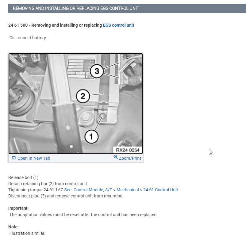

ya I have seen that one, is there any instructions on how to reset the adaptation on this one?
Jan 9, 2020 at 4:01 AM
Yes. See the "Important" section on the attachment. You can do it but it is only done with the scan tool capable of performing this task. The manual doesn't give specific steps on how to do it but I imagine it is just like other OEMs that when the scan tool is hooked up and you go into the the control module it is an option to reset adaptive values.
Sorry I couldn't be of more help on this specific issue.
