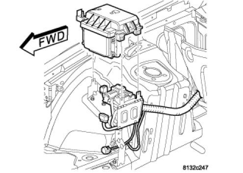

Here are the directions (if needed) for removal and replacement. The attached pics correlate with the directions.
____________________
Removal
2008 Dodge Charger V6-2.7L
Removal
Vehicle Power and Ground Distribution Power Distribution Module Service and Repair Removal and Replacement Integrated Power Module Removal
Pic 1
NOTE: A battery reconnect procedure must be performed anytime the battery has been disconnected. See: Battery > Procedures > Battery Reconnection.
1. Disconnect and isolate the battery negative cable (2).

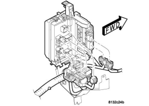

pic 2
2. Open the battery cable nut cover to expose nut.
3. Remove battery cable nut and battery cable from the Integrated Power Module (IPM).

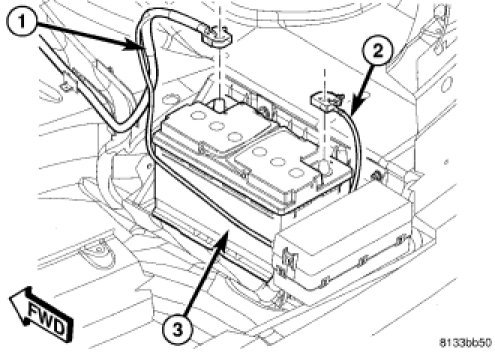

pic 3
4. Disengage the outboard retaining clip, and rotate the IPM to access wire harness connectors.
5. Disconnect wire harness connectors from IPM.
6. Disengage the two inboard retaining clips.

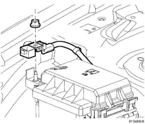

pic 4
7. Remove IPM from vehicle.
