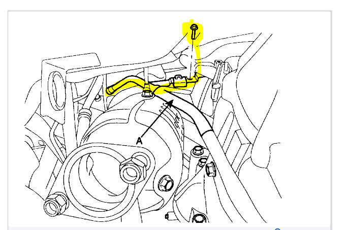

I have gotten to my starter and have my manifold ready to remove but the oil stick is in the way and there is no way to get to it with the motor in the way, but I'm at home and need it done by tomorrow. Is there any way to remove the oil stick without moving the motor or motor mounts?

If it is the transmission dipstick tube that is the issue, there is a bolt holding it in place behind the catalytic converter. See pic 1.

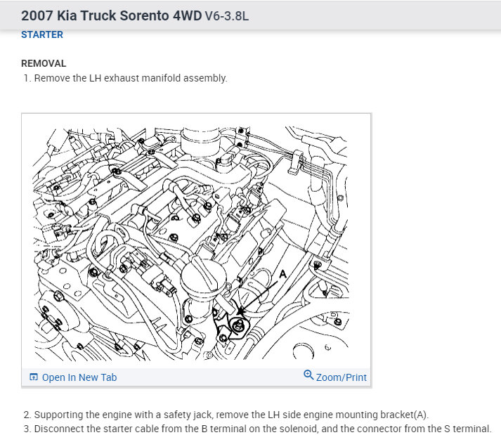

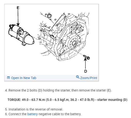

However, the directions indicate the engine needs to be lowered for the removal of the starter motor.
I attached the directions I have below. Take a look and let me know if this helps or if you have other questions.

Chances are you won't get the manifold out. I have no idea why people design things like this.
As far as I know, the engine needs to be lowered. However, anything is possible. As far as lowering the engine, it sounds like a nightmare, but it's not as bad as you would think. You don't need the tool that is listed. You could use a floor jack to gently lower it once the mount is unbolted.
Let me know if you have questions and if I can help.
