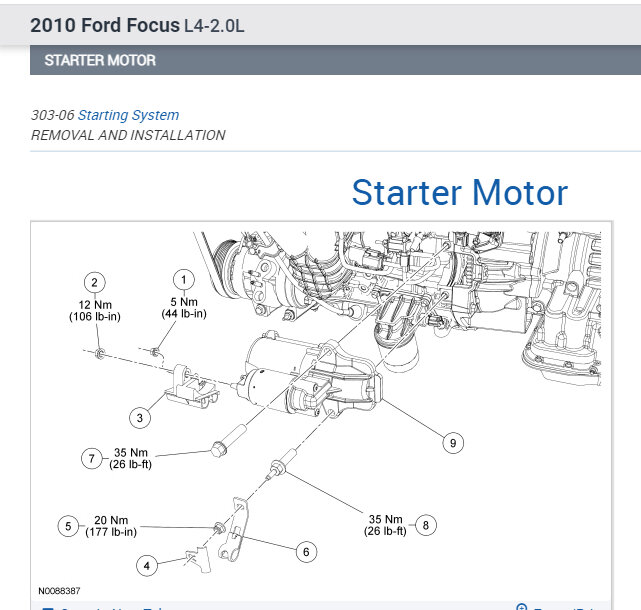

Trying to see what tools I need to change my starter.
Oct 12, 2022 at 8:31 AM
  • 110,236 POSTS

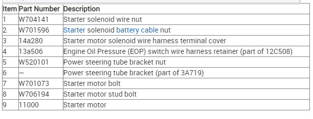

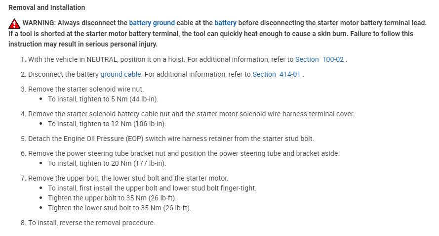

This is a straightforward job on this vehicle. You will need the basics, wrenches, sockets/wrench, and there is a chance thing such as screwdrivers and pliers will help but shouldn't be required.
Here is a link that you may find helpful:
Also, I attached the directions below specific to this vehicle. Take a look through them and let me know if you have any questions. Note: Do not start working on the starter motor until the negative battery terminal is disconnected.
Let me know if this helps.
