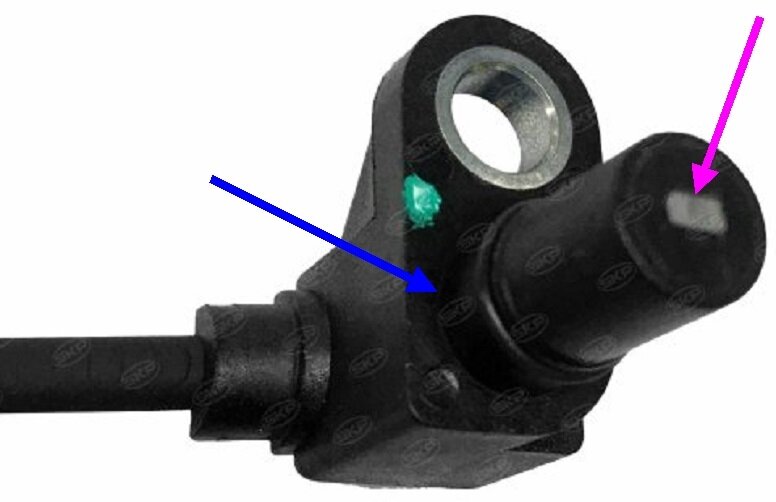

By unplugging a sensor to cause the system to turn itself off, you proved the base brake system is working properly. The next part of this story depends on the fault code number and description. That will help us determine what the ABS Computer was detecting. Without knowing that, I can still share the common problems you might be experiencing. One is a buildup of rust or metal particles on the end of one of the sensors. The pink arrow in the photo below is pointing to the exposed end of the magnet where debris can accumulate. Signals are generated by the teeth on the tone ring passing by this magnet. They disturb the magnetic field, and by it changing, it induces a signal voltage in the coil of wire wrapped around that magnet.

The first problem is when debris builds up on that tip, it reduces the amount of change in the magnetic field, so the signal voltage drops lower. As I mentioned, this sensor already produces a very weak signal. When debris reduces the signal even more, it may become too weak for the computer to see, so it thinks that wheel has locked up, perhaps while the other wheels are reading 25 mph. In response, the computer pulses the brake fluid pressure to the "locked" brake to try to get that wheel spinning again. You would feel that pulsation in the brake pedal. Also, depending on the design of the system, it is possible for the brake pedal to slowly sink closer to the floor during the activation. The clue is once the vehicle slows enough for the system to stop activation, the brake pedal will feel normal again.
The second, and probably more common problem these sensors develop is rust buildup under the sensor's mounting surface. My blue arrow is pointing to that area. That buildup pushes the sensor away from the toothed ring, resulting in a much weaker signal being developed. The first thing I like to do is watch the road speeds and sensor signal voltages on a scanner during a test drive. When they all agree on road speed, it's a good indication the sensors are working. Next, I watch what happens when slowing down. Between roughly 20 - 30 mph, if one sensor drops suddenly to 0 mph, or the signal voltage is much lower than those for the other sensors, it's a good indication of rust buildup.

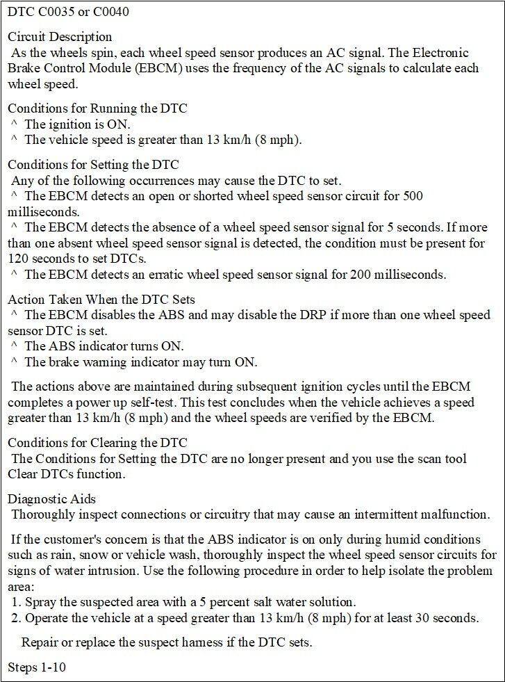

Thanks for your reply. The original code was c0035 for the front left sensor. The wire was shredded from coming off the clip and rubbing up against something. I went ahead and replaced the right side as well, and cleaned both sides all around the hubs and unfortunately still having the issue of it vibrating/pulsing when coming to a stop.

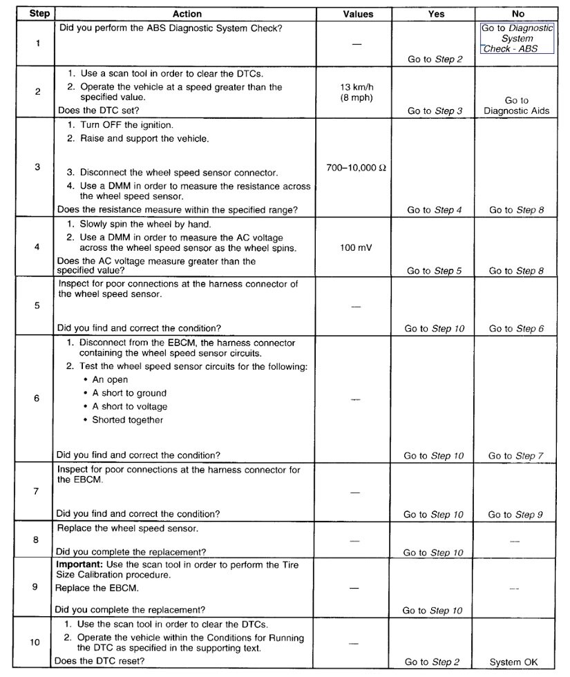

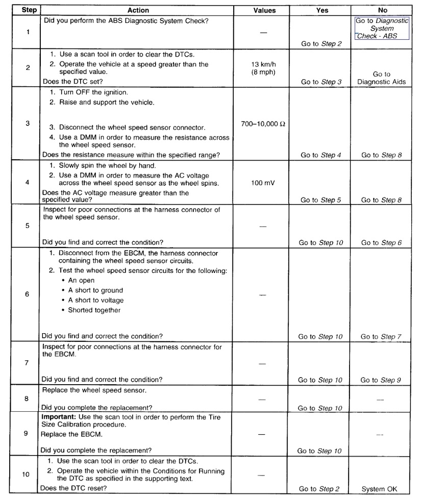

First, here's the diagnostic chart for code C0035 for you to peruse. If they're too small to read, copy and paste them into a typing program like MS Word where you can expand them, or I can cut them up and expand them for you if you give me a little time.
Your system stops working below 8 mph so you should not feel that pulsing below that speed. At this point one of the speed signals is too low in voltage, so it's dropping out at too high a speed. That makes the computer think that brake has locked up and that tire is skidding. It's going into action to prevent that lockup when it isn't needed. At this point you need a scanner to view the wheel speeds or the signal voltages of each sensor to see which one is causing this. The offending sensor will show a signal voltage significantly lower than the others, or it will read 0.00 volts when the wheel is still spinning, or the road speed will show 0 mph.
As a side note, for this type of symptom, the system is operating correctly, (in its mind), which means electrically, all the sensor circuits are okay. You've handled any broken wires or bad connections. Now you're looking for a mechanical issue like the rust on the tip of the magnet, incorrect spacing of the sensor, and things like that.
