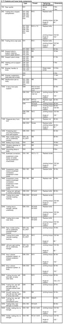

Here are the directions to replace the glow plugs. However, the intake manifold needs removed first. I will add those directions after glow plug replacement. The attached pictures correlate with the directions.

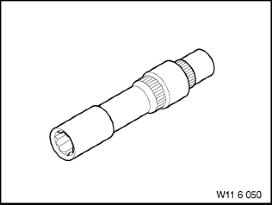

Special tools required:
- 11 6 050 See: Engine > Electrical / Mechanical Repair > 11 6 050 Socket Wrench Socket WAF 10
- 12 2 300 See: Glow Plug System > Electrical / Mechanical Repair > 12 2 300 Special Pliers for Glow Plug Connector

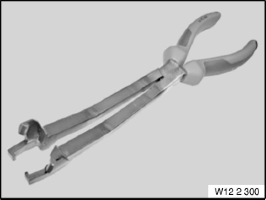

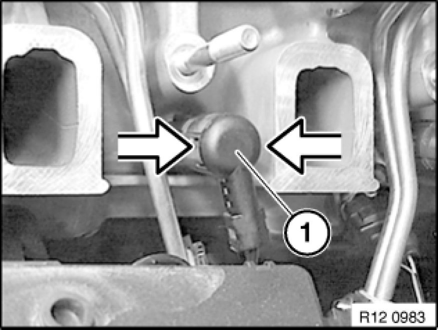

Unlock plug (1) with special tool 12 2 300 See: Glow Plug System > Electrical / Mechanical Repair > 12 2 300 Special Pliers for Glow Plug Connector and detach.

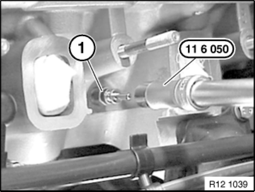

see pic 4
Release glow plugs (1) with special tool 11 6 050 See: Engine > Electrical / Mechanical Repair > 11 6 050 Socket Wrench Socket WAF 10.
Tightening torque 12 23 2AZ See: Glow Plug System > Mechanical > 12 23 Glow Plugs.

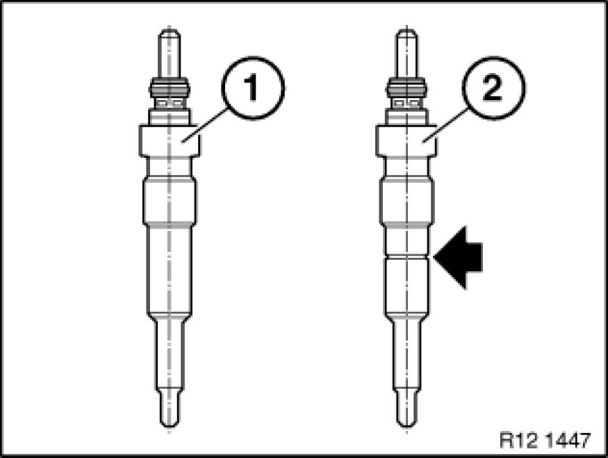

Installation:
Different glow elements in M47 and M47TU engines!
M47 glow elements (1) without designation groove.
M47TU rapid start glow elements (2) with designation groove and silver surface.

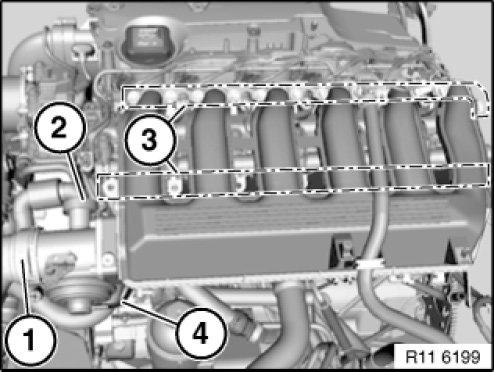

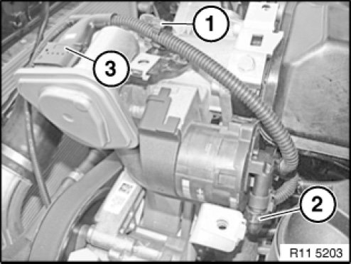

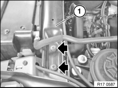

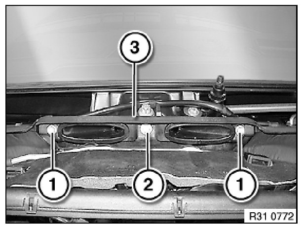

See pic 6
(E7x only)
Unclip Bowden cable for engine compartment lid actuator from transverse reinforcement (1).
Release screws on left and right sides.
Tightening torque 51 71 4AZ.
Remove transverse reinforcement (1).

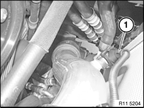

pic 8
Disconnect plug connection (1) on swirl-flap actuator.
Release screw (2) on dipstick.
Disconnect plug connection for pressure sensor (3).
Unclip vacuum line (4) from holder.

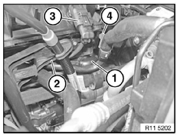

pic 9
Disconnect plug connection (1) on right pressure pipe.
pic 10
Open cable clips (1).
Disconnect plug connection (2) from exhaust-gas recirculation valve.
Disconnect plug connection (3) from electromotive throttle actuator.

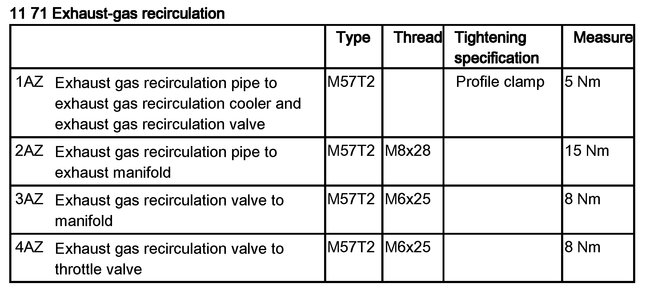

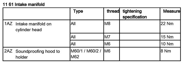

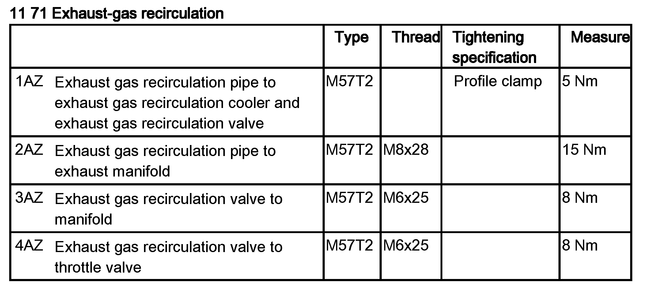

Release profile clamp (2) for exhaust gas recirculation line.Tightening torque 11 71 1AZ.

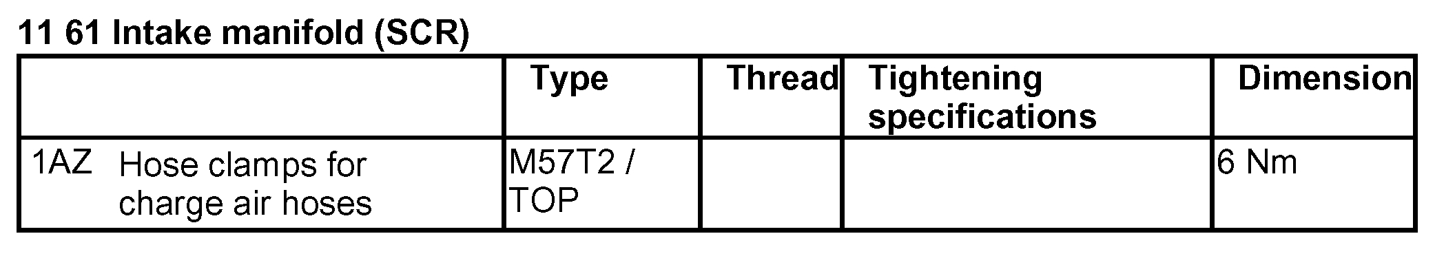

Release screw connection along lines (3).
Tightening torque 11 61 1AZ.
