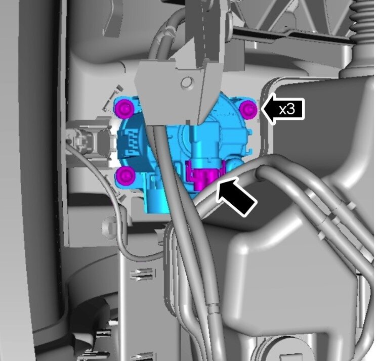

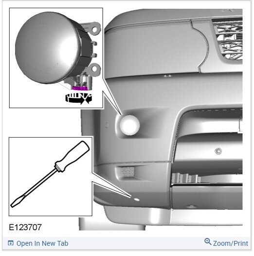

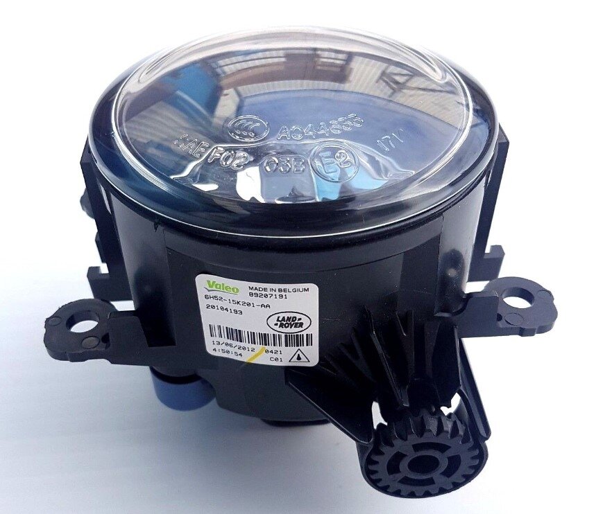

How do I remove the fog light assembly?
2012 LAND ROVER RANGE ROVER SPORT
140,000 MILES • V8 • 4WD • AUTOMATIC
BHAMDOC1973
  • 2,007 POSTS
It is cracked. this is the she sport v8..
May 11, 2023 at 9:39 AM
STEVE W.
  • 15,295 POSTS
Pull off the tire on the side you need access to, then remove the splash shield from inside the fender and now you should see the 3 screws that secure the light to the valance panel.
The same light is used on both sides. Once installed, aim the light with the vehicle level so the beam is 2% below horizontal.
