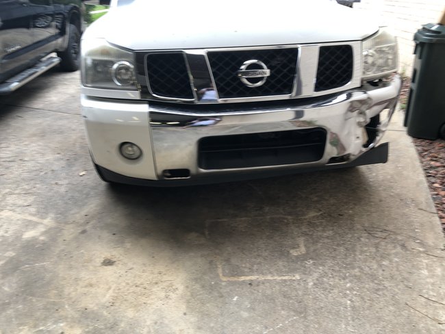

Replacing bumper cover
2007 NISSAN ARMADA
214,000 MILES • V8 • 2WD • AUTOMATIC
NASER NASER
  • 836 POSTS
Front, LE, if any instructions would be great.

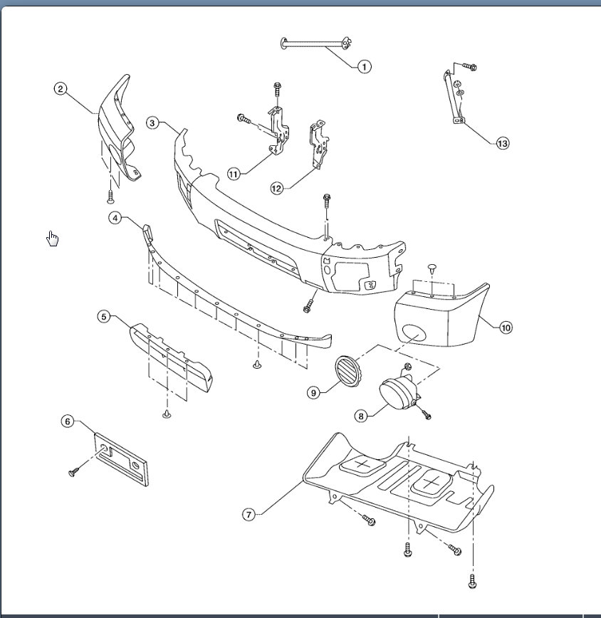

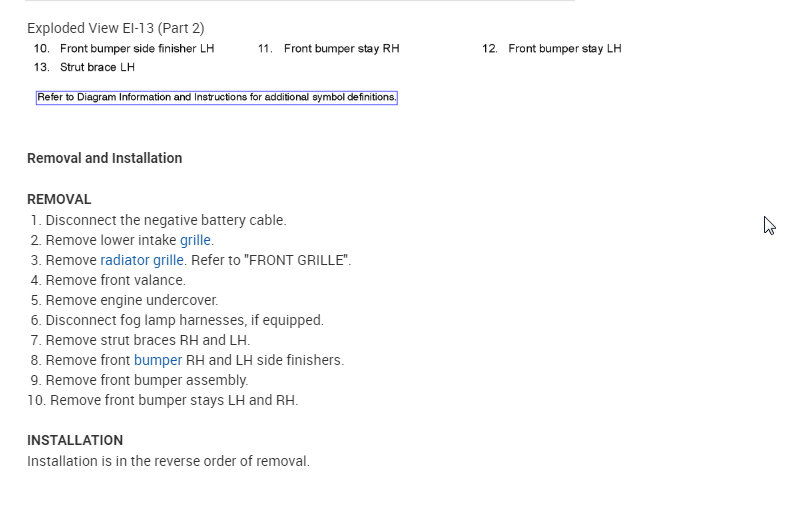

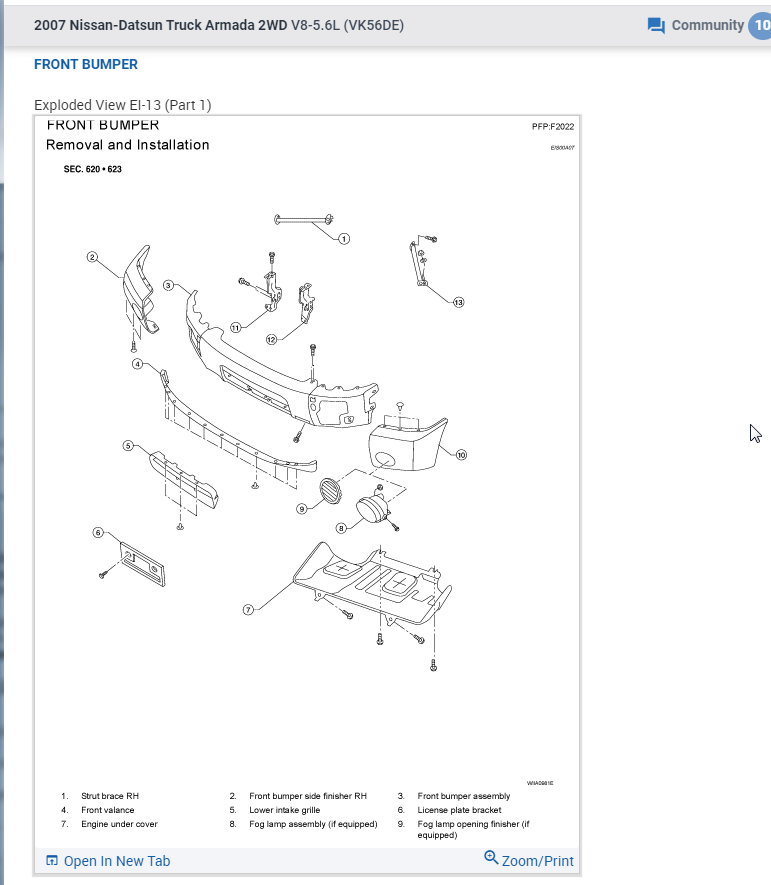

Here are the instructions. They are not detailed at all. I did a quick search online and there are a lot of videos of people taking these off. I didn't attach the link to any because they are pretty rough as they are just people in their driveways. If you need more info let me know and I will see if I can find anything else.
