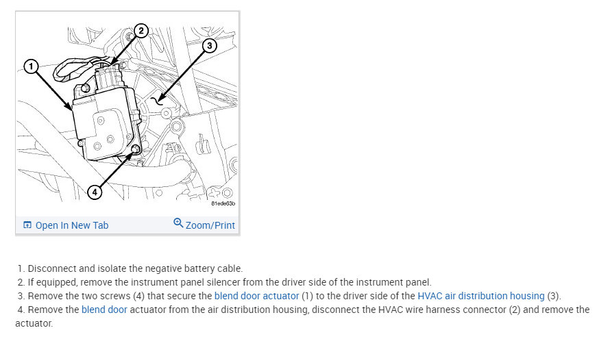

My blend door actuators need to be replaced but how and where would the locations be?

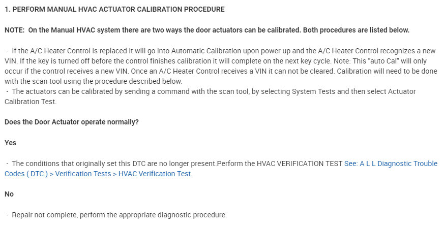

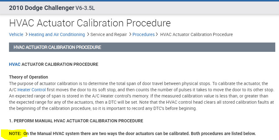

Once replaced do i need a calibration done on them.

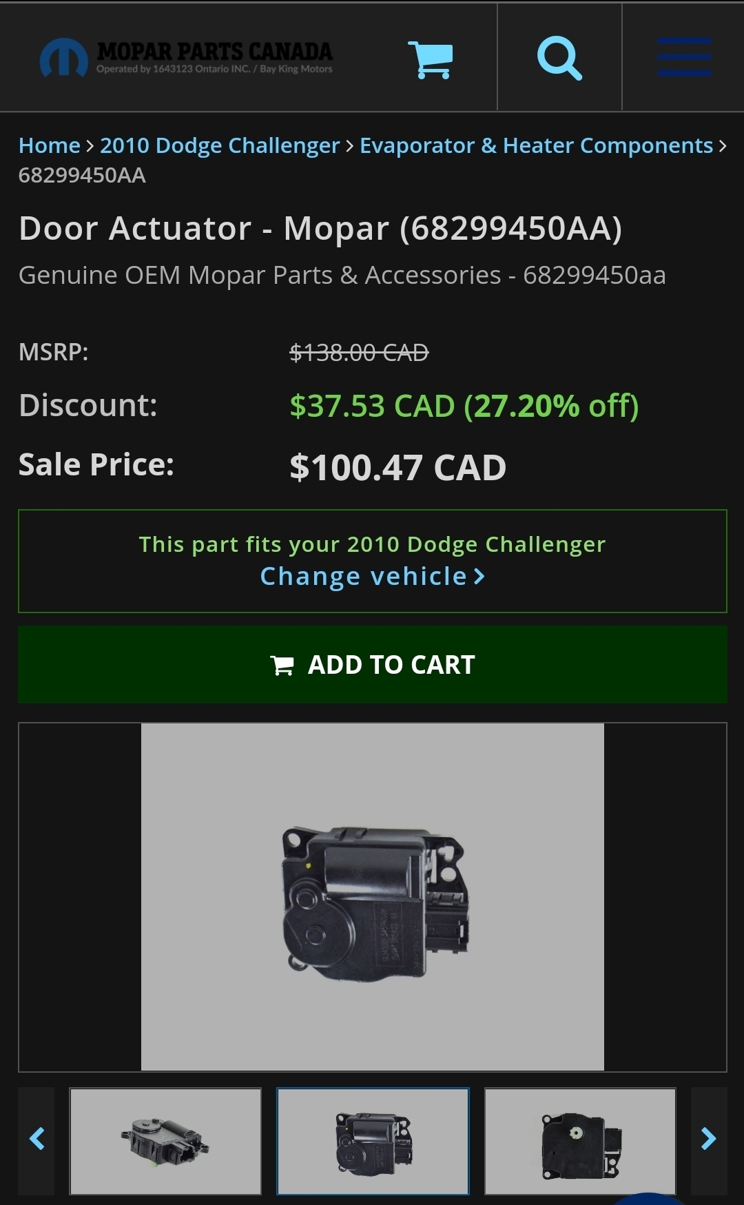

Mopar part number 68299450AA.

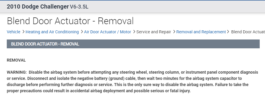

Do you have dual climate control? Everything I'm finding indicates there is one blend air door actuator. You indicated hearing two making noise. What is done to cause the noise or stop it?
Keep in mind, there is a mode door actuator and a fresh air door actuator. One of these could be making noise.

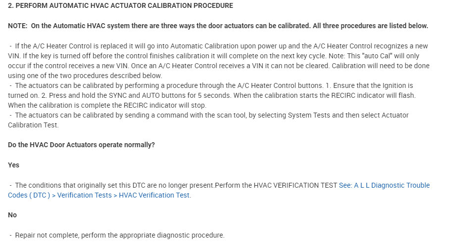

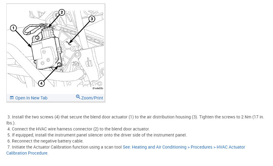

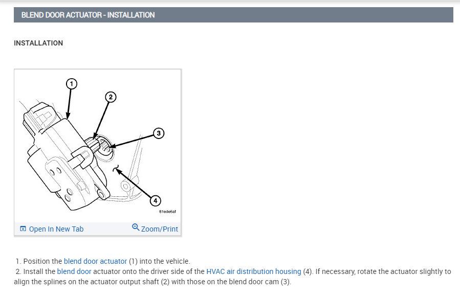

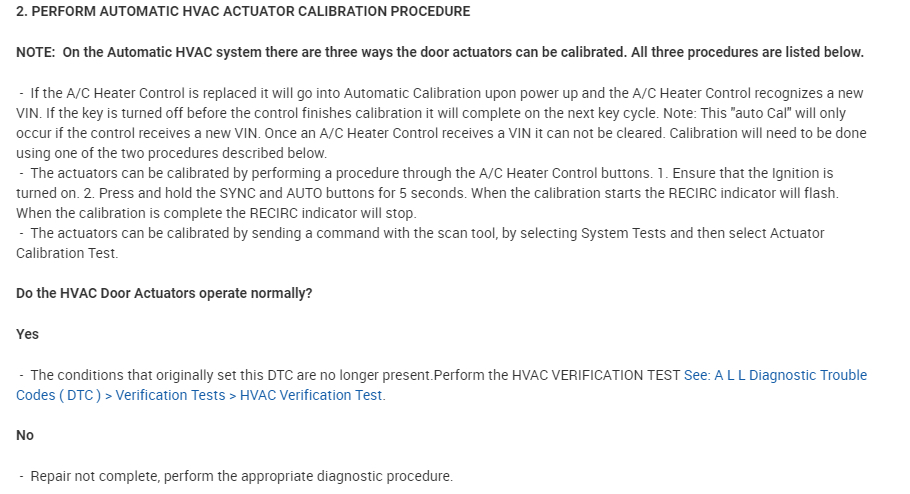

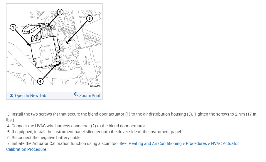

I attached the directions for replacing the blend door actuator below and recalibration. Let me know if that helps. Also, let me know if airflow direction or fresh/recirculate operation is normal.
Let me know if this helps.

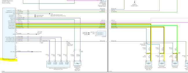

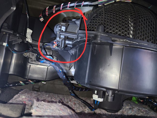

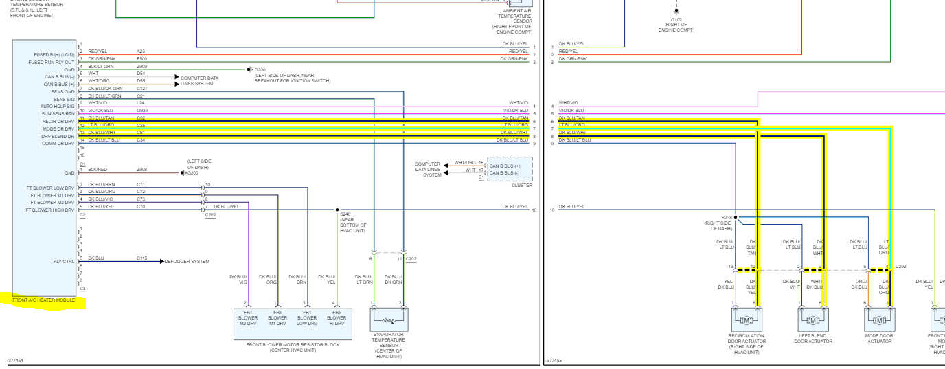

There isn't one fuse that can be removed for each actuator. Power is sent via the front AC/Heater module. If you remove the fuse powering the module, nothing will work. See pic below
Are you able to feel the actuator vibrating when this happens?
Sep 21, 2022 at 3:29 PM

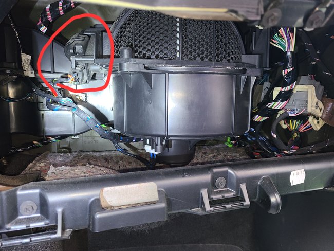

Once the battery is 100% I will hook it back up to the car and check if i can feel the vibration. i ordered two actuators just in case. Today I'll be removing the passenger side panels to locate that actuator and then I'll take apart the driver's side and locate that one as well.
i think only the Blend Door and the Mode door actuator are faulty.

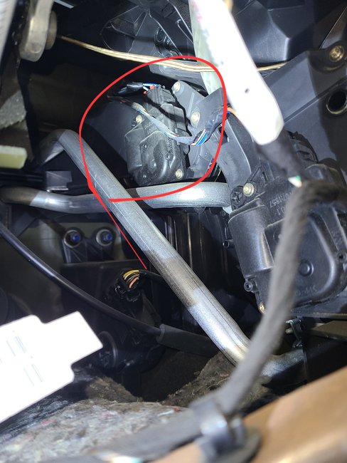

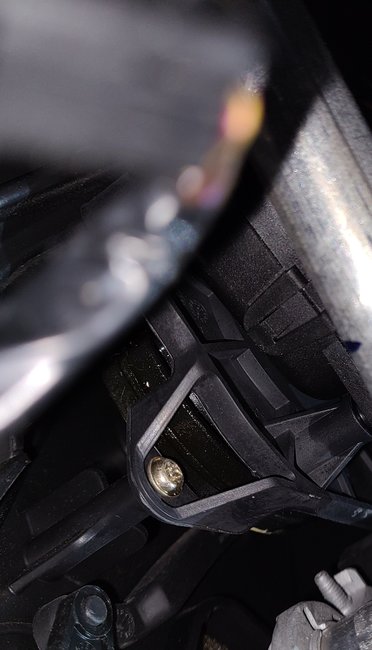

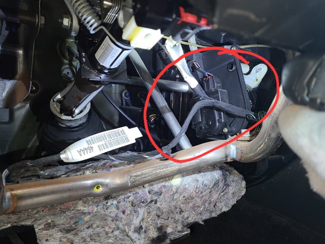

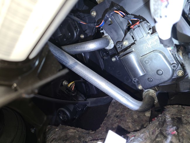

heres a picture of the passenger side actuator. i am hoping to only find 1 on the driver side will post pictures.
Sep 22, 2022 at 10:28 AM
LEMONCAR
  • 36 POSTS

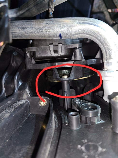

The driver side has two. I'll have to order another actuator.

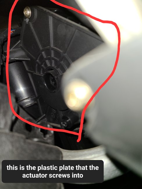

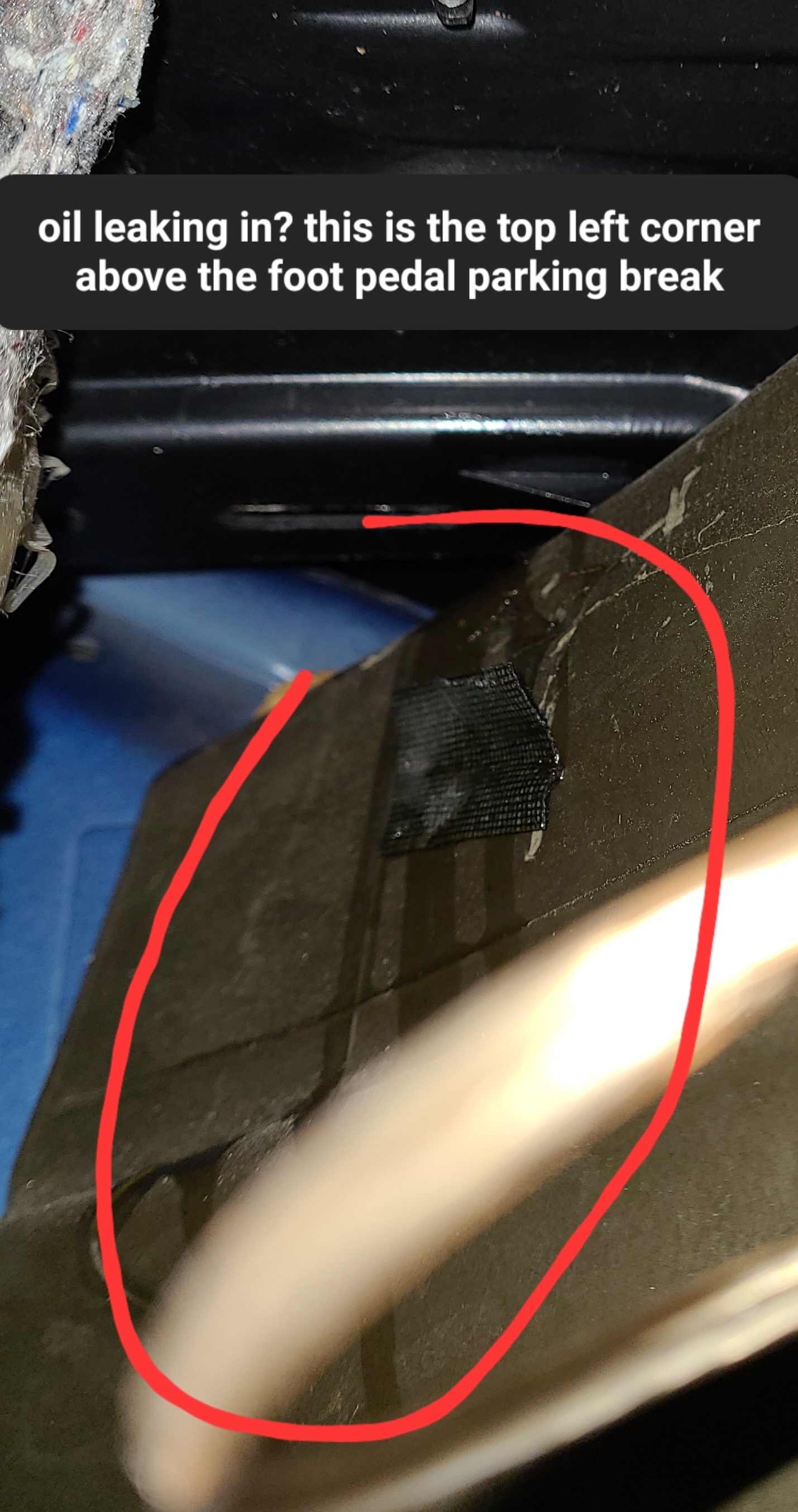

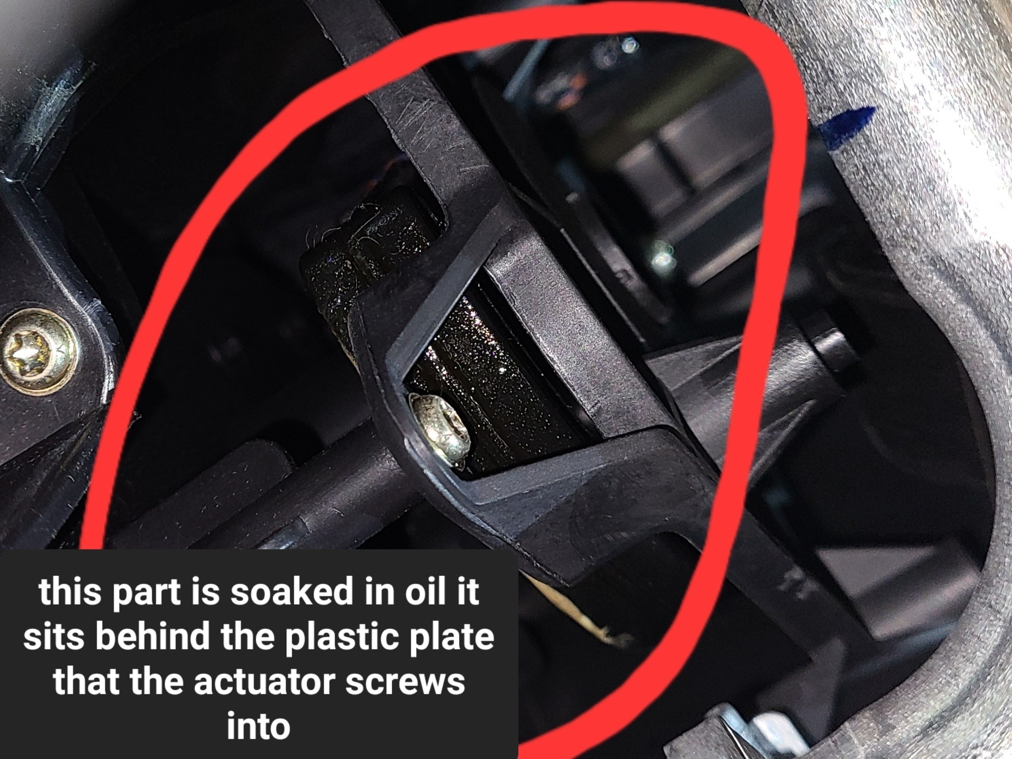

when i was removing the upper actuator on the driver's side i noticed some part that sits behind a plastic plate which the actuator screws into soaked in oil. Also, to the top left corner above the foot pedal parking brake evidence of oil dripping in. hopefully nothing serious and i can take that plastic plate off to get a better look.
Sep 23, 2022 at 1:29 AM
LEMONCAR
  • 36 POSTS

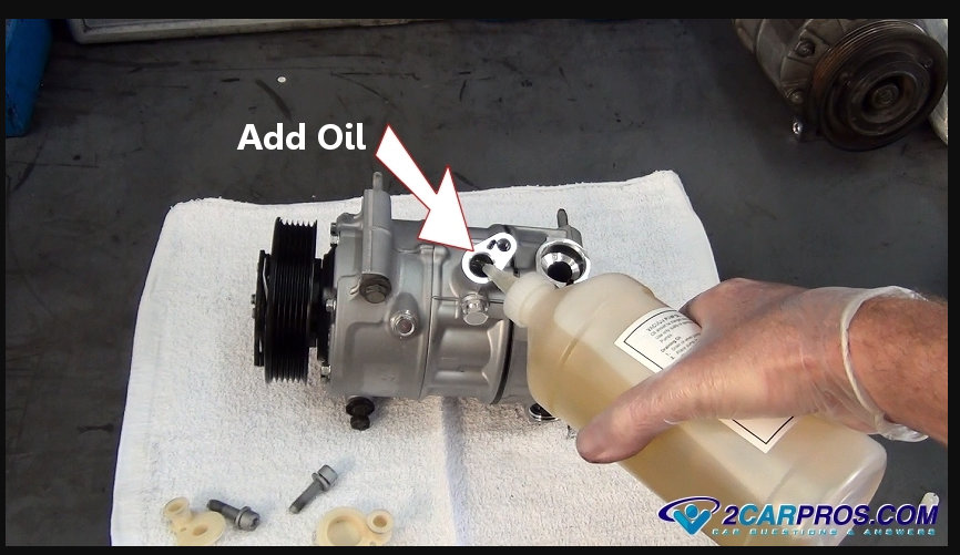

Bad news, that oil leakage is more than likely coming from the A/C compressor. one thing after another with this car. if i let it run dry that compressor is $800.00 (Canadian) and I will be replacing it myself if i can order it to save me some money. how do i fill / top up my a/c compressor oil?
Sep 23, 2022 at 6:48 PM
  • 110,194 POSTS
When you replace the compressor, it should come with oil in it.
The idea that you see oil leads me to think you would also have freon loss as well. Do you have to recharge the system from time to time?
As far as a new compressor, you will add the PAG to it. Though the system has peg oil throughout its internal workings and is usually included in the new compressor it's a good idea to add a slight amount (1/2 ounce) of compressor oil to ensure proper lubrication before installation, then reinstall dust caps. Some units have oil already installed be sure to read the installation instructions for more information that is supplied with the replacement unit.
Let me know. Also, since we don't know how much was lost (which is likely not much) we need to be careful. If too much is added, it will adversely affect the A/C.
