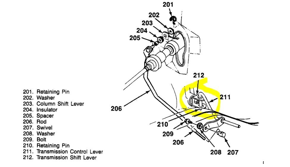

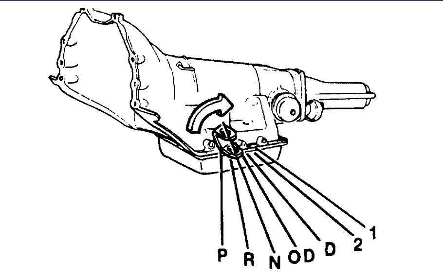

After I replaced the transmission filter and fluid in a 700r4 out of my 1988 heavy half ton I put in my 1993 Chevrolet 2500 which previously had a 4l80e. I’ve gotten the drive shaft and everything bolted up. however, it seems that my shift linkage isn’t lining up and when I crawl under and shift it by hand the truck acts as if my brakes were locked up. And also are the transmission cooler lines routed the same.

You most likely will need to remove the linkage from the original transmission and install it on the donor transmission. Then see if it lines up.
As far as the cooler lines, you will probably need to move them around to line up. There are minor differences for the alignment.

Update: it’s been about six months since the last time I cranked the truck. I just cranked it and it will go into neutral and all forward gears but it won’t find reverse and also I have to pull up on the shifter in order to turn my key all the way off. So if I was to guess, I’d say it was my linkage all along. Just a little awkward to adjust by your self.
Apr 17, 2019 at 7:15 AM
Yes, I agree.
Take your time and adjust it correctly and see if you get all the gears.
Apr 17, 2019 at 7:17 AM
CODY FINNECY
  • 7 POSTS
When I crawl under the truck and shift it manually it won’t go into reverse.
Apr 20, 2019 at 6:04 AM
Got it.
It sounds like you have an internal issue with the transmission.
Sounds like a bad transmission.
