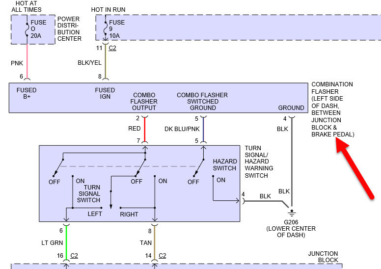

Not flashing or turning on. Need to find the location of the relay to replace it.

see picture for location. it is a combination flasher for both, by brake pedal.
