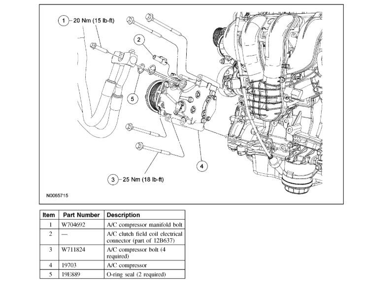

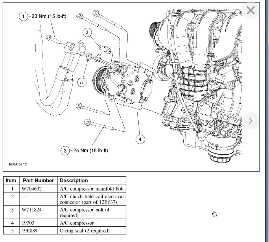

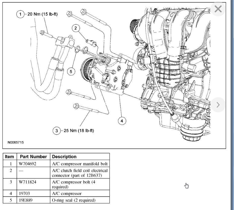

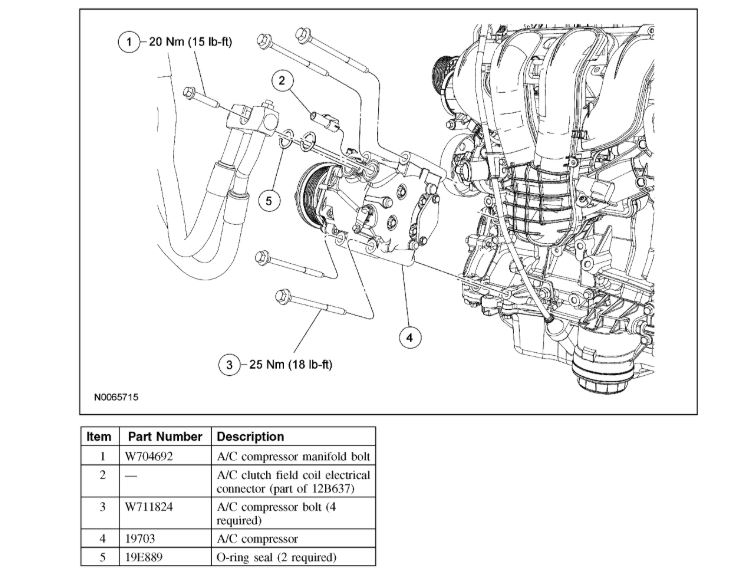

Do you think you can be a little more descriptive as to what the control valve is that you are referring too? I assume you are talking about the compressor clutch?
I put a picture of the compressor to try and figure this out. The issue I am having is we don't have a component that is part of the compressor called the control valve so I am hoping we can figure out the part that you are going for and we will figure this out. Thanks

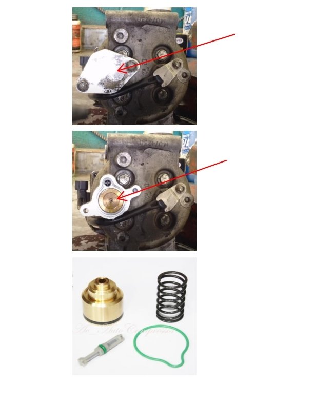

Good afternoon,
I have add pictures, hope shown clearly what valve I mean.

Thanks. Yes, the compressor must be removed for this procedure.
if you are going to do this, make sure you use 1,000 volt gloves to disable the Hybrid system.
https://www.2carpros.com/articles/replace-air-conditioner-compressor
