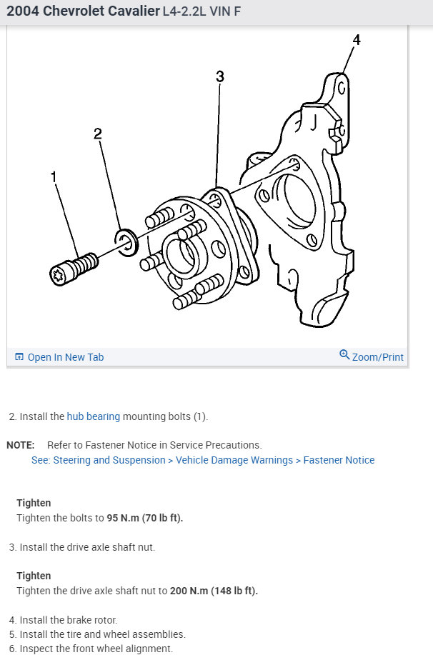

Replacing front wheel bearings what are the tools required?
2003 CHEVROLET CAVALIER
154,000 MILES • 2.2L • 2WD • AUTOMATIC
JLASR77
Aug 6, 2018 at 10:20 AM
SQM
  • 6,383 POSTS

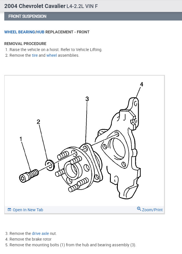

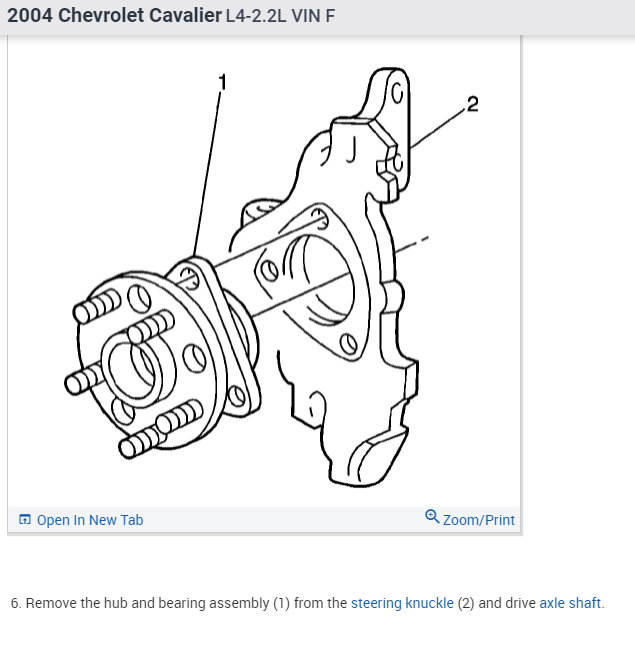

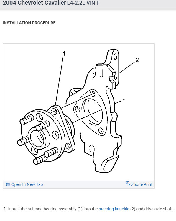

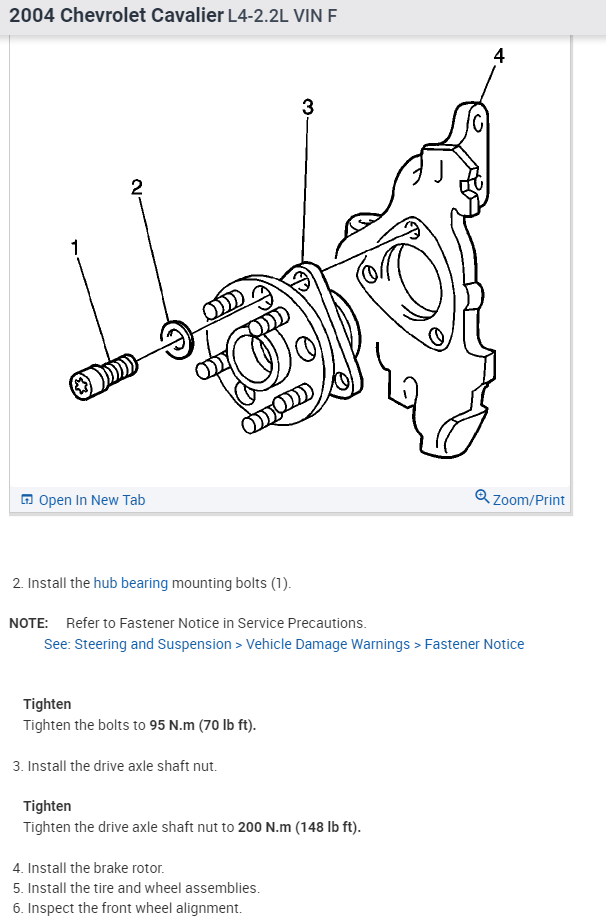

The wheel bearing can be removed with basic hand tools. It will be helpful to have a breaker bar to remove the axle nut as that can be little difficult to remove.
The wheel bearing is mounted with 3 bolts to the hub.
You will need a T-55 Torx bit to remove those bolts.
Here is a helpful guide:
https://www.2carpros.com/articles/bearing-hub-replacement
