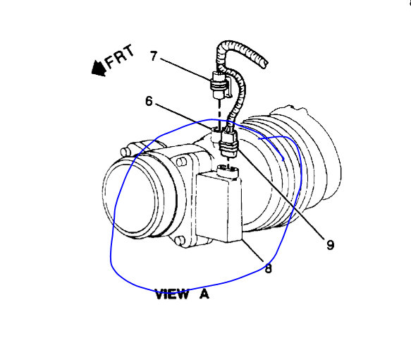

Loss of power when accelerating and loud roaring noise. The heat quit working. It all started after I replaced water pump and fan clutch.

I would go over what you connected and disconnected and make sure you did not leave anything disconnected.
https://www.2carpros.com/articles/engine-has-low-power-output
Check the mass air flow sensor and be sure it is plugged and and tight and secure.
Is the check engine light on?
