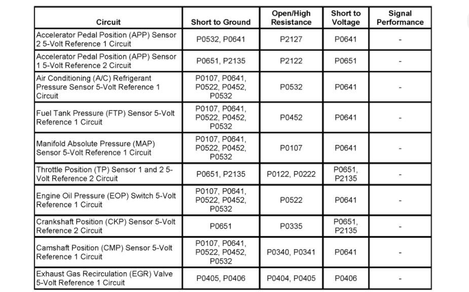

Replaced head gaskets now check engine light and codes P0107, P0641 and P0452
BRITNEYS
  • 2008 CHEVROLET EQUINOX
  • 3.4L
  • V6
  • 2WD
  • 130,000 MILES
Bought the vehicle listed above in February. Heat went out took it back to where I bought it and since then it has had a new radiator, engine coolant sensor, water pump, beater core, thermostat and as of yesterday head gaskets. Took it to a Chevrolet dealer and they found exhaust fumes in coolant. Start the car and check engine light is on and says reduced engine power. It does not drive any different than it did before but is throwing codes p0107, p0641, and p0452.

Okay, 641 is also a five volt reference as well. The sensors are listed that need this voltage. Check them to see if any have reference. This could be a failing PCM.
Circuit/System Description
The engine control module (ECM) has a 5-volt reference buss for each 5-volt reference circuit. The circuits are called 5-volt reference 1 and 5-volt reference 2. Each bus provides a 5-volt reference for more than one sensor. A fault condition on one 5-volt reference circuit will affect the other 5-volt reference circuits connected to that reference bus. The ECM monitors the voltage on the 5-volt reference busses.
The 5-volt reference 1 bus provides 5 volts to the following sensors:

The 5-volt reference 2 bus provides 5 volts to the following sensors:
* The APP sensor 1
* The throttle position (TP) sensor 1 and 2
* The crankshaft position (CKP) sensor

It may be possible to locate the fault by disconnecting one component at a time from the affected 5-volt reference circuit while viewing the 5-Volt Reference circuit status parameter on the scan tool. The scan tool parameter will change from Fault to OK when the source of the fault is disconnected.
If all 5-volt reference components have been disconnected and a fault is still indicated, the fault may exist in the wiring harness.

Okay, the 452 is the same. It is missing the five volt reference.
This voltage is provided by the PCM. There is no fuse for this as well.
