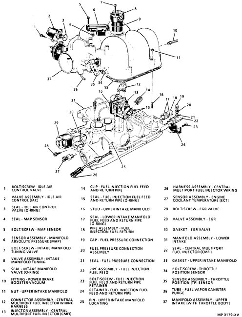

Also, here are the directions for replacing the fuel injectors. Take a look through them and see if you missed anything. Also, make sure things were properly torqued. The torque specs are included in the directions and the attached pics correlate with the directions.

1995 Chevy Truck S10/T10 Blazer 4WD V6-262 4.3L VIN W CPI
Fuel Injector(S) Replacement
Vehicle Powertrain Management Fuel Delivery and Air Induction Fuel Injector Service and Repair Procedures Fuel Injector(S) Replacement
FUEL INJECTOR(S) REPLACEMENT
CMFI Assembly Parts Identification

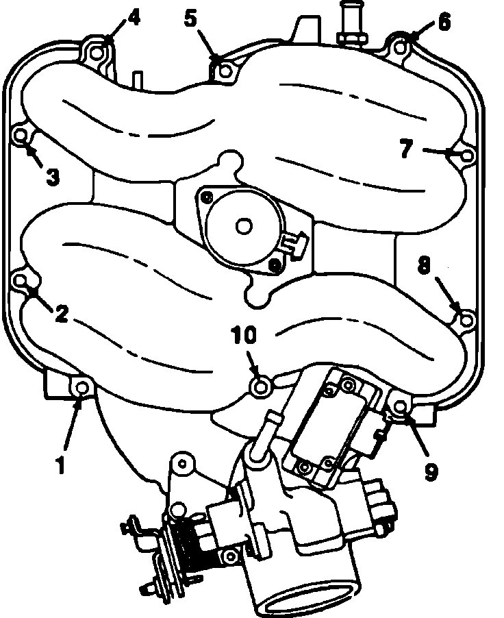

Fig. 9 Upper Intake Manifold Tightening Sequence
REMOVE
1. Negative battery cable
2. Engine cover.
3. Air cleaner box and intake duct.
4. Wire harnesses, including:
- Throttle Position Sensor (TPS).
- Idle Air Control (IAC) motor
- Manifold Absolute Pressure (MAP) sensor.
- Intake manifold tuning valve assembly.
5. Throttle, Throttle Valve (TV) linkage and cruise cable from upper intake manifold.
6. Ignition coil.
7. PCV hose to upper intake manifold.
8. Vacuum hoses at front and rear of upper intake manifold.
9. A/C line at compressor (if equipped).
10. Upper intake manifold bolts and studs.
- Mark the location of all studs for proper reassembly.
11. Upper intake manifold.
NOTE: Do Not attempt to disassemble the Central Port Injection (CPI) assembly, it is serviceable as an assembly.
WARNING: Refer to "Fuel Pressure Relief Procedure," before disconnecting fuel lines.
12. Remove injector wiring harness connector at CPI assembly.
13. Fuel fitting clip and discard.
14. Fuel inlet and return tube and fitting assembly.
- Discard O-ring seals.
15. CPI assembly.
- Squeeze poppet nozzle locking tabs together while lifting nozzle out of casting socket.
- After removing the six poppet nozzles, lift the CPI assembly out of casting.
WARNING: To reduce the risk of fire and personal injury, verify that the poppet nozzles are firmly seated and locked in their casting sockets. An unlocked poppet nozzle could work loose from its socket thus resulting in a fuel leak.

4. Upper intake manifold gasket with green sealing lines facing up.
5. Upper intake manifold.
- Use care not to pinch the injector wires between the upper and lower intake manifolds.
6. Upper intake manifold bolts. Note the marks made at disassembly for proper stud location.
7. Tighten Bolts to 14 Nm (124 in lb) using the sequence shown in image.
