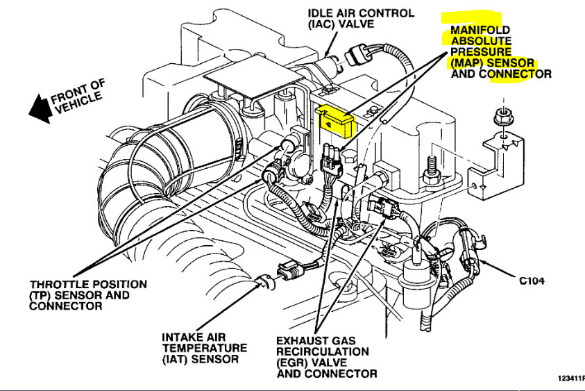

Did this start after the battery/alt were replaced? When you say it takes six tries cycling the switch for it to restart, is the starter not engaging or does the starter engage but the engine just fail to start?
I ask because there are several things that can cause this if it cranks but doesn't start. For example, the manifold absolute pressure sensor (MAP) can be faulty.
The MAP sensor measures the amount of air entering the engine and adjusts the fuel delivery accordingly. If the sensor is malfunctioning, it can cause the engine to start and then die immediately.
That is one theory of a possible cause. By chance, have you had the computer scanned?
Also, I attached a pic below showing the MAP location. Make sure the connector and wiring are in good condition.
See pic below.

Yes, it happened immediately after changing both and you turn the key, and it doesn't crank until the 6-7th try. The MAP sensor wires look good, still not sure where the extra three wire plug goes though that is in with alternator wires harness.

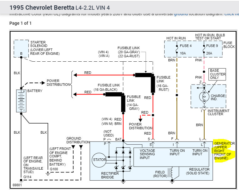

As far as the connector you are seeing, chances are it isn't used on this model vehicle. If you can get a pic of it and upload it so I can see the wire colors, it may help me.
I attached the charging system wiring schematic below. You can check if the wire colors on the connector match what is in the picture.
Now, when you try the 6 times, do you hear clicking? I ask because something as simple as a loose or corroded battery terminal can cause this. I realize the battery was just replaced, but I would suggest double-checking it.
Do that and if possible, upload the wiring you are questioning. Hopefully, I'll recognize it.
Let me know what you find.
See pic below.

Thanks, guys, for your help. I went and bought a new battery and put it in the car. When I first turned the car on no dash lights nothing came on. I turned the key forward twice to try to start it, it made a weird click then I released the ignition switch with it still forward waited one minute dash lights all came on started the car up let it run for 20 minutes it never stalled shut the car off turn the key forward everything came on started the car up no lights on the dash are on car idles runs perfect. Thank you so much oh and the connectors at the starter we're corroded I put baking soda and water on them and now they're all clean car runs like it should.
