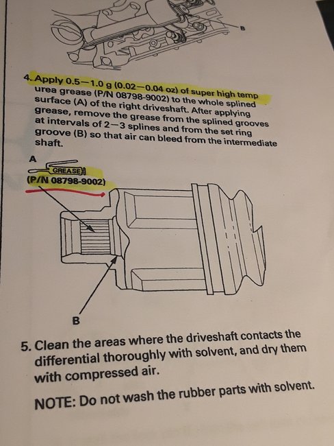

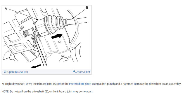

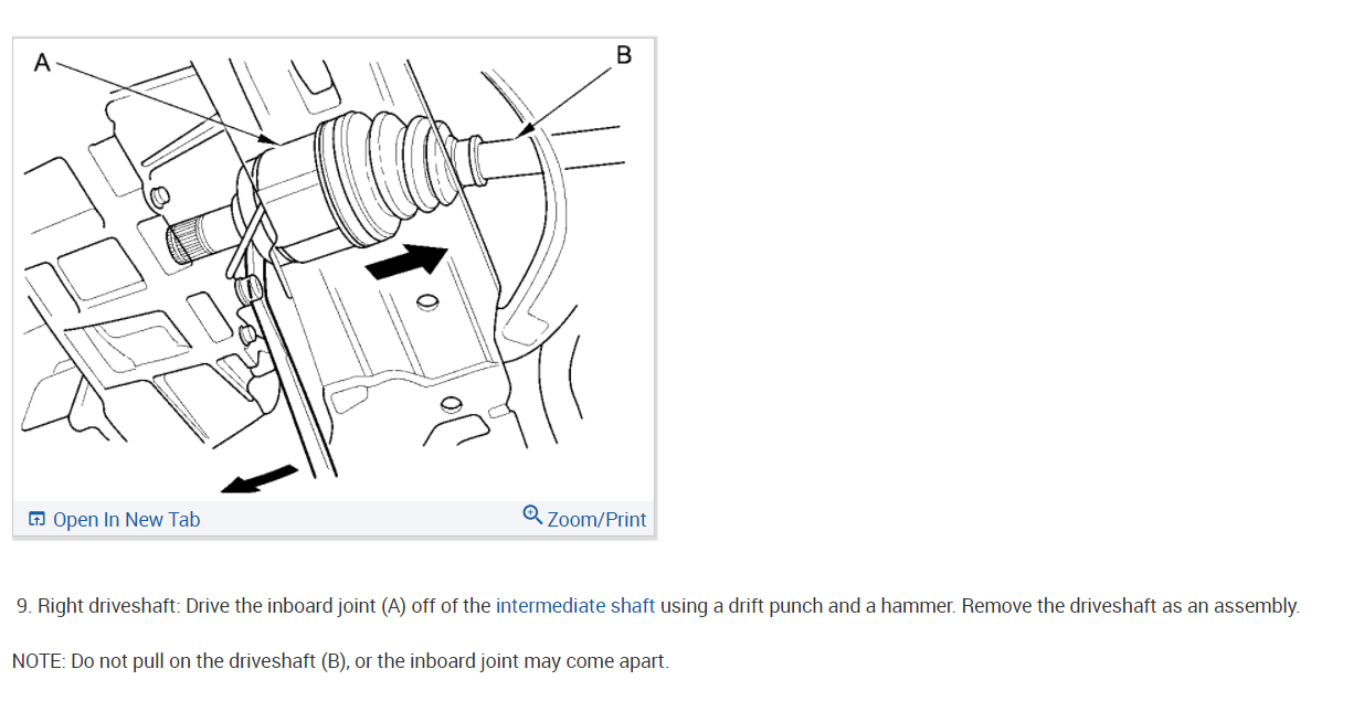

Hey Steve, what part or area do I need to clean in step 5?
Apr 9, 2021 at 6:07 AM
WALL-E
  • 6 POSTS
Image step 5.
Apr 9, 2021 at 6:12 AM

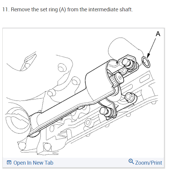

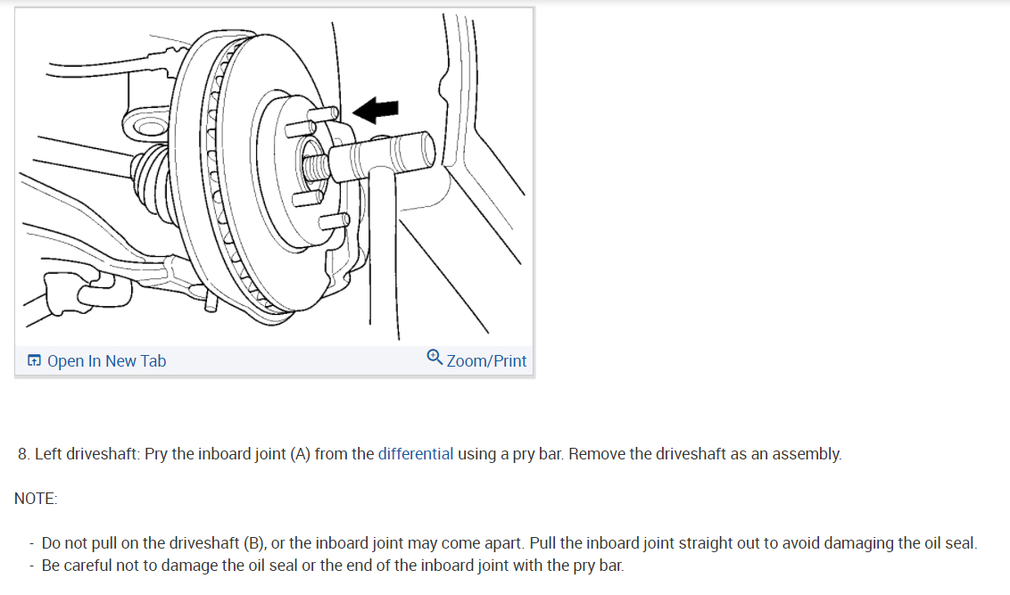

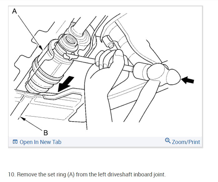

WALL-E
  • 6 POSTS
Sorry, I am trying to understand to figure out what splines get the Urea Grease? I am replacing all five. The two front right and left, and the Intermediate Shaft, and both rears. Step 4 is saying to grease the inside "A" and clean out ever couple groves, and then the most inner part "B" where the set ring mates? Maybe it will all make more sense as I take it apart. Maybe I need to open up the parts and take some pictures?
Apr 9, 2021 at 6:36 AM
STEVE W.
  • 15,318 POSTS
They want all of the inner splines and outer seal areas cleaned then apply new grease inside the splines and a dab where the seals ride. You want them clean so they don't bind or trap junk in the splines in the grease. Then you remove the grease (but leave a thin film) from a few areas so that the air inside the joint can move. If the air gets trapped it will act like a spring and can cause increased wear until it finally escapes. A good way to apply the grease is with a narrow brush like an artists brush. Apply one line in the splines, skip 2 splines and apply another line of grease, repeat until you grease the interior. Be sure to keep it out of the snap ring grooves.
Apr 9, 2021 at 10:52 AM
WALL-E
  • 6 POSTS
sorry, so this is for only the right shaft (inboard) to the intermediate shaft connection. It doesn't say anything about greasing the spline connection to the hub (outboard)? Just to use the moly paste on the bearing and the contact area. I'm trying to upload a pic, but cant get the orientation correct.
Apr 9, 2021 at 12:08 PM
STEVE W.
  • 15,318 POSTS
Yeah, I normally grease all the splines as it makes them all easier to deal with. On the hub ends I always grease those, in the event you will ever need to remove a hub you will thank yourself as the grease will keep water and rust out of those splines.
