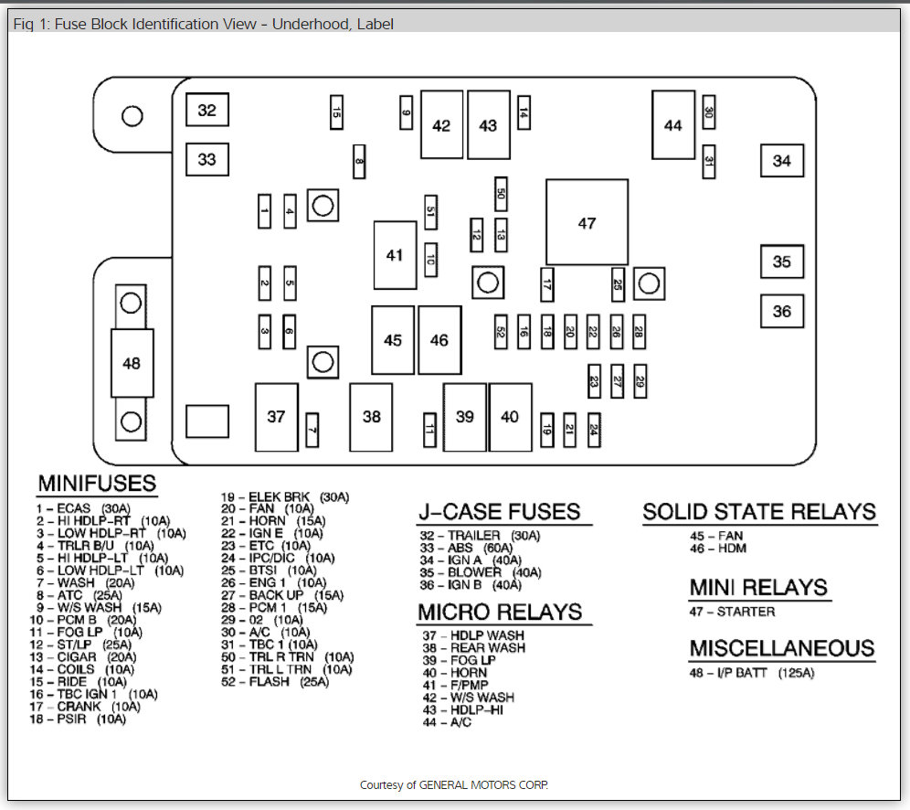

Testing the module in the vehicle is possible but you need a Tech II or equivalent scan tool to cycle the module while watching the inputs and outputs. Testing out of the vehicle requires a specialized test bench that emulates the feedback of the T-case and front axle switch to the TCCM and PCM.
Those are the main reasons why they are expensive to procure.
I am going to assume you already checked the fuses and relays as well as removed and re-seated the connections on the switch and TCCM. The switch not lighting up is indicative of a loss of power/ground more than the TCCM. Those typically give you flashing lights or improper shifts not a dead system.

thanks for all the great information. Steve you mentioned relays did not know about relays where would i find them?

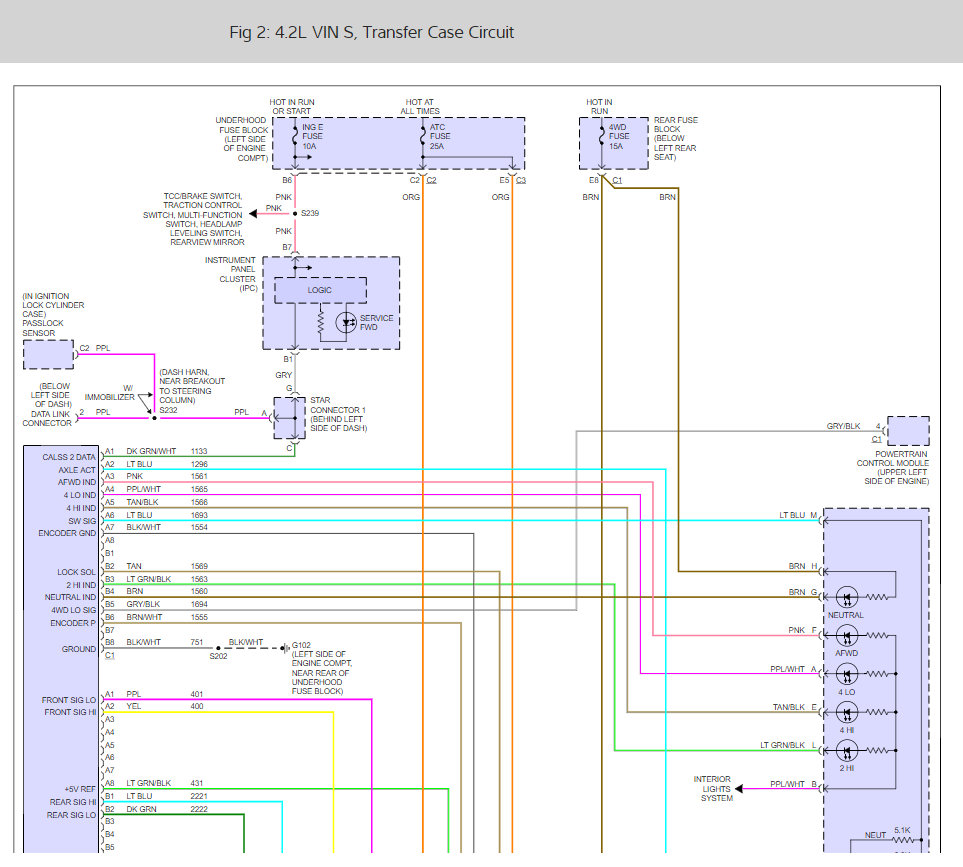

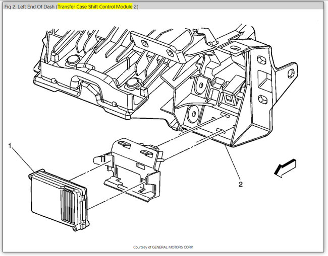

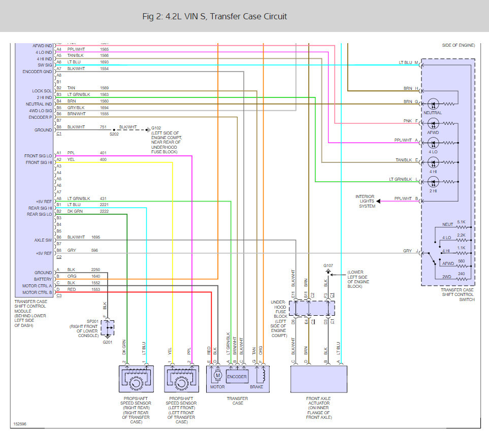

I have found a wiring diagram (below) and a guide to help you do some checks to see if the transfer case controller is getting power and ground. If all checks out I would get a used one and plug it in.
and
Here is the location of the module.
Please run this test and get back to us so we can keep helping you.
