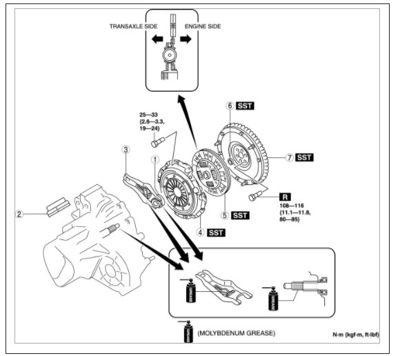

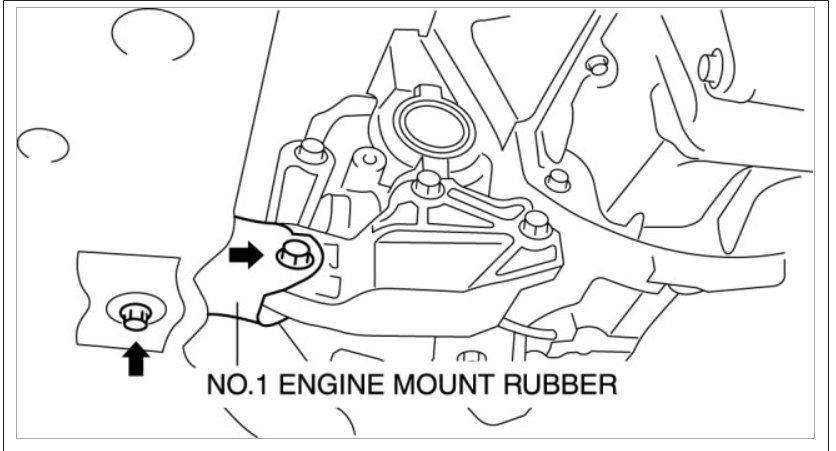

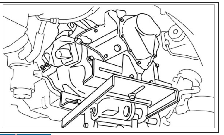

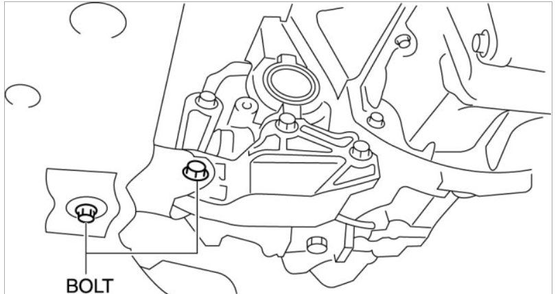

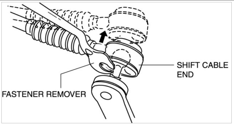

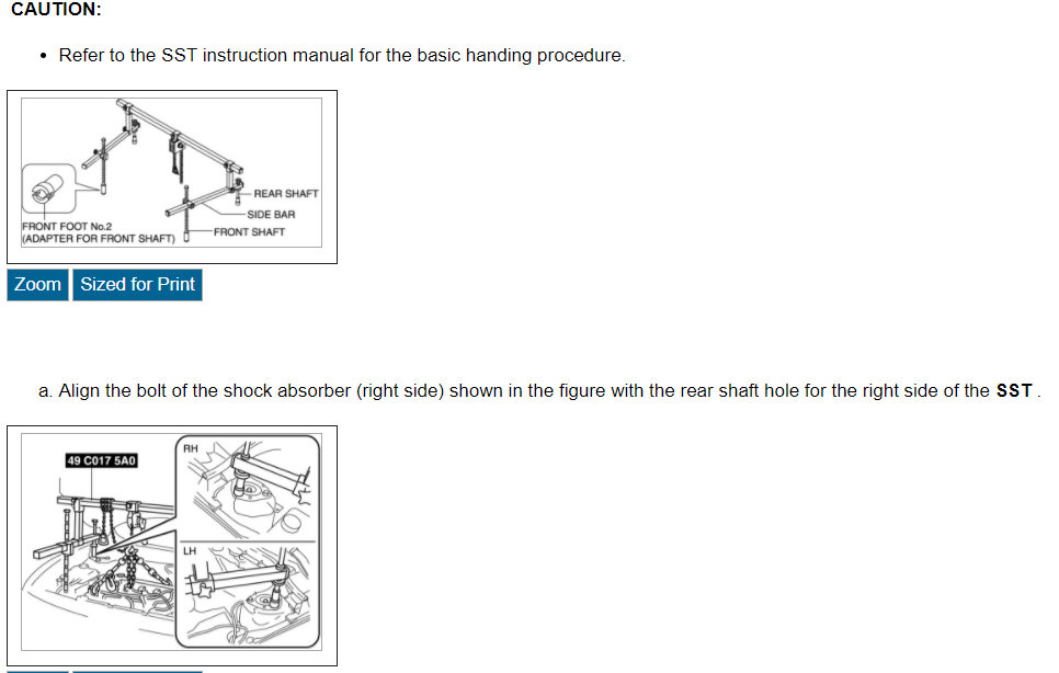

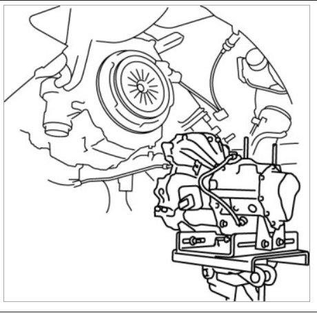

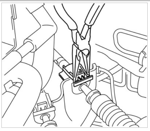

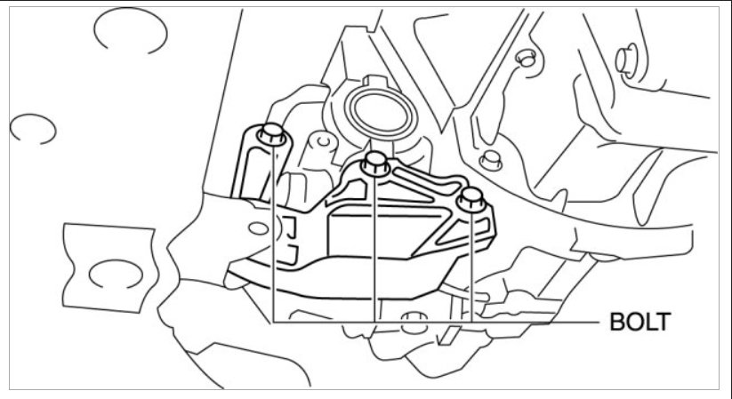

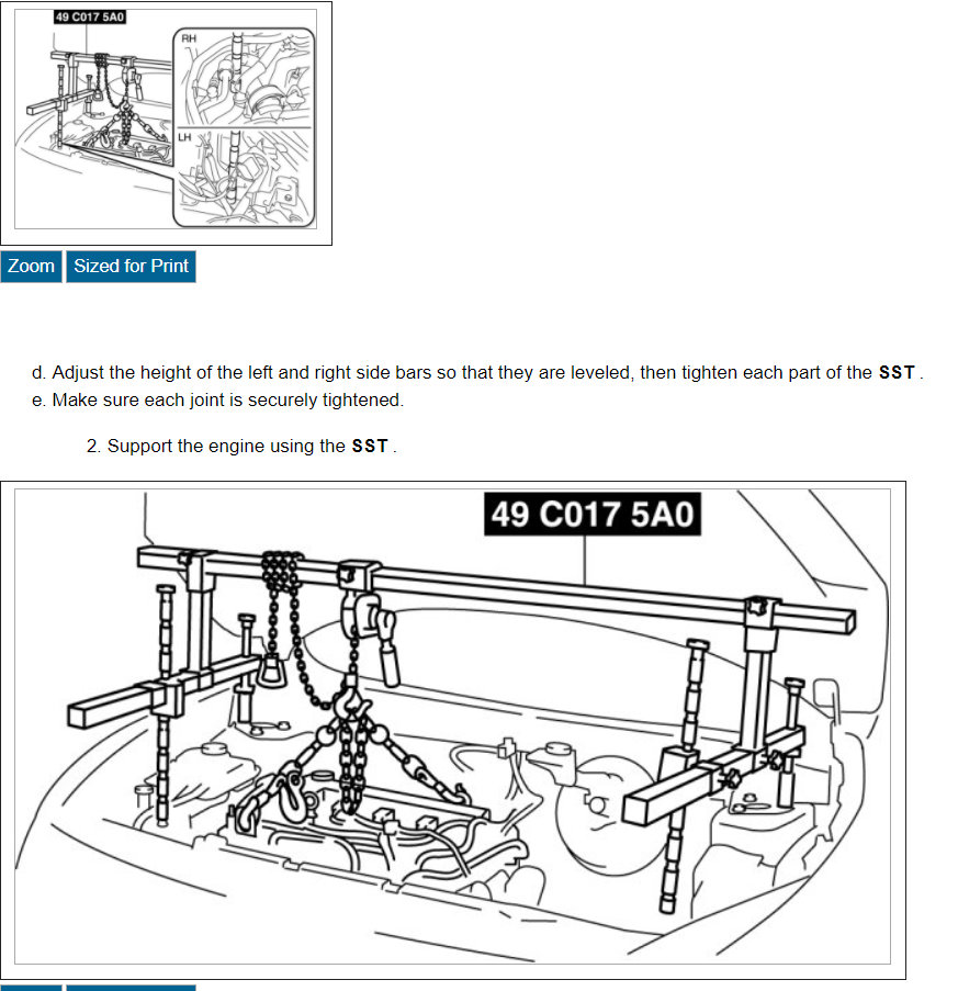

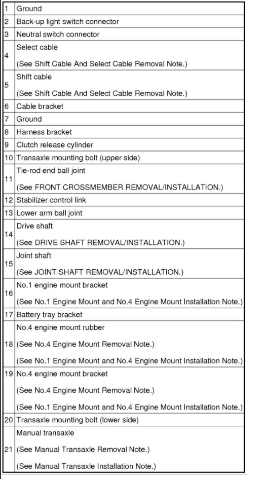

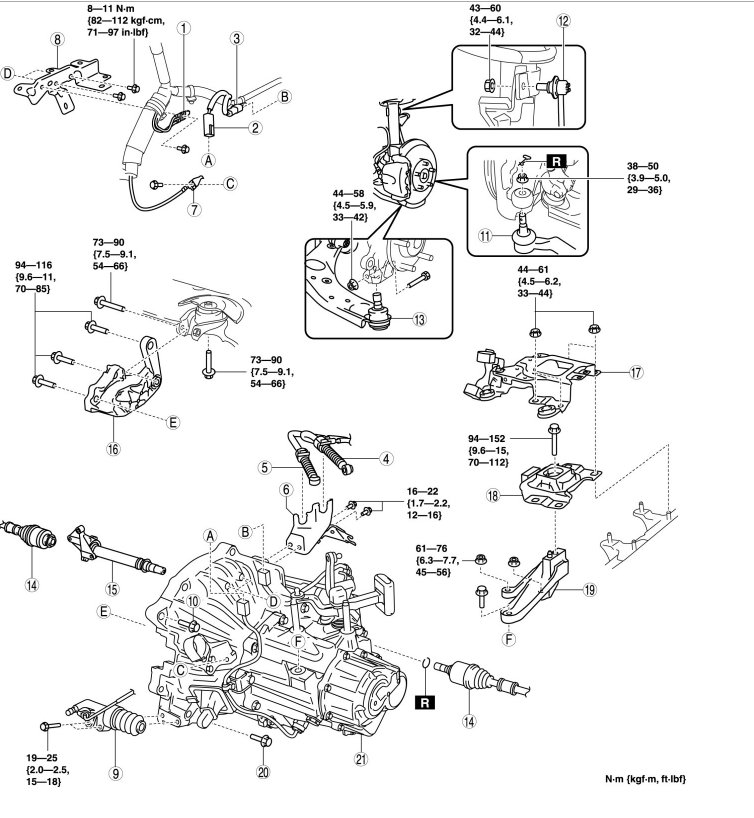

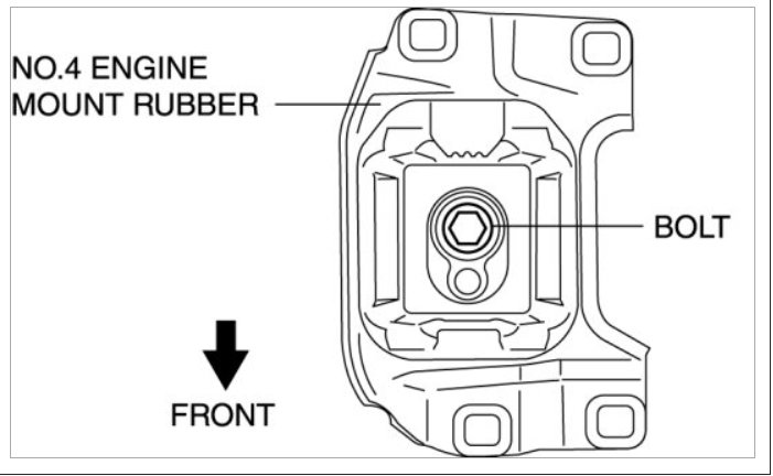

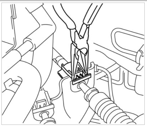

Here are diagrams to help you see how to get the transmission out.
