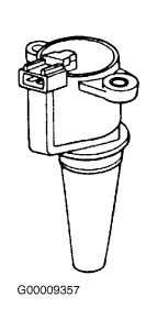

Picked the car up the codes on the coils are df072 df073 df074 df075 does that help

How is the car running now? Our first fault was a "surge" of power now and then. Now you have bad coils or coil pack (which system is fitted?) Is it misfiring? Is it misfiring when hot? The coils going bad would not really give a "surgeing" in acceleration. You would get misfiring and the engine jerking. Kangarooing?

The car is still running poor and having power surges its not misfireing we have coils in our car not coil packs

Do you have single COP (coil on plug) ? if so you need to replace each one .. or check the wiring going to these ? you could also check/clean or replace the CKP (crankshaft position sensor)
https://www.2carpros.com/forum/automotive_pictures/266999_cop_3.jpg

Thankyou for the advice they are single coils on plug and I will try everything you have suggested again thankyou
