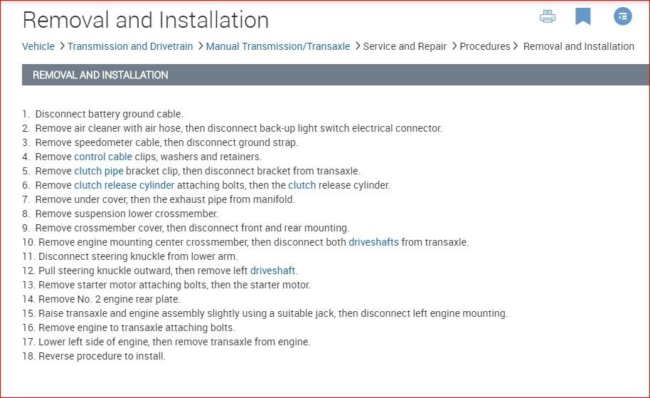

I need help removing my front wheel drive manual transmission.
Apr 25, 2019 at 11:06 PM
Hi Mike,
Here is the procedure from the manual but unfortunately it doesn't give a lot of detail. Give me a little more detail about what you need and I will be happy to try and assist.
