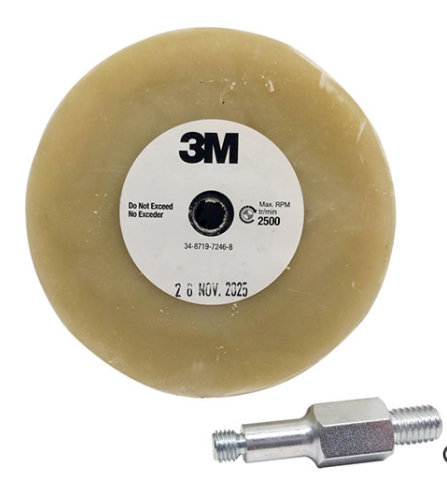

Is it possible to remove my car's taped (with 3M double sided tape that came with it) wind deflectors? My main concern is will it mess up my car's paint and/or leave adhesive behind. I saw from a YouTube video (this one: https://m.youtube.com/watch) that I could just use a hair dryer and then floss to remove the wind deflector. Goo gone or adhesive remover could be used if any adhesive is left.

I remove double stick a lot and my favorite "cutting tool" is braided fishing line. It is stronger than floss and cuts the foam like a razor. That can be an issue though, as you will want to wrap the line around something like a screwdriver handle or dowel rod, do not just try wrapping it around a finger or hand, even with gloves on I have seen it chew through leather before I got smart. As for the glue, you can use a plastic blade to remove as much of the foam as possible, then get a 3M adhesive eraser wheel to remove the rest. Just follow the instructions on the wheel.

DANNY L
  • 5,648 POSTS
Hello, I'm Danny.
I've attached a picture below of the best adhesive remover you can use.This gets rid of double sided tape or any glue or junk sticking to your car.It doesn't ruin paint either and is made by 3M company.Just giving my 2 cents.Hope this helps and thanks again for using 2CarPros.

AARONN
  • 125 POSTS
I successfully got the wind deflectors off. Two were easy to get off, one was okay to get off, and one was hard to get off. I used the hair dryer and goo gone. Floss wasn't working well as it kept breaking. There is no adhesive left behind on my car.
