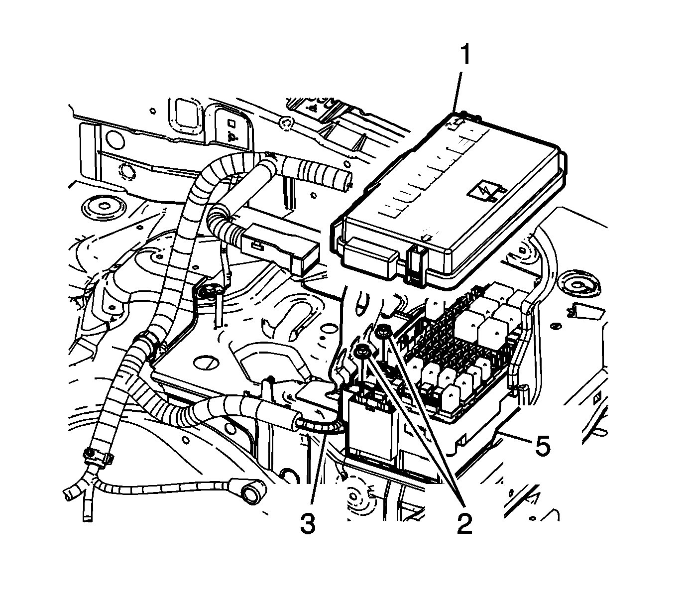

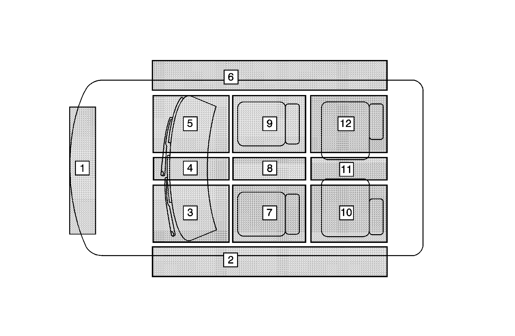

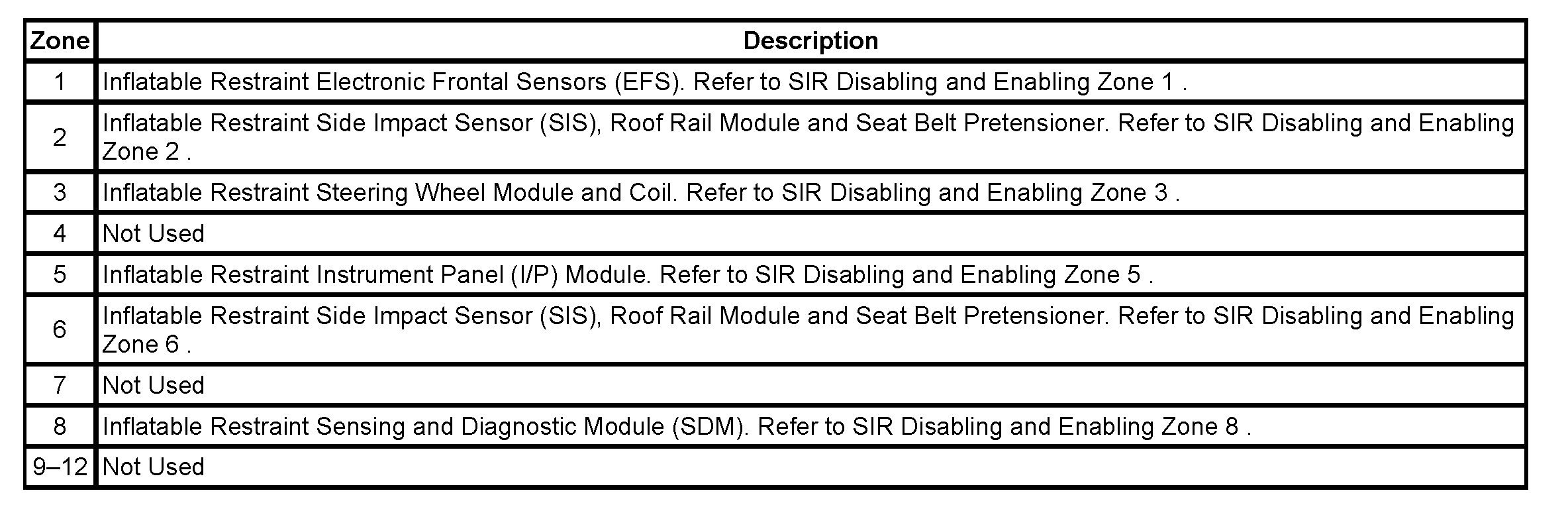

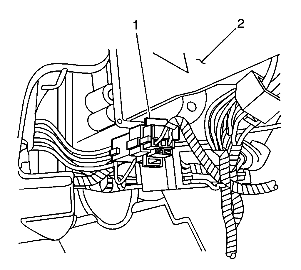

You are correct. Zone 3 needs turned off/disabled when doing the repair. Here are the directions for disabling zone 3 (steering wheel). Picture 1 shows zones, picture 2 zone locations,
SIR DISABLING AND ENABLING ZONE 3
DISABLING PROCEDURE
1. Turn the steering wheel until the vehicles wheels are pointing straight ahead.
IMPORTANT: Refer to SIR Disabling and Enabling Zones before disabling the SIR system.
2. Turn OFF the ignition.
3. Remove the key from the ignition.

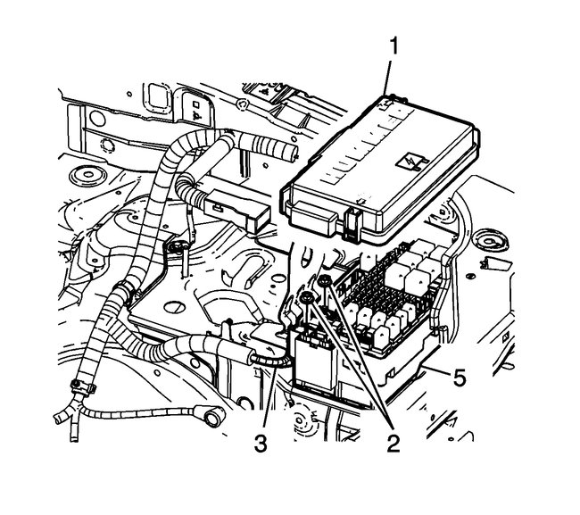

4. Remove the trim panel.
(pic 3)
5. Remove the Air Bags fuse from the fuse block (5) located in the underhood fuse block.
IMPORTANT: With the Air Bags fuse removed and the ignition ON, the AIR BAG indicator illuminates. This is normal operation and does not indicate an SIR system malfunction.
(pic 4)
6. Remove the connector position assurance (CPA) (1) from the steering wheel module yellow 4-way connector (2) located left of the steering column above the left hinge pillar trim panel.
7. Disconnect the steering wheel module yellow 4-way connector (2) located left of the steering column above the left hinge pillar trim panel.

2. Connect the steering wheel module yellow 4-way connector (2) located left of the steering column above the left hinge pillar trim panel.
3. Install the CPA (1) to the steering wheel module yellow 4-way connector (2) located left of the steering column above the left hinge pillar trim panel.

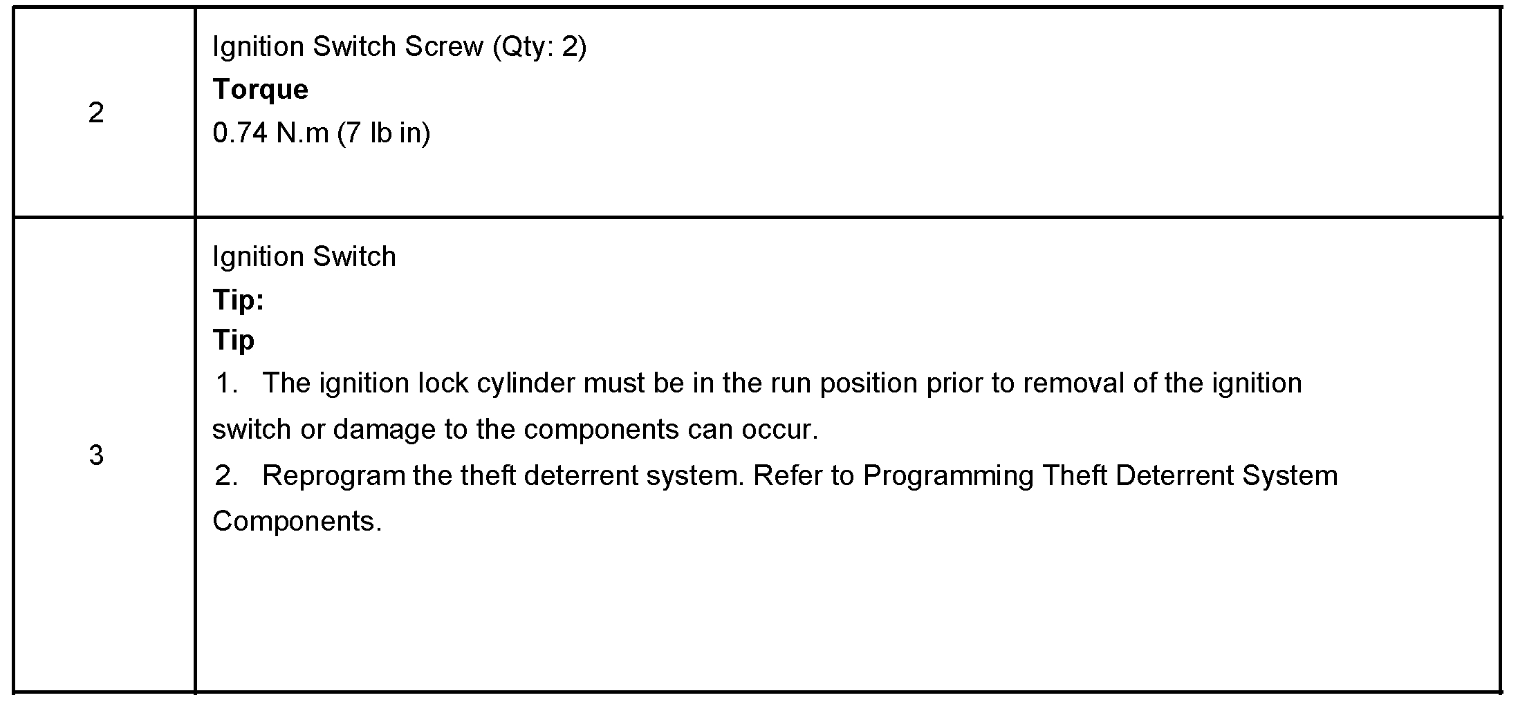

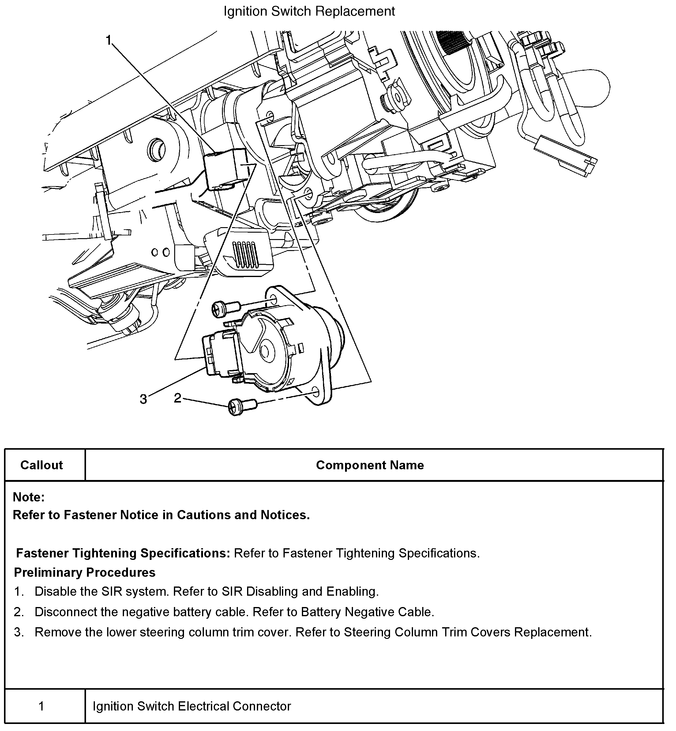

Now for the switch directions. In my manual, they are shown in picture form. Therefore, I have attached the directions in pictures 7 and 8. If you are unable to read them, let me know and I'll help you through them.
Note that step 2 says to disconnect the battery.

# 4. Remove the trim panel. Is that referring to the fuse box cover under the hood? (that is what the picture looks like) or the steering wheel cover?
