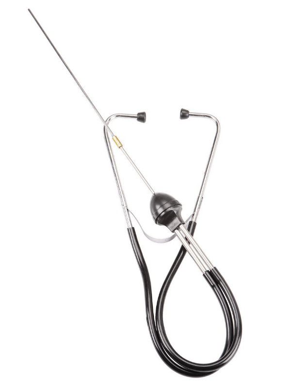

One way to determine where the noise is coming from is to use an automotive stethoscope (see picture below) and put it on the hub/shaft of the pulley when the engine is running. This can make it easier to determine the source.

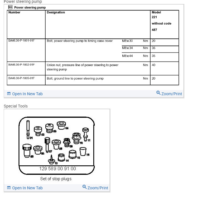

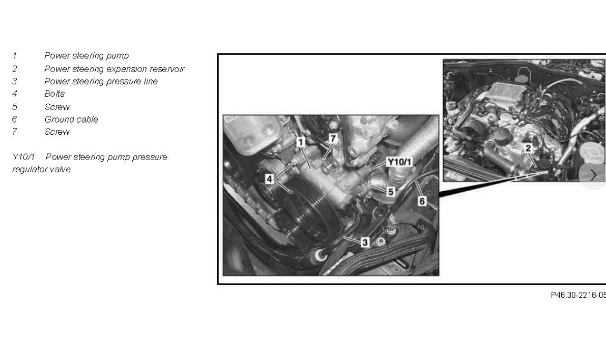

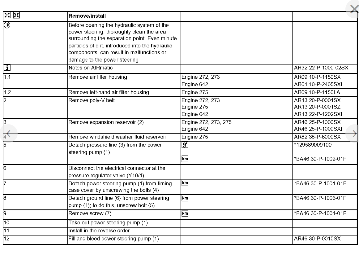

I have attached the power steering pump replacement procedure below for your reference.
Let me know of any questions.
https://www.2carpros.com/articles/how-to-replace-a-power-steering-pump
