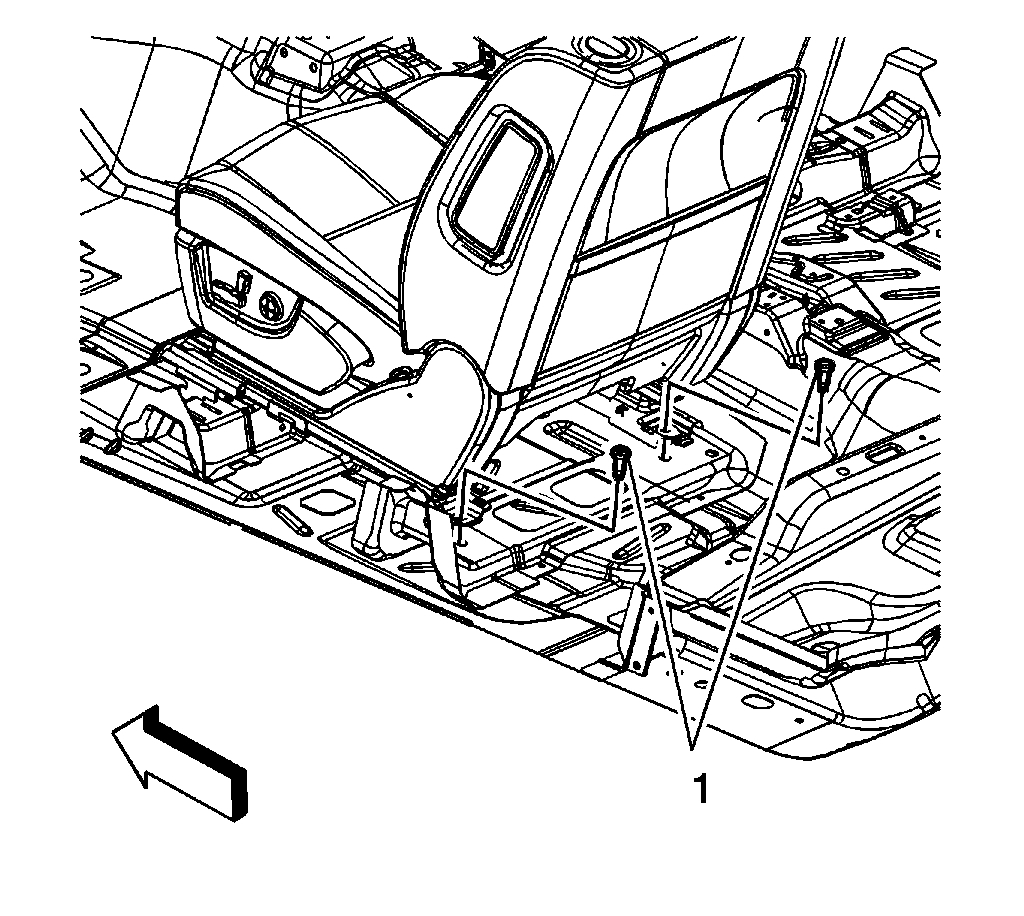

I am trying to remove the front driver seat from the car listed above and have removed the two rear bolts. The seat seems to be free on the outside but the inside of the seat seems to be connected to something. The seat can tip forward but will not pull back.

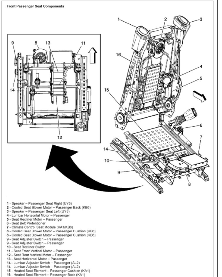

There are probably two bolts on the front of the seat as well. Slide the seat all the way back and look you might need to pull the carpet back and there might be a bolt coming up from under the car here is a diagram of the front of the seat.

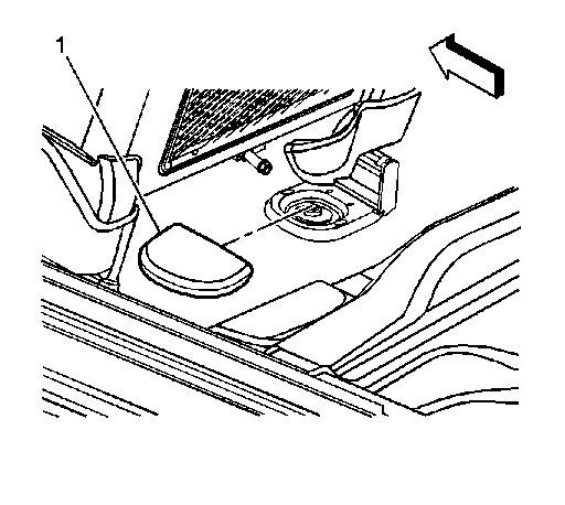

2. Move the front seat forward in order to access the front seat track trim cover (1).
3. Remove the seat track trim cover (1) from the seat track.

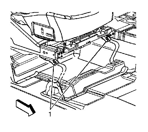

4. Remove the seat track fasteners from the seat track.

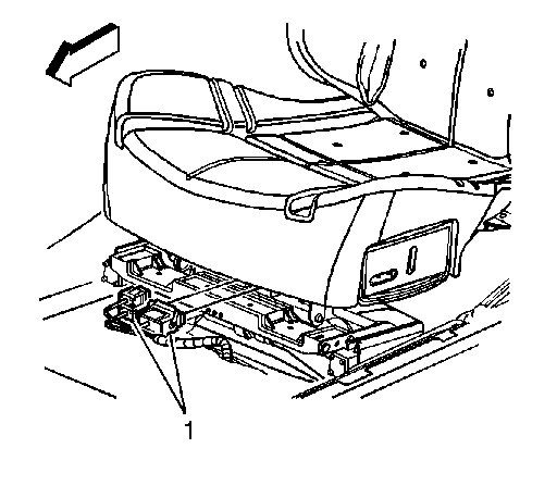

5. Disconnect the seat electrical connectors (1).
6. With the aid of an assistant, remove the seat from the vehicle.

2. Insert the front tabs (1) on the seat track into the floor.
pic 5
3. Connect the electrical connectors (1).
pic 6

4. Install the seat track fasteners.
Tighten the seat track fasteners to 30 N.m (22 lb ft).

5. Install the seat track trim covers (1).

her are two bolts under trim covers at rear only. The front disengages when the rear is lifted and pulled rearward. You may have to recline the seatback to get enough lift to disengage the front. The seat is very heavy on this vehicle, you may choose just to leave it in the car and tilt it back.
