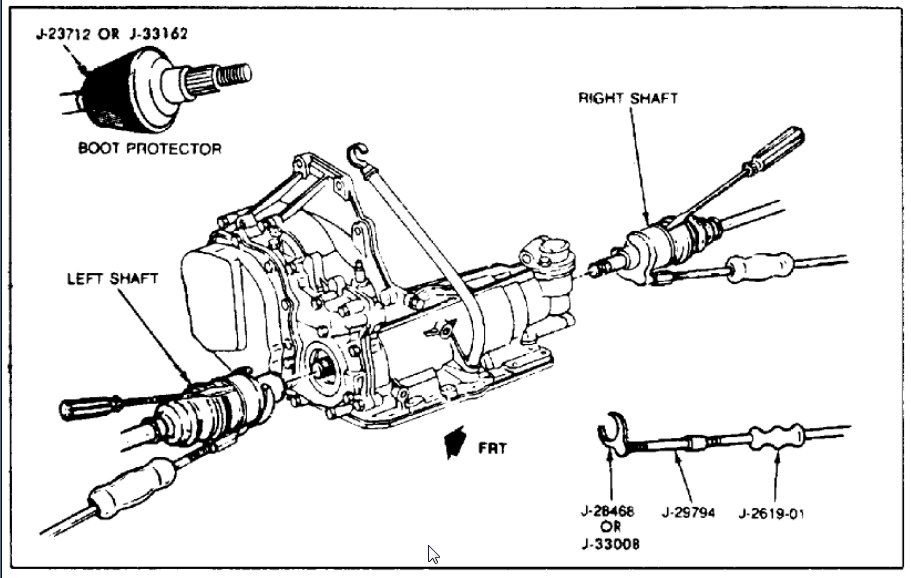

I'm trying to remove the CV axle because I need to replace the seal in the transmission. I've just put this axle in and now it's leaking fluid.
I can't get the axle out. I've tried different sized pry bars. I need to save the axle to reuse, I've just bought it and I have less than $20.00 left in my bank account. And the axle is brand new so it isn't something I can just tear up and get a new one and I can't buy anymore tools, there's no money.
Any suggestions?
Mar 11, 2021 at 8:01 AM

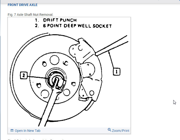

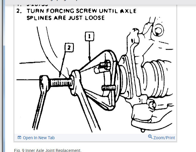

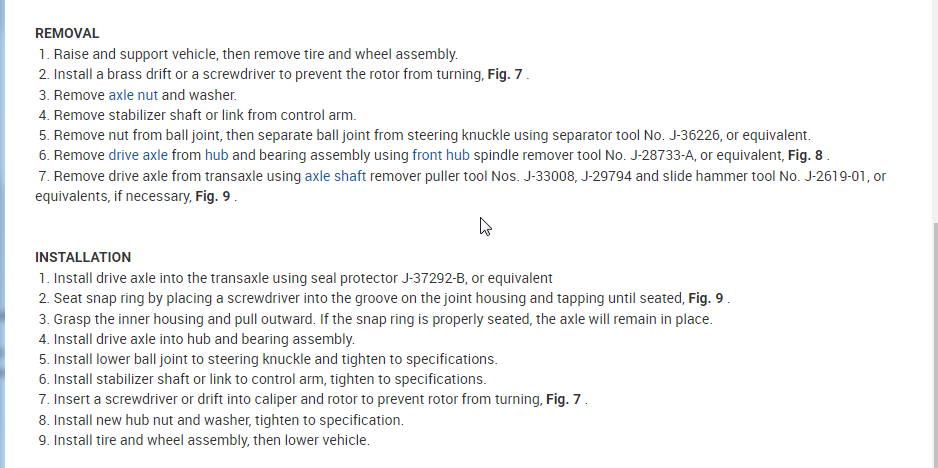

You need to use a slide hammer. I attached the process below that has the special tool numbers that you can try and find to get the correct attachments but any angle bracket attachment that will hook the axle will work.
You can probably rent then or if you have an AutoZone, most of them have free tool rental programs. Basically they charge you for the tool but when you return it they give your money back.
Let me know if you still have questions on this.
