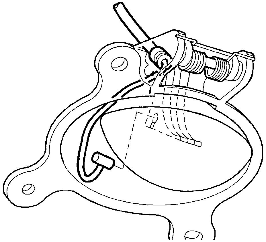

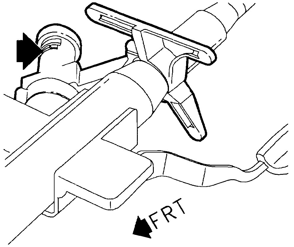

I cant find any little buttons on the housing to unlock it!! I am trying to remove the tumbler that the key goes into and i can't figure out how to do it. All i can see is two little bolts on the end of it. Any suggestions?
Jul 14, 2019 at 10:45 AM
  • 110,248 POSTS
Welcome to 2CarPros.
Here are the directions for removal and replacement of the ignition lock cylinder. The attached pictures correlate with the directions,
________________________
IGNITION LOCK CYLINDER - REMOVAL
1. Disable the SIR system. (Refer to Disabling the SIR System in Diagrams/Diagnostic Aids/General Troubleshooting Procedures/The SIR System.) See: Vehicle > Diagnostic Aids
Ignition Switch: Removal
pic 1

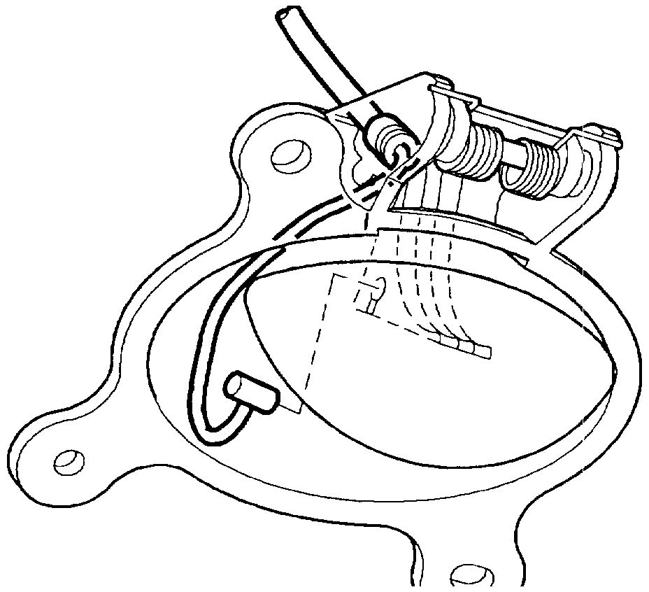

2. Remove two screws holding Data Link Connector (DLC) to filler panels.
3. Remove the five steering column filler panel screws.
pic 2

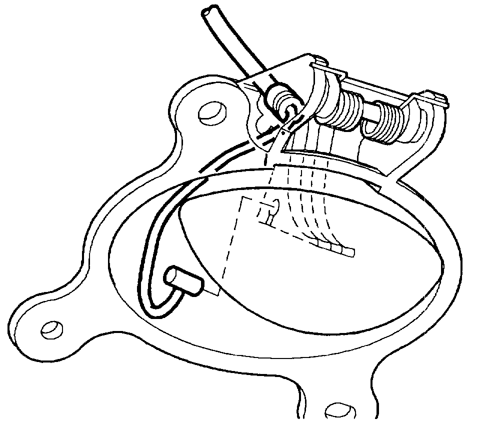

4. Remove hood release cable from lever by releasing cable housing, then rotating cable downward to cutout.
5. Remove steering column filler panel.

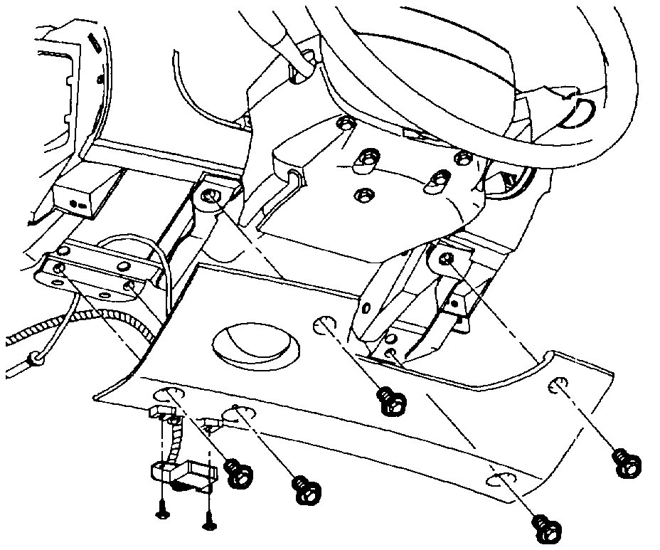

pic 3
6. Remove two upper-to-lower steering column shroud screws and three lower steering column shroud-to-steering column screws.
7. Remove upper steering column shroud.
8. Insert ignition key into ignition lock cylinder and rotate ignition key to ACC position.
pic 4
9. Depress the square locking button on the top of the ignition lock cylinder module and slide ignition lock cylinder assembly from ignition lock cylinder.

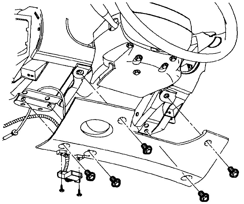

1. Position new ignition and start switch (P/N 21024682) to ignition module assembly and install two screws and tighten.
Torque: 2 - 3 Nm (18 - 27 in.lbs.)
2. Connect electrical connector to ignition and start switch.
Ignition Switch: Installation

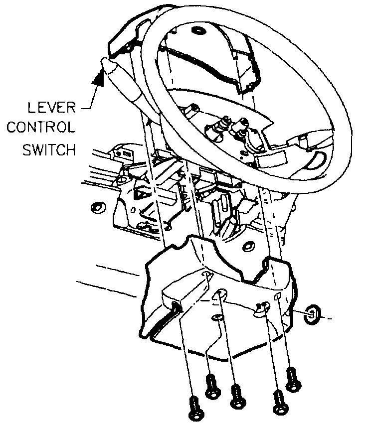

3. Position upper and lower steering column shrouds to steering column and install two upper-to-lower steering column shroud screws and three lower steering column shroud-to-steering column screws.
4. Install ignition lock cylinder into ignition module.
pic 6
