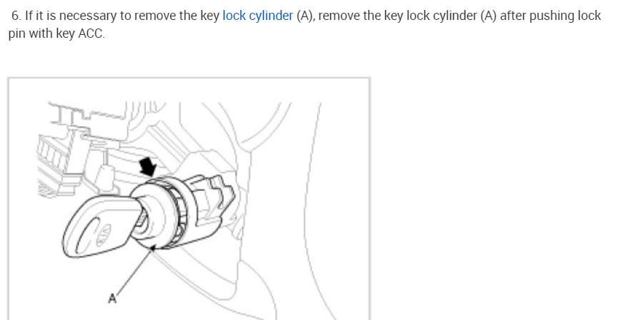

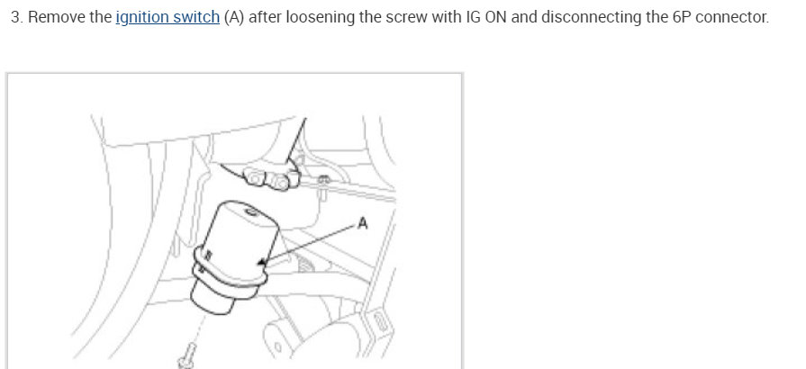

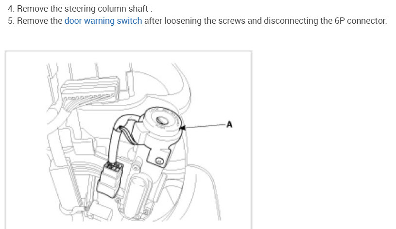

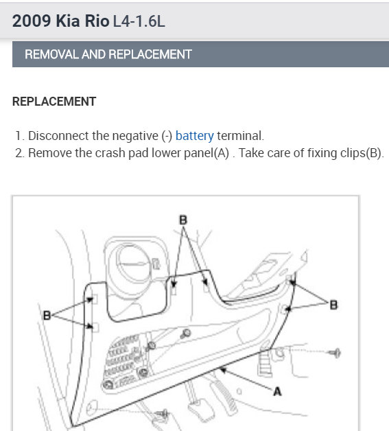

The key won't turn at all. I just need to find out how to remove the cylinder.

Here is the information you requested for ignition switch replacement. I've attached picture steps below for your vehicle. Let me know if you have any further questions on this issue.Hope this helps and thanks for using 2CarPros.
