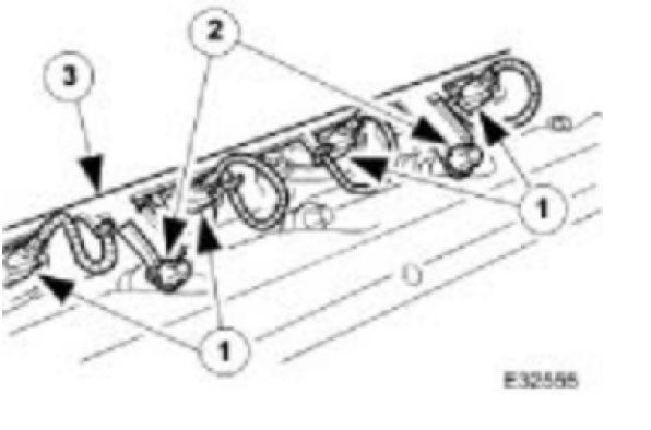

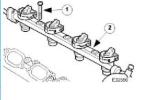

Reposition the fuel injection supply manifold wiring harness. Disconnect the fuel injector electrical connectors
Detach the fuel injection supply manifold wiring harness
Detach the fuel injection supply manifold. Remove the fuel injection supply manifold retaining bolts.

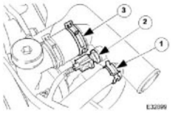

Disconnect the hoses and multi-plug from the coolant outlet pipe. Disconnect the heater hose.
Disconnect the engine coolant temperature (ECT) sensor.
Release and reposition the hose clip along the bypass hose.
Remove the coolant outlet pipe. Remove and discard the sealing rings from the outlet pipe grooves.

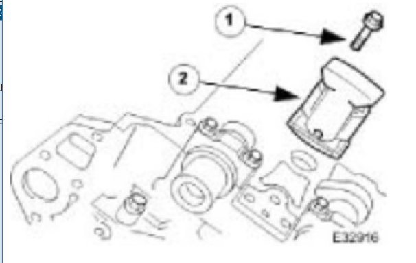

Remove the secondary chain tensioner. Remove the two bolts which secure the chain tensioner to the cylinder head.

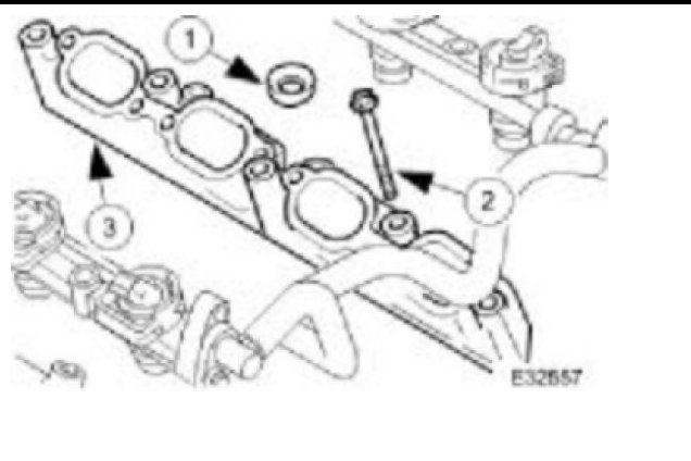

Remove the exhaust manifold to catalytic converter retaining nuts.

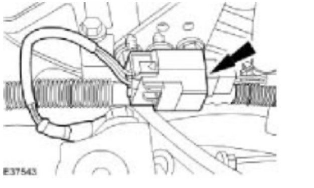

Disconnect the left-hand camshaft position (CMP) sensor.

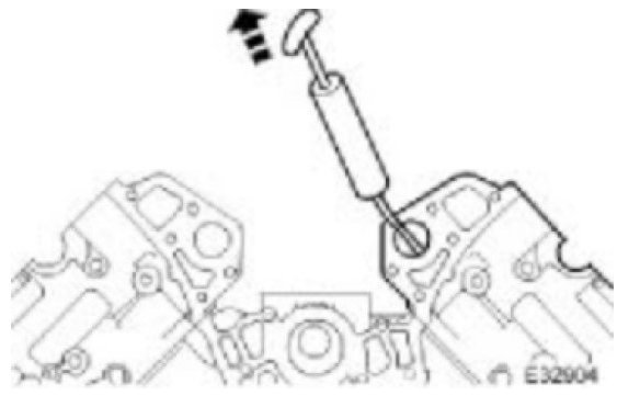

Remove residual coolant from the cylinder head. Place a drain tray under the engine.
Use a syringe with a length of thin rubber pipe connected, to drain the residual coolant from the outlet pipe water-way.
A suitable syringe is Snap On YA 745.

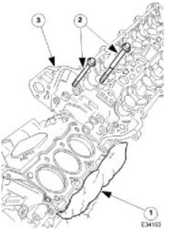

Remove the cylinder head. Place cloth around the area of the cylinder head to absorb coolant spillage, when removing the head.
Remove the bolts (10xM10 and 2xM8) which secure the cylinder head.
With assistance, remove the cylinder head.

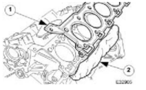

Remove the cylinder head gasket. Note how the gasket is fitted and remove it.

Remove and discard the gasket from the downpipe catalyst. Clean the gasket faces of the catalyst and the exhaust manifold.

Install a new cylinder head gasket.

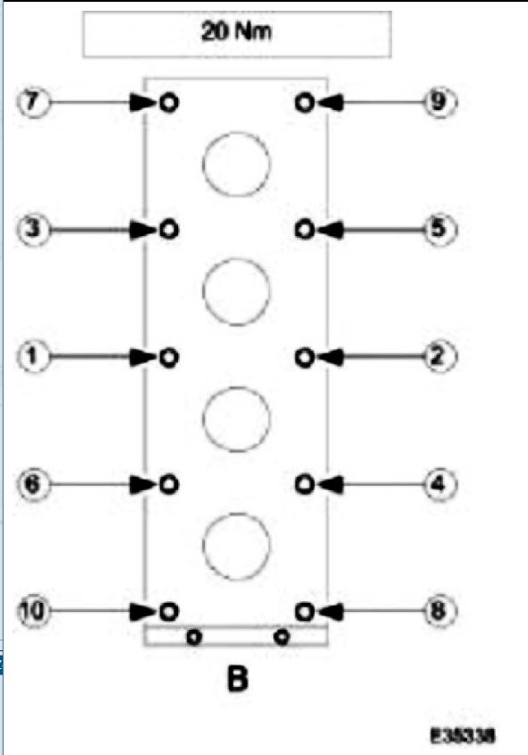

Tighten the cylinder head bolts in stages, in the sequence shown, using the following procedure: Stage 1 - tighten all M10 bolts in sequence, to 20 Nm .
Stage 2 - tighten all M10 bolts in sequence, to 35 Nm .
Stage 3 - tighten all M10 bolts in sequence by 90° .
Stage 4 - tighten all M10 bolts in sequence by 90° .

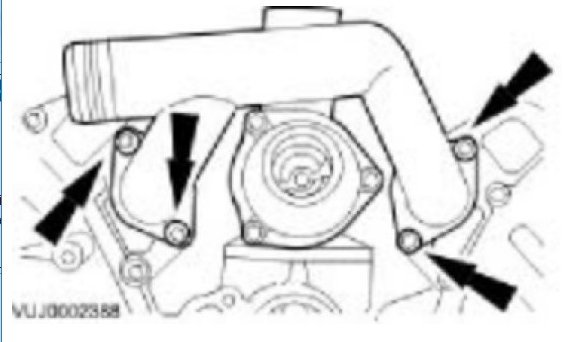

Disconnect the heater hose and temperature sensor connector from the coolant outlet pipe. Loosen and reposition hose clamp along the bypass hose. See Fig. 98.

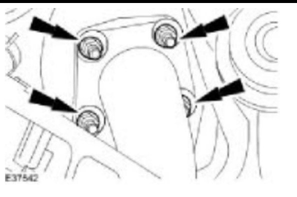

Remove the 4 bolts which secure the coolant outlet pipe. Remove the coolant outlet pipe from the bypass hose and cylinder head. Remove and discard the sealing rings from the coolant outlet pipe grooves. See Fig. 99.

Disconnect the engine position sensor connector, at the rear of the cylinder head. See Fig. 142.

Tighten cylinder head bolts in sequence to proper specification. See TORQUE SPECIFICATIONS. See Fig. 130. Center punch bolts after torque sequence is complete.
