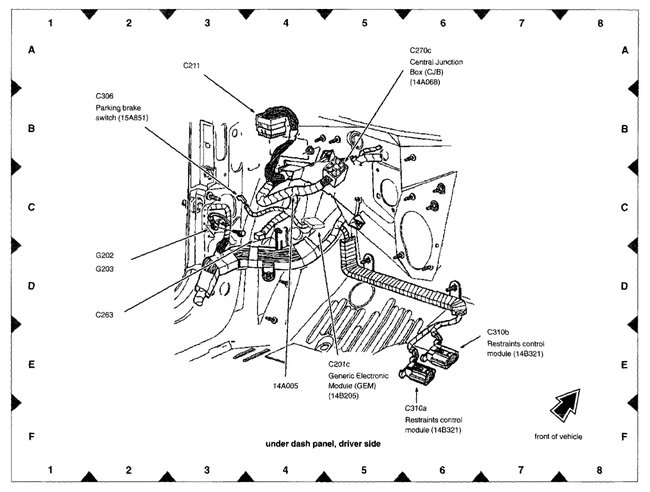

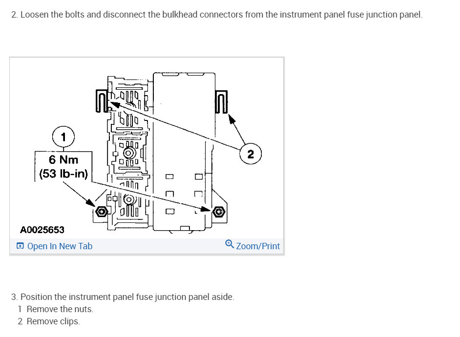

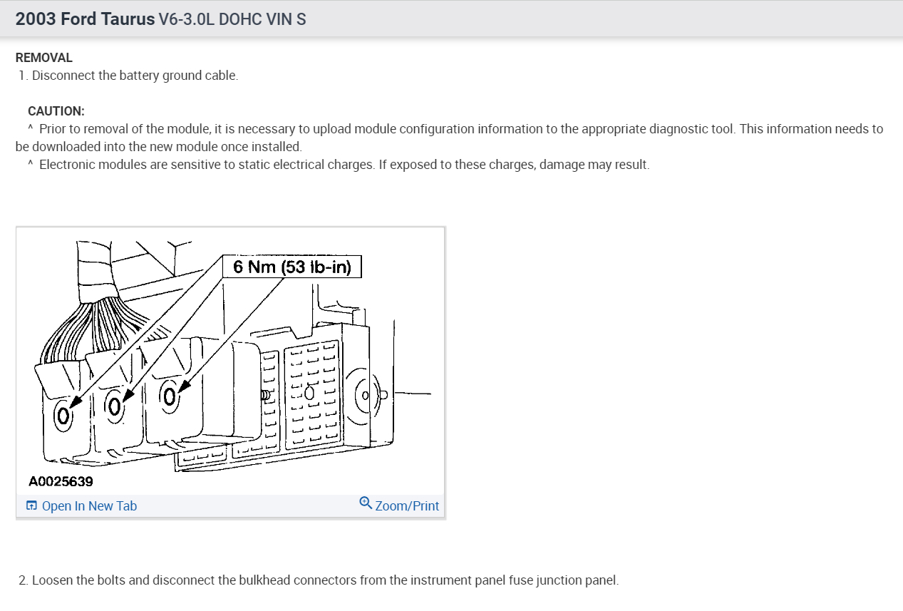

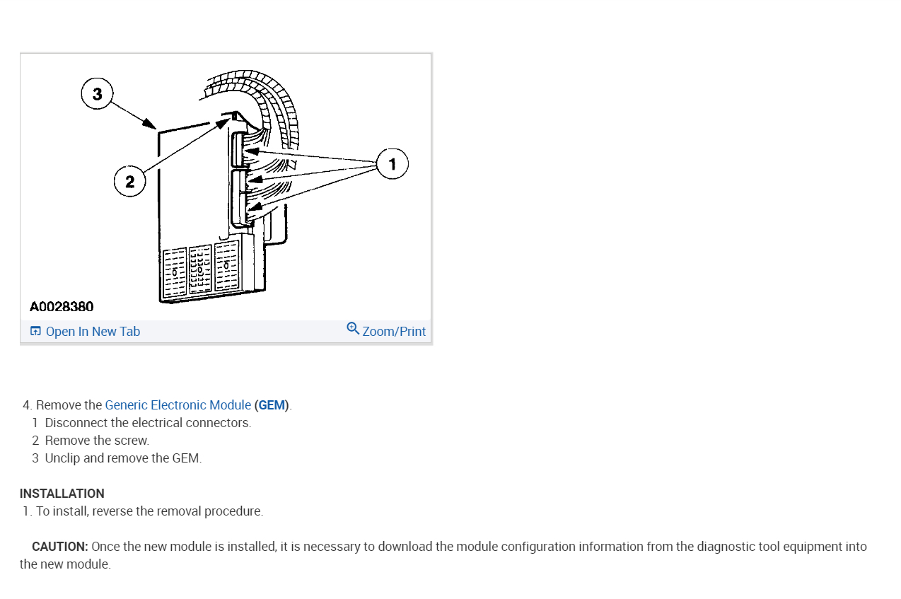

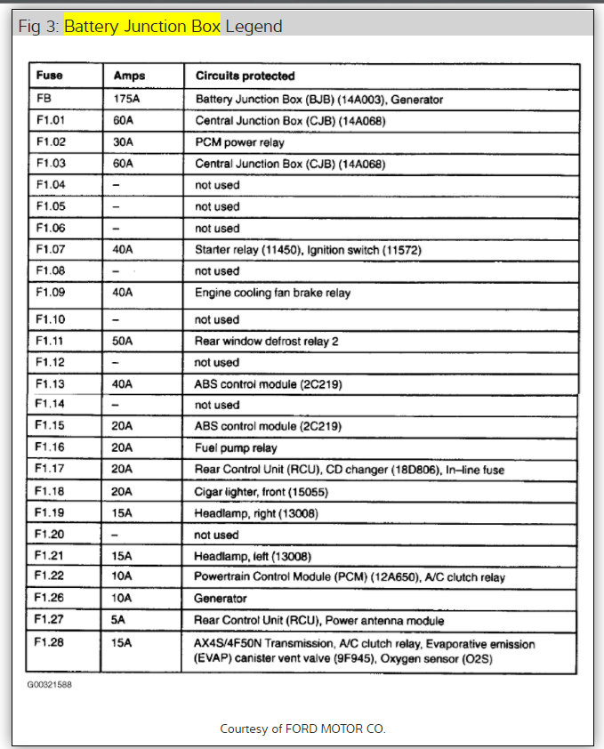

Yep, I assume you checked all the fuses to make sure they are good, if so, this happens when the GEM goes out, but I need to ask is the battery good? This guide can help us check:
Also, to tell for sure the GEM has gone out we should do a CAN scan you can get a CAN scanner from Amazon for about $30.00. here is a video to show you how:
https://youtu.be/u-4syLc-ifQ
Here is a scanner link:
https://amzn.to/3o41KcZ
Here are the instructions for changing out the GEM in case it is the problem. Check out the diagrams (below). Please let us know what happens.

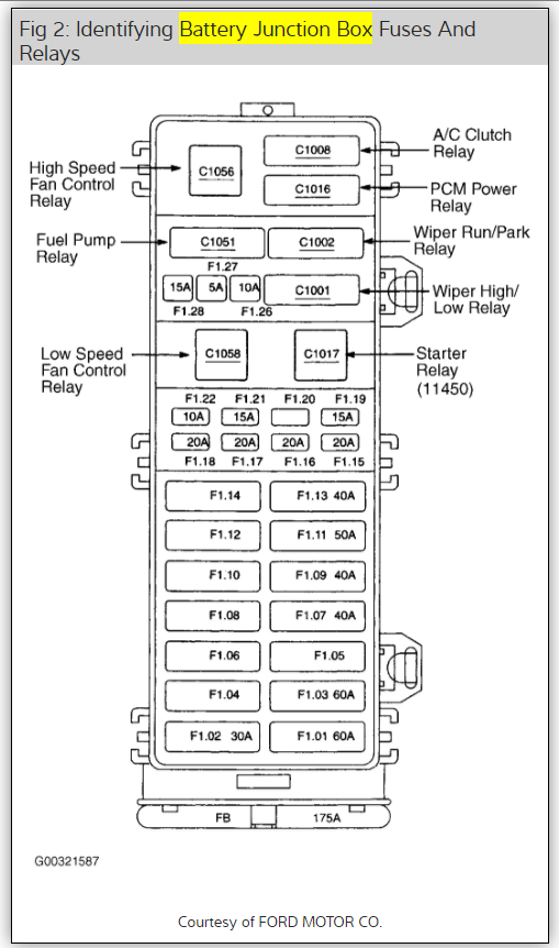

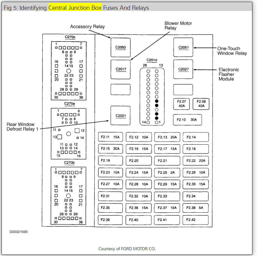

Along with the question I just posted concerning the relays and fuses for the car listed above, I forgot to mention there was a relay with three pins in the interior fuse box as well. Can’t remember where it goes but it won’t fit back into any spot. It’s a 12-v YF1T-13350-AA TBB89 PA6-GF30. When I looked this up online it came back as belonging to the horn. The other night the horn wasn’t working and today it is, but this relay is still not installed

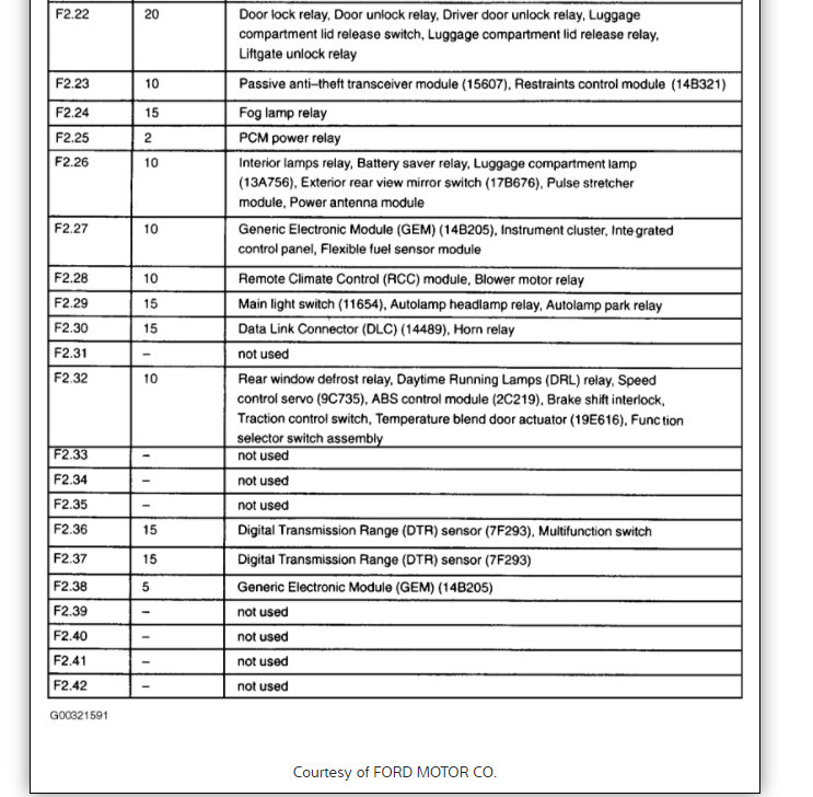

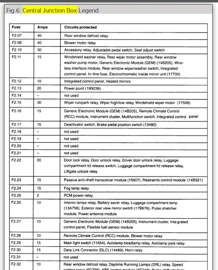

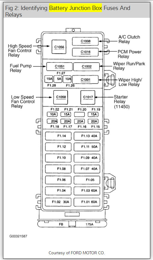

This can be a fuse panel issue as well. Here is a layout for the fuse panel so you can see where the relay goes. Check out the diagrams (below). Please let us know what you find.
