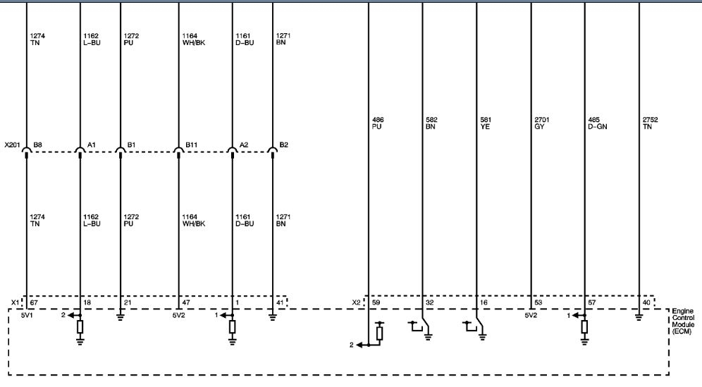

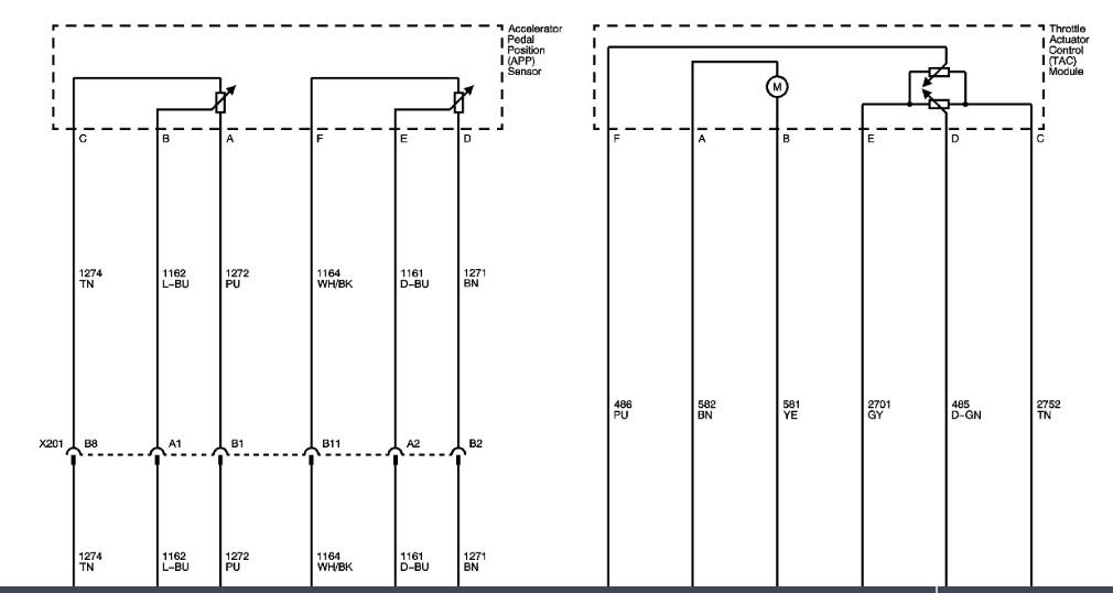

My vehicle listed above sporadically goes into "limp mode" and the dash indicator lights says "reduced engine power." I have had the throttle body changed twice, and the gas pedal assembly changed twice. I still have the same problem. What else could be causing this problem?

Good afternoon,
I attached a wiring diagram for you to view of the system.
I would like to do some testing. Do you have a voltmeter for the testing?
