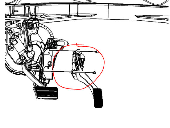

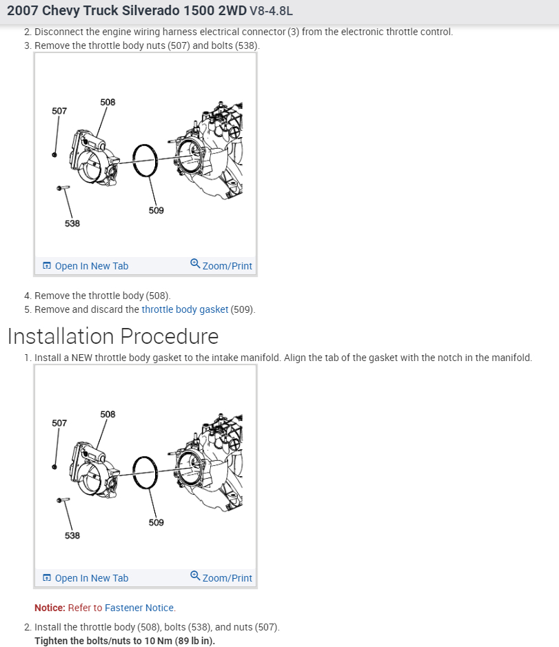

  • 110,244 POSTS
Two of the codes are specific to the heated O2 sensors. I don't feel that would put it in limp mode, but the U0107 indicates the ECM is not receiving or transmitting messages on the CAN bus related to the electronic throttle control system. That would place it in limp mode.
There are two primary components, the throttle actuator control motor and the accelerator pedal position sensor. I will tell you that it isn't uncommon for the electronic throttle body to fail and need to be replaced.
Here is what to start with. First, locate the accelerator position sensor on the throttle pedal and inspect the electrical connector for tightness, corrosion, or any wire damage. See pic 1.
If that appears good, go to the throttle body and do the same.
Let me know what you find. Also, make sure to clean any dirty connections. It may be a good idea to apply dielectric grease at the connections.
See pic below.

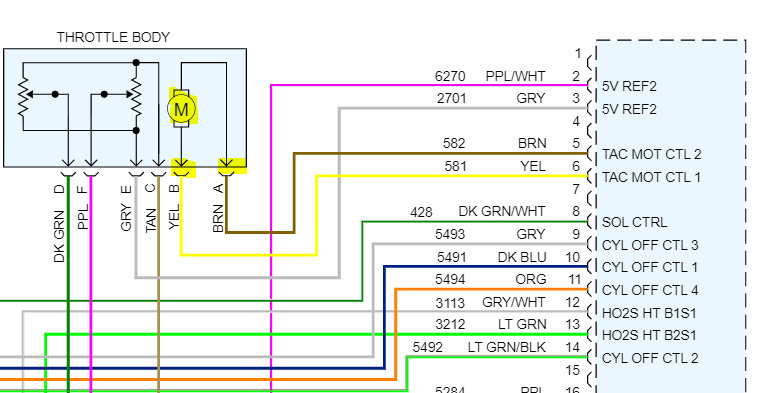

  • 110,244 POSTS
At the throttle body, the connector will have yellow and brown wire. Inspect them to make sure they are not damaged, or the connector isn't loose, corroded, or has a damaged pin.
See pic below.
Take care and let me know what you find.
