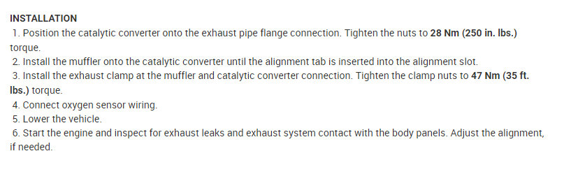

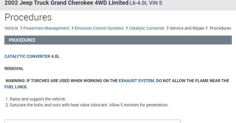

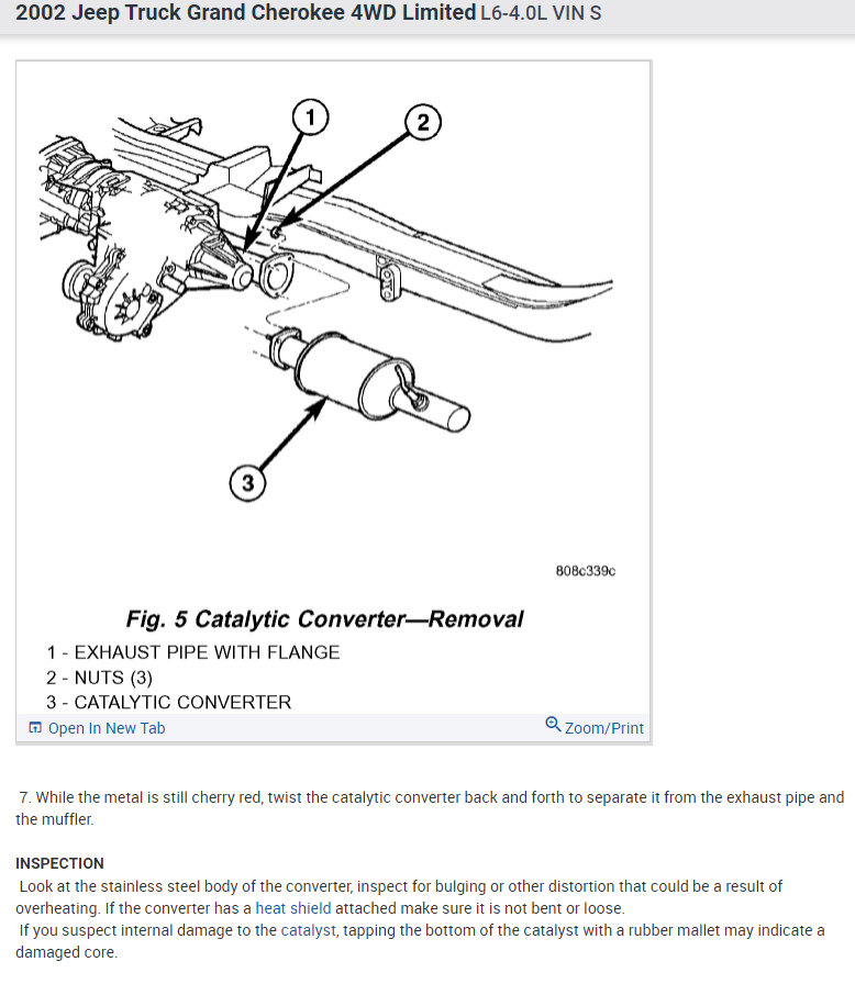

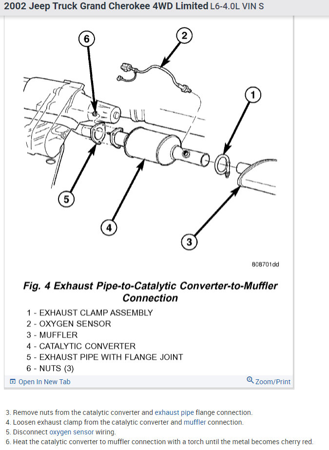

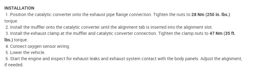

There is a good change you might have a clog/restriction right after that converter.
As you know the internals of the converters can come loose and restrict the air flow.
You might have to take off that pipe to have a look.
