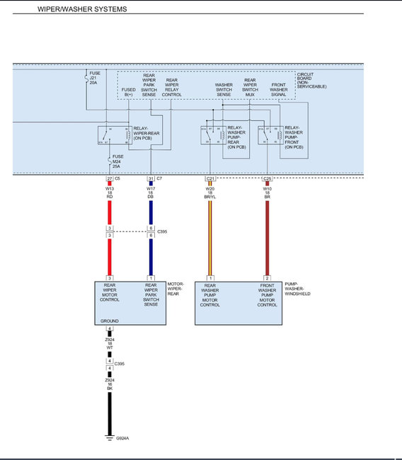

I have found no voltage at the plug in at the motor and no power for that fuse after taking the fuse out which was good. Fuse is #24.
The rear wiper started to stop once in a while then got stuck in the up position.

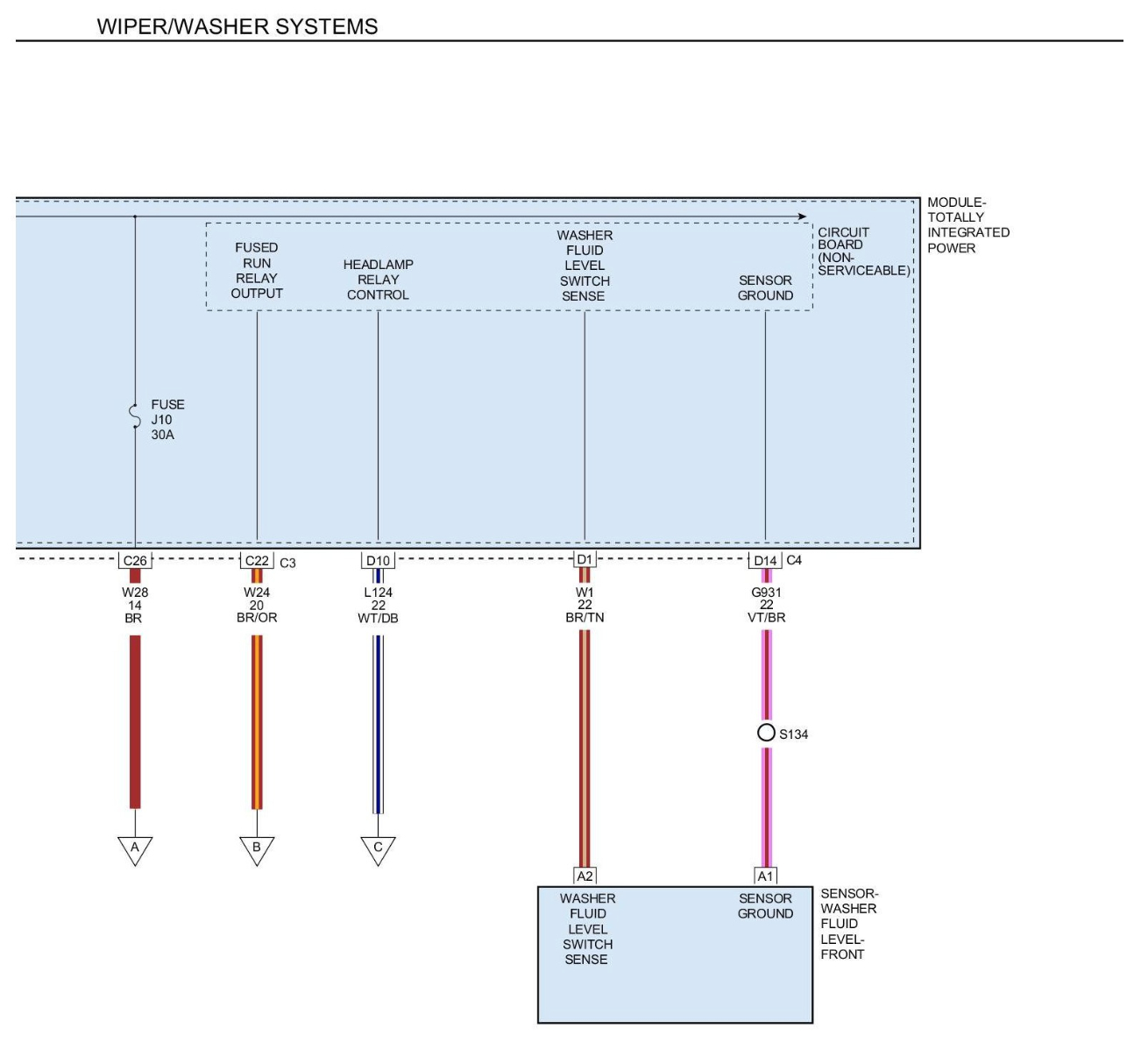

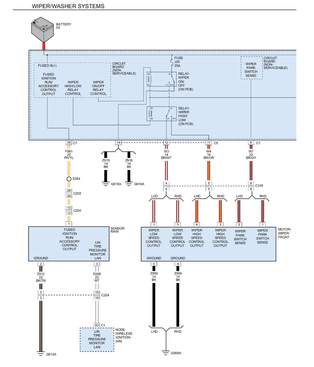

Hey KJEEP,
I have attached the wiring diagram for the system to this message.
Can you please check all fuses in the under hood fuse box (TIPM)?
If you have no power at either side of fuse 24 with the ignition on and rear wiper switched on you may have a problem with the TIPM.

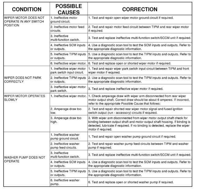

Do you have access to a scan tool?
Do all other functions work on the steering wheel multi-function switch work ie front wipers and lights?
If you can check with scan tool as to the status of the rear wiper switch input and rule out a multi-function switch issue, the relay for the rear wiper motor power is integral to the TIPM.

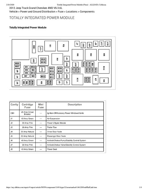

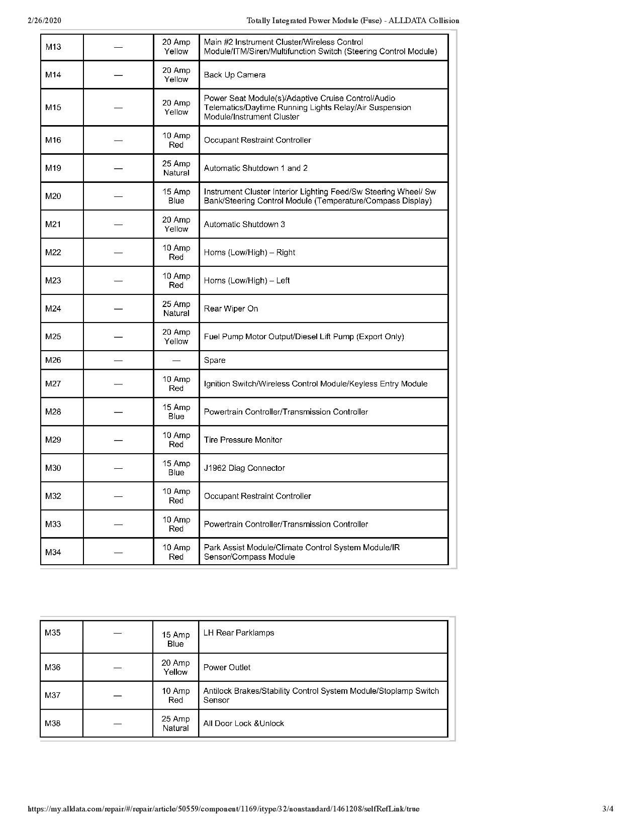

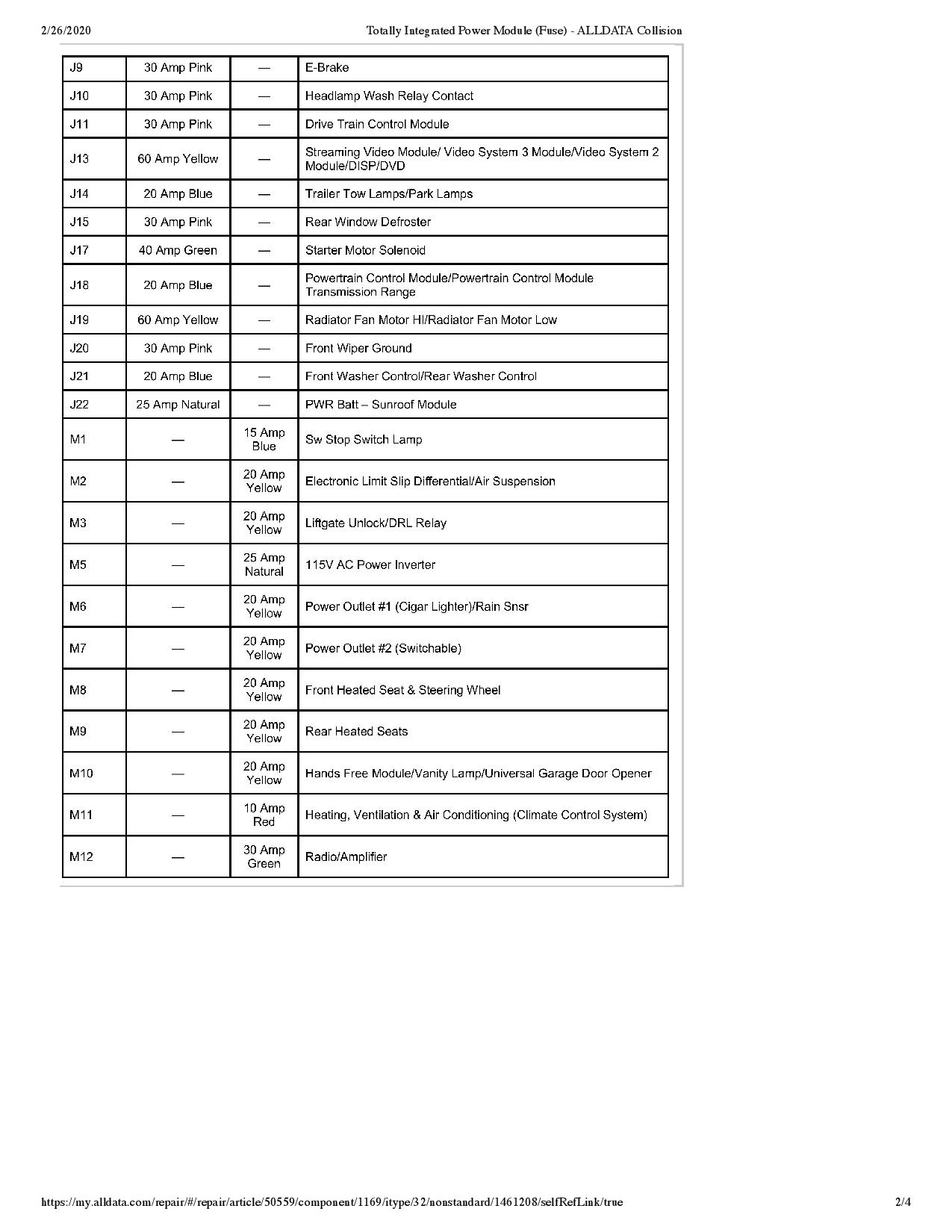

Hey MATTGAK,

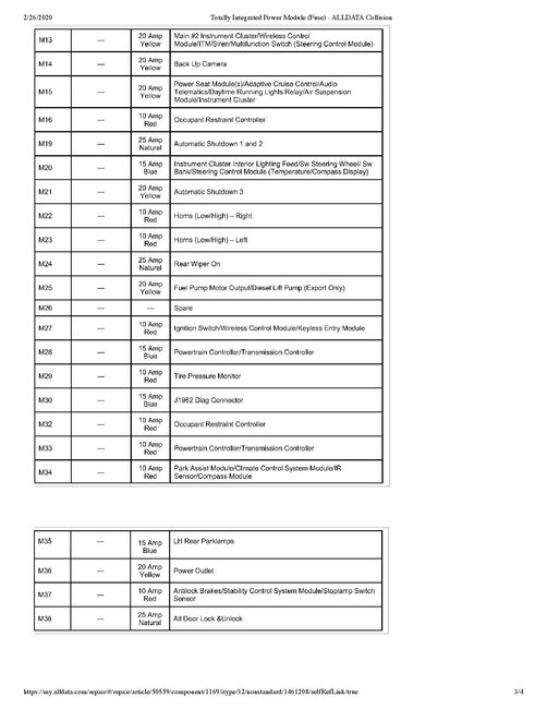

You say you have no power at the fuse?
With the ignition on do you have 12V at both sides of fuse M24?
When testing the power to the fuse M24 make sure the ignition is on, the rear trunk and glass are closed and the rear wiper is turned on.
I have attached the fuse diagram in the picture below.
If you have no power here then you need to check the multi-function switch.
For this the best method is using a scan tool to check input changes from the multi-function switch.
Also check whether the signal from the trunk lid/glass shows that the trunk/glass is closed.
Let us know what you find with the fuse and the inputs from the multi-function switch and rear door switches.
Regards, Joe
