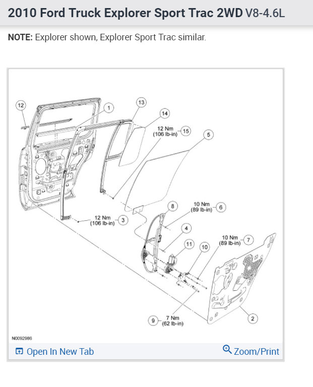

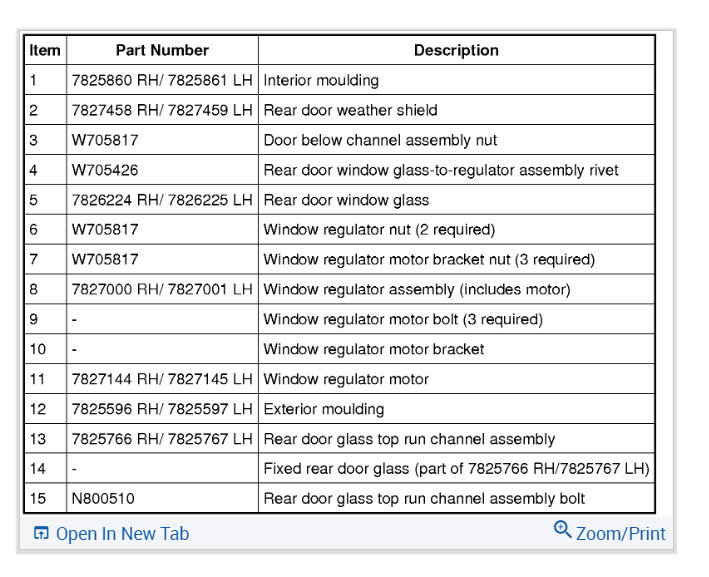

There does not say there is a reprogramming to the new motor. here are the instructions and diagrams to do the repair. Do you get power at the motor and ground? Here is a guide to help:
Check out the diagrams (below). Please let us know what you find.

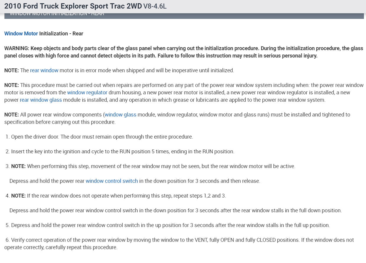

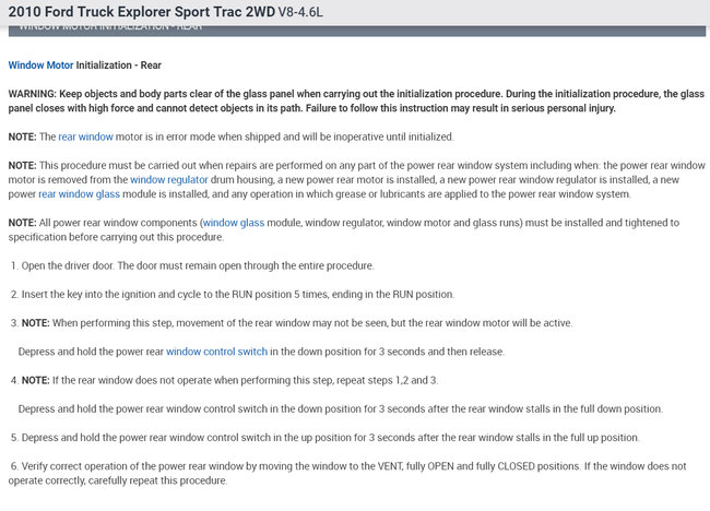

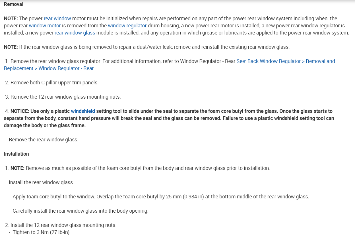

Yep, the new motor needs to be initialized. here are the instructions for the repair below. Check out the diagrams (below). Please let us know what happens.
Jul 5, 2019 at 3:57 AM
BRYANGRODY
Hi Ken,
I tried the initialization procedure with no luck. Thanks for the information. Do you have the pinouts of the plug going to the motor?

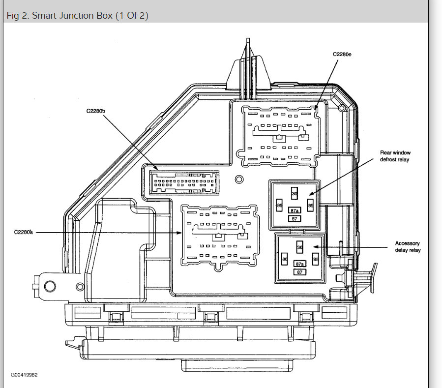

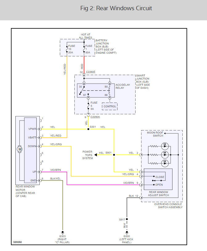

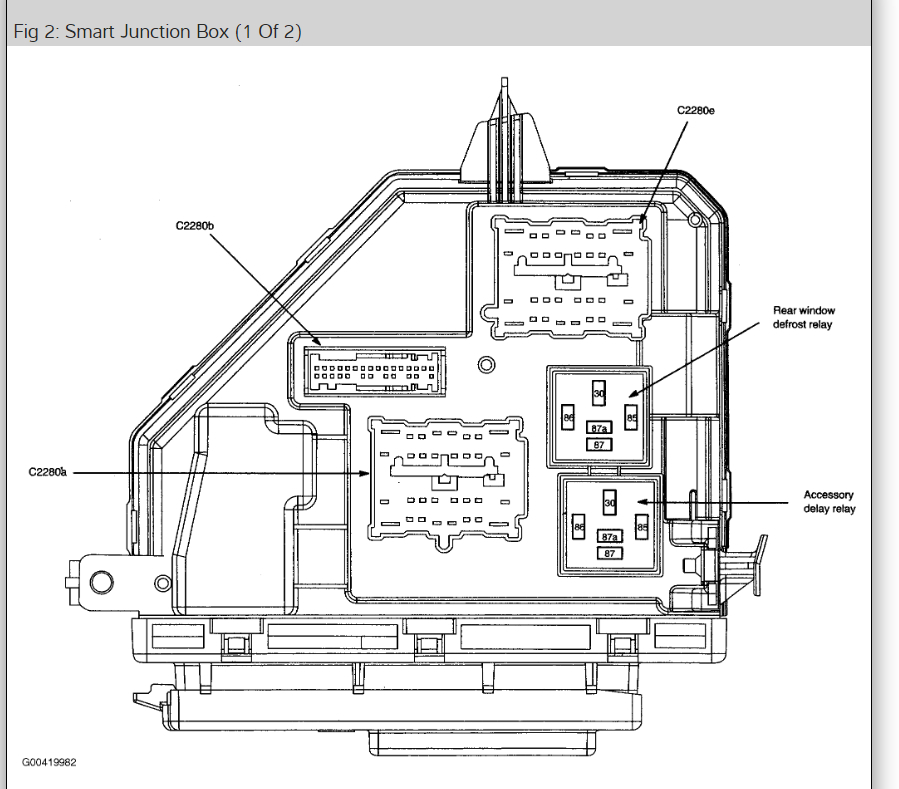

There is an Acc/Delay relay that I would look at in the smart junction box on the left side of he dash. here is a guide to help check it with the wiring diagrams for the rear window:
Check out the diagrams (below). Please run this test and get back to us.
Jul 5, 2019 at 6:09 AM
BRYANGRODY
Ken, I'm stumped! I trace the wires on the plug and checked all the voltages everything going to the motor is correct I get 12 volts where I should get 12 volts in the switch goes 12 volts when I go up in 12 volts when I go down but the motor does nothing. I even tried plugging in the old motor and doing the initialization procedure and neither motor does anything. I am thinking about trying to get a warranty replacement and try another motor and regulator what do you think? Thank you for all your help.
