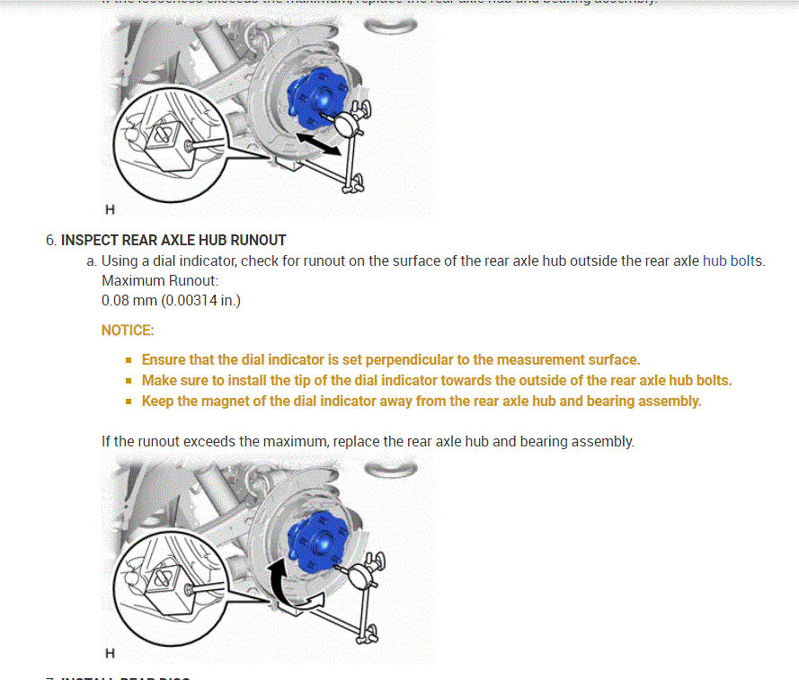

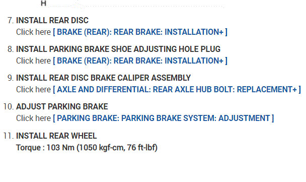

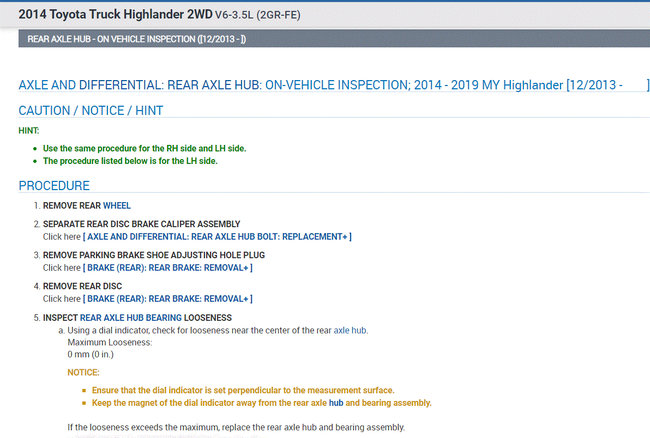

There really shouldn't be free play. Are you certain it is the hub bearing? I noted you indicated you feel it when the parking brake is on. Are you certain it is the bearing and not a control arm bushing?
If you look at the first three pics below, they explain how the hub bearing is checked. Note: that there is a very small tolerance for the bearing.
Let me know if that is something you are comfortable doing. Also, let me know what side of the vehicle is affected, what movement you see (for example, in and out, or front to back), and anything you can think of that can help us figure this out.
