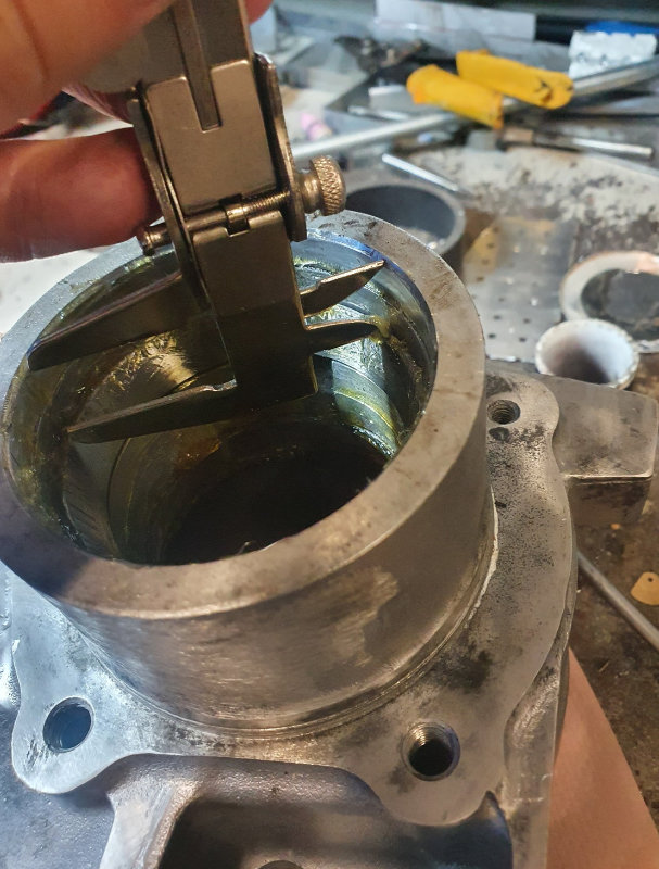

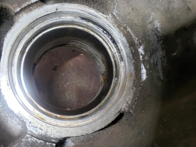

Doing the rear wheel bearings on this car, inner and outer. I have the Pro Demand instructions for removing and installing, but I have a concern about installation.
I have the driver's side carrier removed, and the inner bearing and seal simply fell out. The outer bearing also fell out after removing the seal. It says that installation/removal requires a press, but the only parts I see that are pressed into the carrier are the bearing races, which are still snugly in the carrier. My concern is, do I just place the newly packed bearings the way they came out, or do I really press the new bearings into the races?

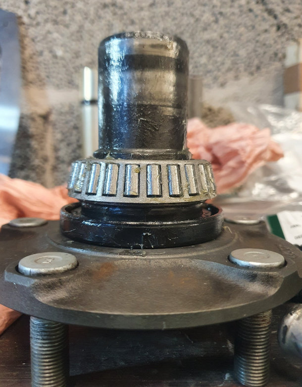

The outer bearing should not have just fallen off; it is tight on the hub held in with a spacer ring. See image 1 below
Fit the new races as these are machined as a set with the bearings

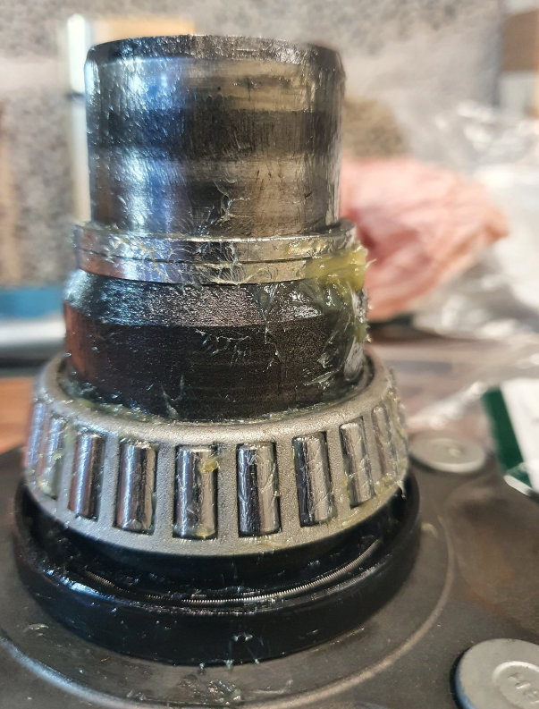

There will be a tube type spacer in the center of the carrier between the bearings. note its position, the inner bearing has a smaller diameter face, the tube has two different size ends, each corresponding to the bearing is faces. See image 1
There will also be a small washer (shim) against the inner face of the outer bearing... do not lose it.

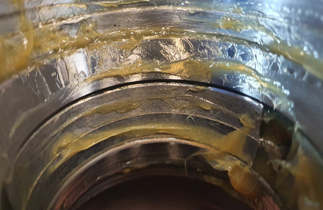

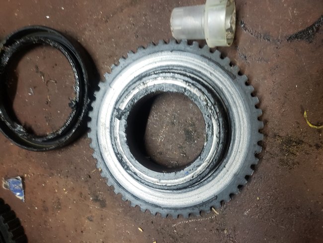

12.you will see a channel cut out of the carrier between the two outer bearing races. use a punch and set it into this channel get to the back edge of the bearing race and tap it out with the punch and a hammer. there are 2 channels 180 degrees apart... tap one side then the other and the race will come out. repeat for the other side going in the opposite direction. See image 2 and 3. Take note of installed race depth, compare before and after

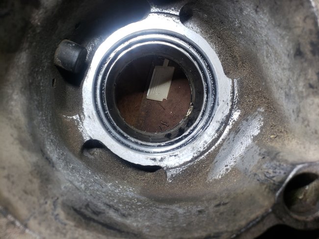

1.After tapping the races in, install the seal then bearing on the hub shaft.
You will need to tap the outer bearing home on the shaft. See image 4

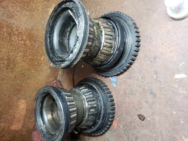

Hi, thanks for the pictures. Yes, the hub fell out when the carrier moved downward, and with no seal or bearing attached. When I removed the carrier, the seal inside fell out with the bearing, and the shim and spacer also. The shim was kind of glued with grease. The outer seal I had to pry out, and the other bearing I only just pulled out with my hand. Is this all a bad sign?
So, for new races, I just need to hammer in with a punch? Also, your pictures show the bearing on the hub, does it need to be done that way? It's a little different than Jaguar's instructions.

The installation instructions I provided are a simplified version of Jaguar's instructions. Please follow what you are comfortable with.
A hammer with a decent drift/punch is all that would be required to remove/install the races. Just ensure that they are seated straight in the housing. I usually use the old race as a drift tool so that I do not apply direct force on the new part.

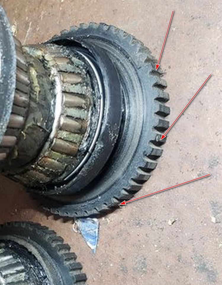

Good to know. Right now, I'm waiting for parts to be delivered. I attached a picture of one of the ABS rotors. Does this need replacement? It just looks bad. Also, I attach pictures of the other things just for this thread.

The ABS rotors need to press on to the hub once the bearings are assembled.
It is important that the ABS rotor fits snug and is not loose. Same goes for the inner bearings, they need to fit snug.
There seems to be some wear grooves on the outer parts of the ABS rotor, unfortunately the pictures were not quite clear. I enlarged the one you had provided, see below.

Could I use the same technique you mentioned above to press the rotors on to the hub? Like using a large socket or something to tap into place?

Yes, you can.
