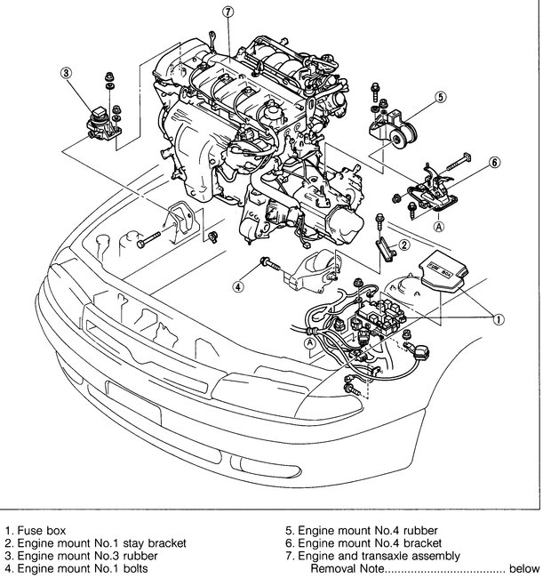

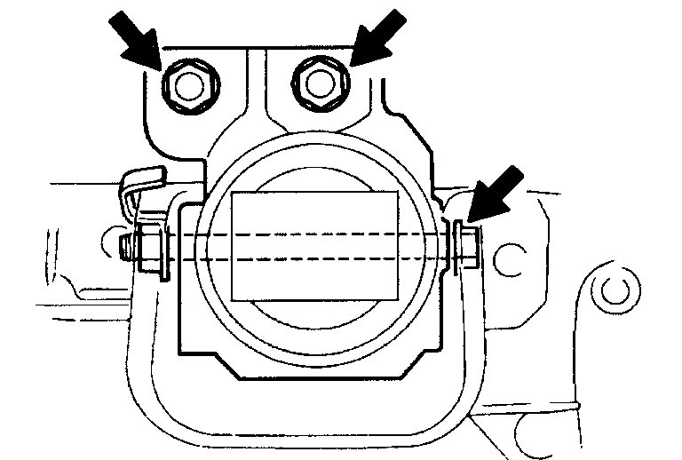

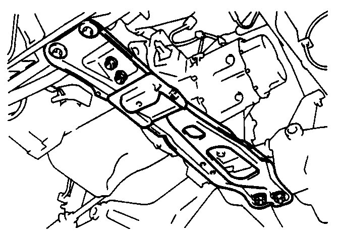

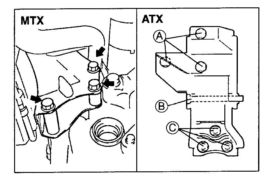

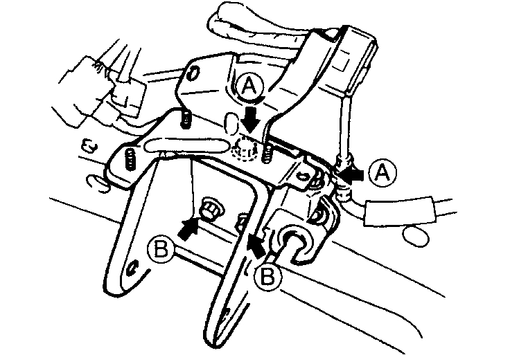

The only way I can figure is that I need to remove the intake manifold to gain access to the motor mount. I need procedure and graphic picture of parts names.
Apr 24, 2020 at 12:48 PM
  • 110,240 POSTS

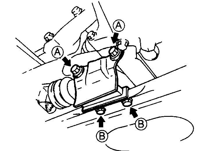

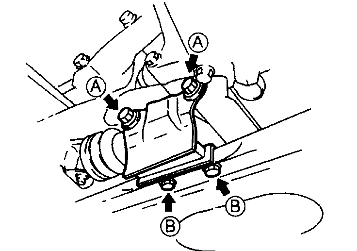

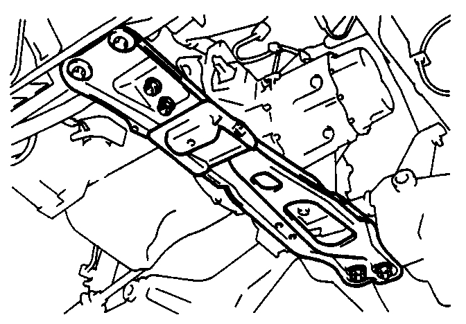

If you are referring to the one in the rear of the engine, the engine mount cross member needs removed to access it. This requires the engine to be supported via a chain/engine hoist.

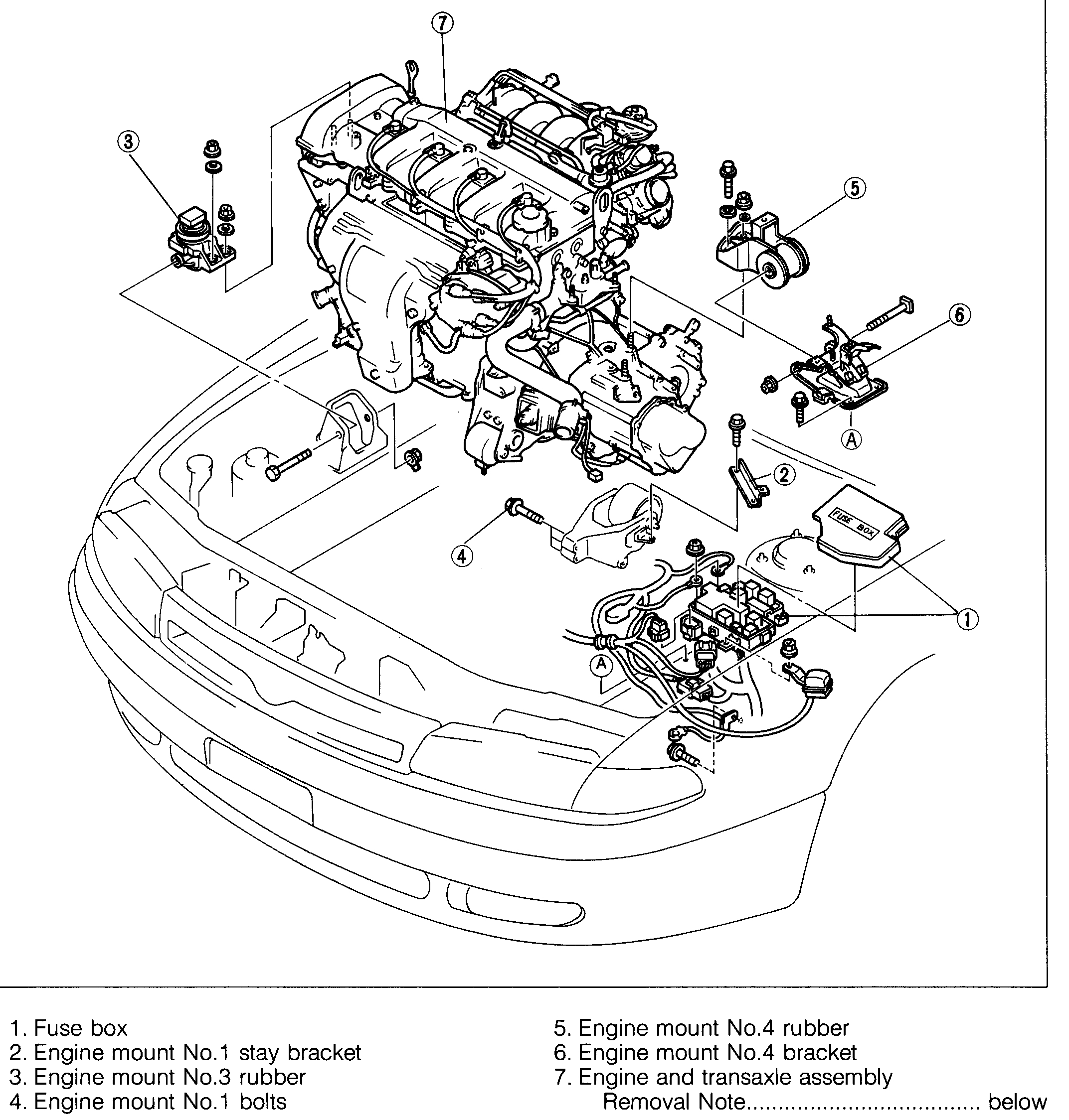

Here are the directions I have for replacement. The attached pictures correlate with the directions. I have to be honest, it is somewhat vague, but does describe the correct process.
________________________________________
1998 Mazda 626 DX L4-2.0L DOHC
Removal
Vehicle Engine, Cooling and Exhaust Engine Drive Belts, Mounts, Brackets and Accessories Engine Mount Service and Repair Procedures Removal
REMOVAL
pic 1
pic 2
Engine mount member
Caution
- Support the engine before removing the member.
pic 3

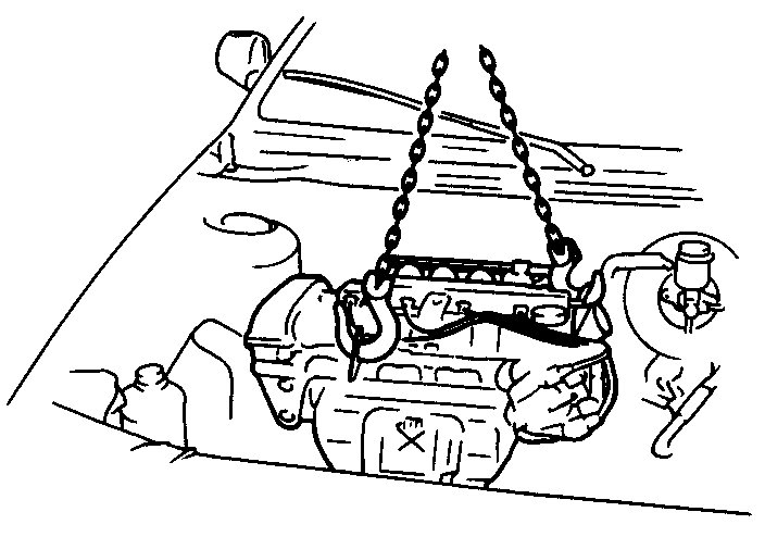

1. Suspend the engine by using a chain block.
2. Remove the engine mount No.2 nuts.
3. Remove the engine mount member bolts and nuts and remove the engine mount member.

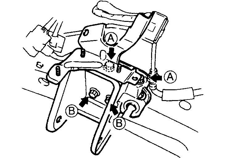

Vehicle Engine, Cooling and Exhaust Engine Drive Belts, Mounts, Brackets and Accessories Engine Mount Service and Repair Procedures Installation

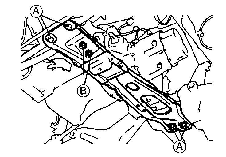

INSTALLATION
pic 4
Engine Mount Installation
1. Hand tighten the nuts marked (B). (No 2 engine mount)
2. Install the bolts and nuts shown.
Tightening torque
(A): 67-93 N.m (6.8-9.5 kgf.m, 50-68 ft.lbf)
pic 5

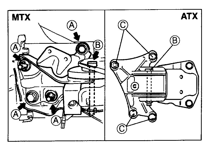

3. Install the No.1 engine mount mounting bolts.
Tightening torque
MTX: 67-93 Nm (6.8-9.5 kgf.m, 50-68 ft.lbf)
ATX
(A): 67-104 N.m (6.8-10.7 kgf.m, 50-77.3 ft.lbf)
(B): 86-116 N.m (8.7-11.9 kgf.m, 63-86.0 ft.lbf)
(C): 67-93 N.m (6.8-9.5 kgf.m, 50-68 ft.lbf)
pic 6
4. Install the No.3 engine mount rubber.
Tightening torque
Nut: 74-102 N.m (7.5-10.5 kgf.m, 55-75.9 ft.lbf)
Bolt: 86-116 N.m (8.7-11.9 kgf.m, 6-6.0 ft.lbf)

5. Install the No.4 engine mount bracket.
6. Hand tighten bolts (B).
7. Tighten bolts (B).
8. Tighten bolts (A).
Tightening torque
(A): 59-80 N.m (6.0-8.2 kgf.m, 44-59 ft.lbf)
(B): 59-80 N.m (6.0-8.2 kgf.m, 44-59 ft.lbf)

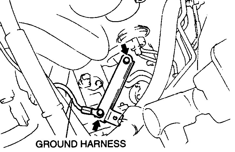

14. Install the No.1 engine mount stay bracket and ground harness (MTX).
Tightening torque:
6.9-9.8 N.m (70-100 kgf.cm, 61-86.8 in.lbf)

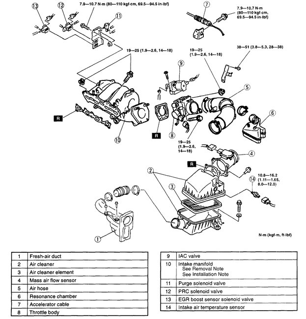

I just need enough room for the breaker bar to loosen the rubber bolt on the mount. I have already accessed the other three bolts. The link is AutoZone's instructions, however the picture will nor expand successfully. which the intake manifold was removed. There are several items that require removing. https://www.autozone.com/repairguides/626-1999-2001/Engine-Mechanical-Components/Intake-Manifold/_/P-0996b43f81b3cb43
Apr 24, 2020 at 3:27 PM
  • 110,240 POSTS

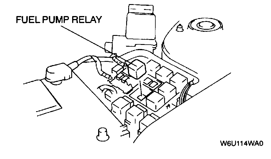

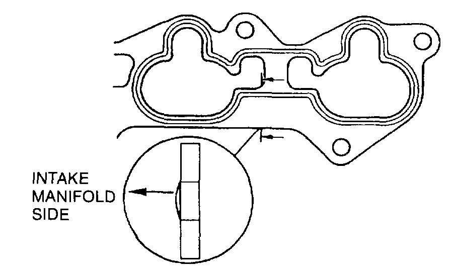

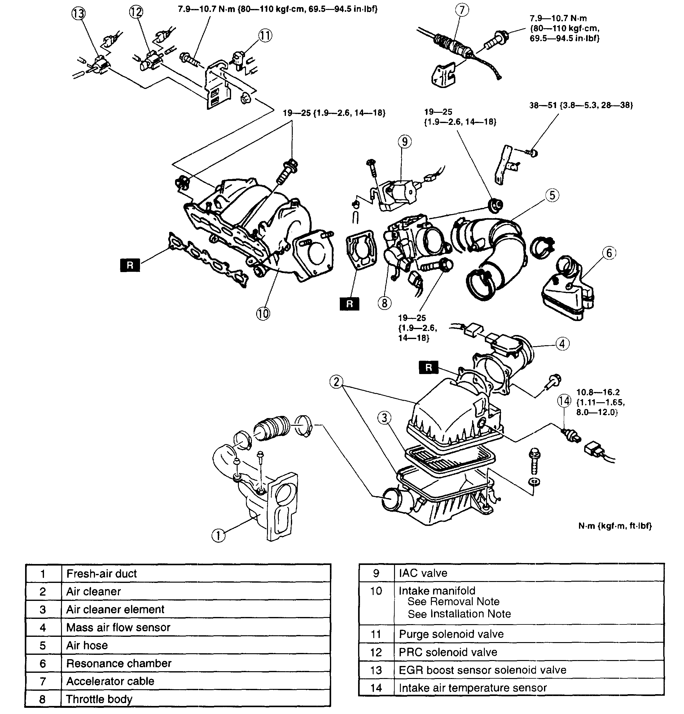

Do you need the directions for intake removal? Here are the directions. If you needed something different, let me know. The two pics attached correlate with the directions.
Intake-Air System Removal/Installation
Vehicle Engine, Cooling and Exhaust Engine Intake Manifold Service and Repair Procedures Intake-Air System Removal/Installation
INTAKE-AIR SYSTEM REMOVAL/INSTALLATION
WARNING: When the engine and intake-air system are hot, they can badly burn. Turn off the engine and wait until they are cool before removing or installing the intake-air system.
1. Disconnect the negative battery cable.
2. Drain the engine coolant from radiator
WARNING:
- Fuel vapor is hazardous. It can very easily ignite, causing serious injury and damage. Always keep sparks and flames away from fuel.
- Fuel line spills and leaks are dangerous. Fuel can ignite and cause serious injuries or death and damage. Fuel can also irritate skin and eyes. To prevent this, always complete the Fuel Pressure Release Procedure.
NOTE: To remove the intake manifold, remove the fuel distributor, EGR pipe and EGR valve.
pic 1
3. Remove in the order indicated in the table.
4. Install in the reverse order of removal.
pic 2
NOTE: To install the intake manifold gasket, make sure that the convex side of gasket is faced to the intake manifold side.

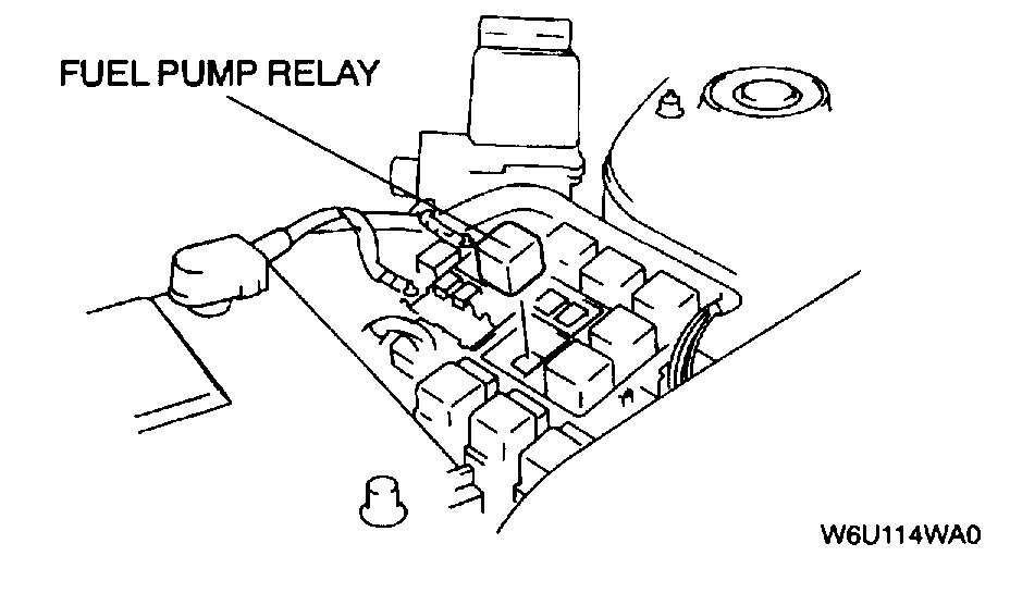

Excellent. Can you tell me the Fuel Pressure Release procedure?
Apr 26, 2020 at 4:31 AM
  • 110,240 POSTS
Absolutely. Here are the directions for fuel pressure release. The attached picture correlates with the directions.

pic 1
1. Remove the fuel pump relay.
2. Start the engine.
3. After the engine stalls, crank the engine several times.
4. Turn off the ignition switch.
5. Install the fuel pump relay.
6. Remove the fuel filler cap and release the pressure in the fuel tank.
Hope this helps.
