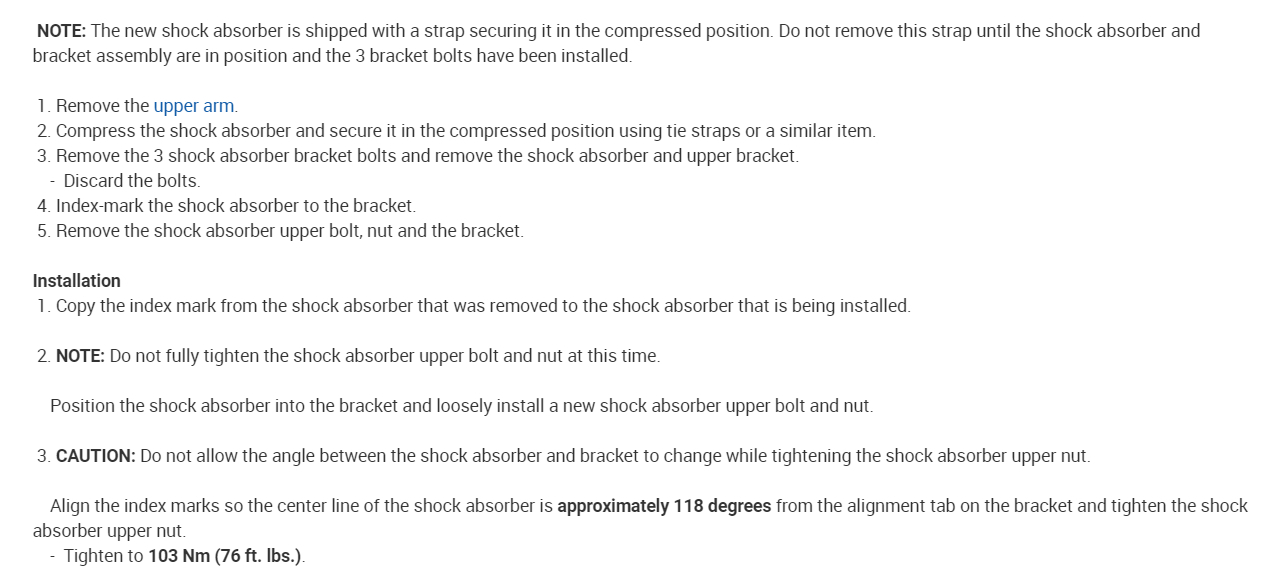

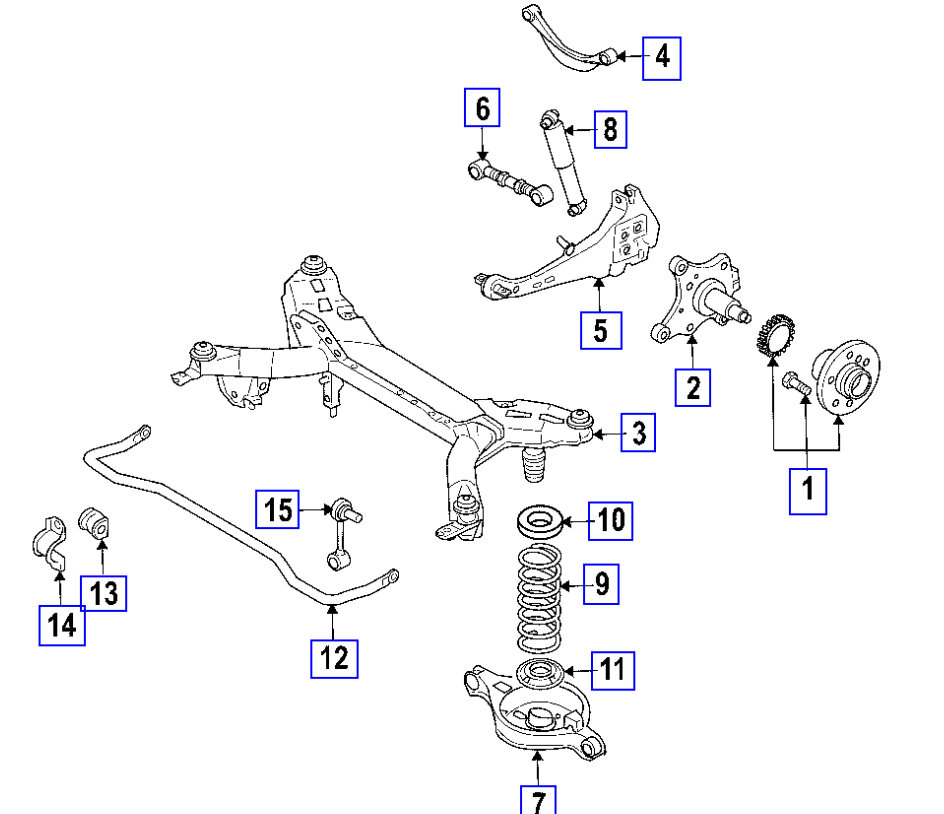

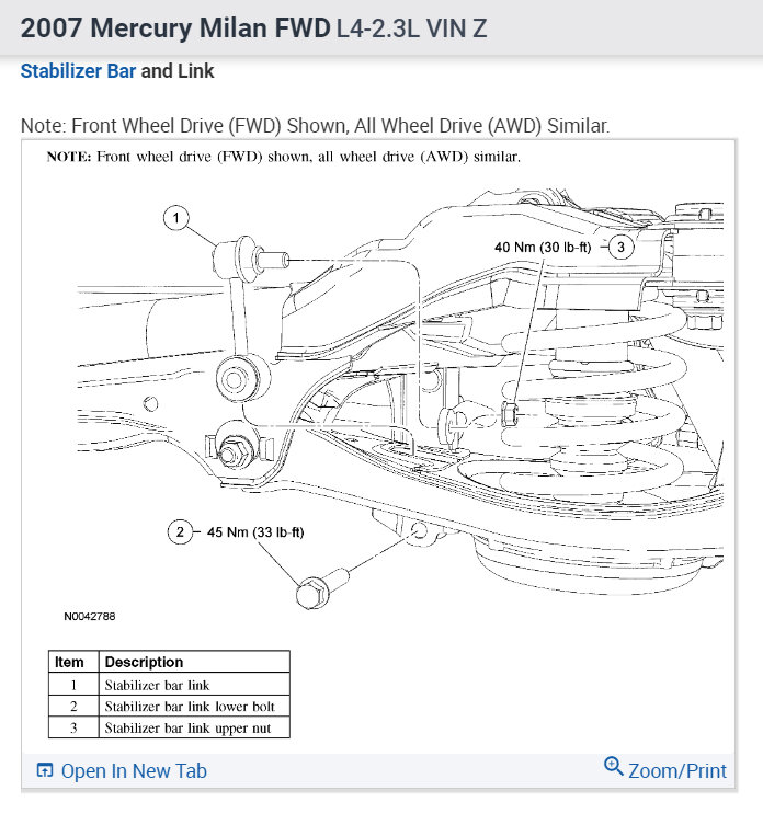

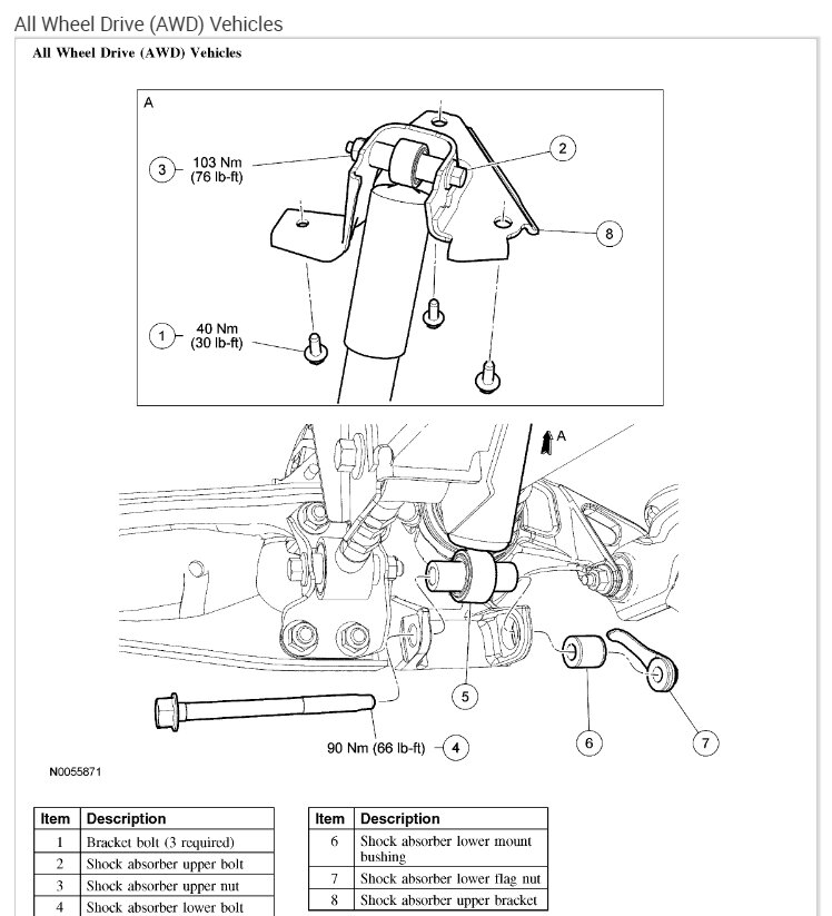

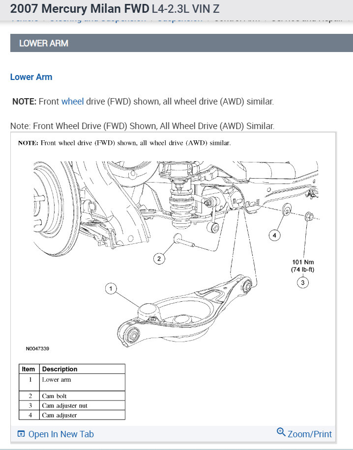

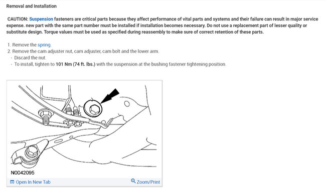

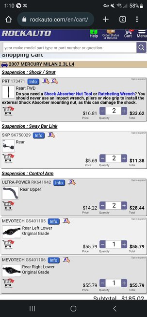

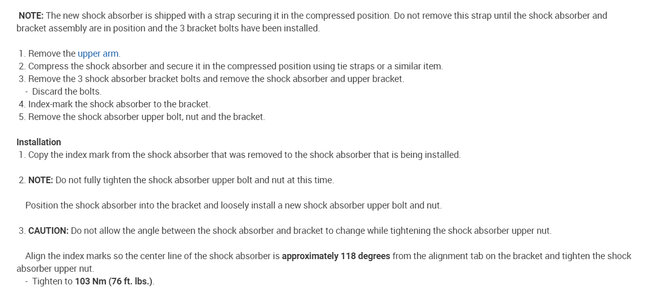

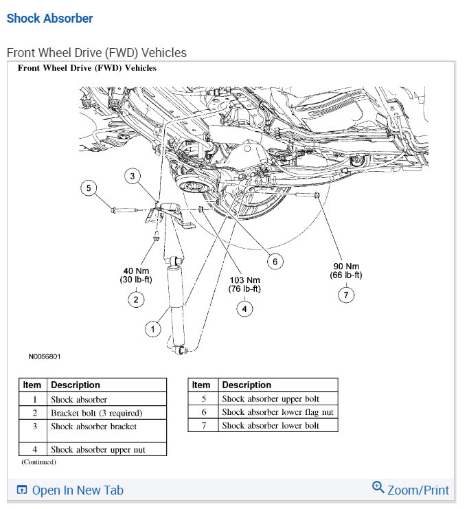

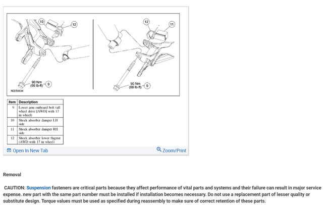

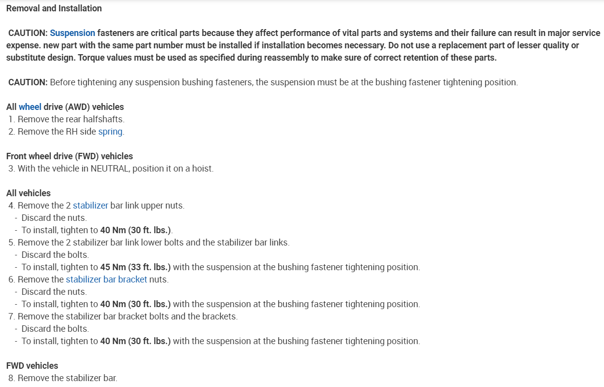

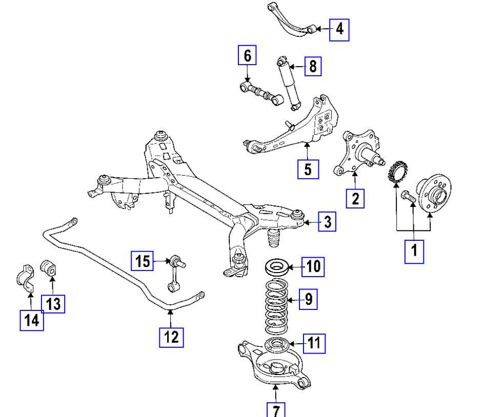

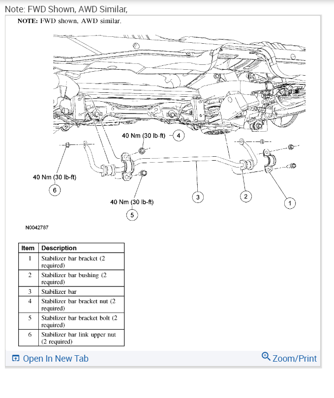

I need a diagram on how to change the rear suspension parts on my vehicle listed above. I have a lot to change out and I need some help.
Sep 1, 2023 at 6:24 PM
  • 55,711 POSTS

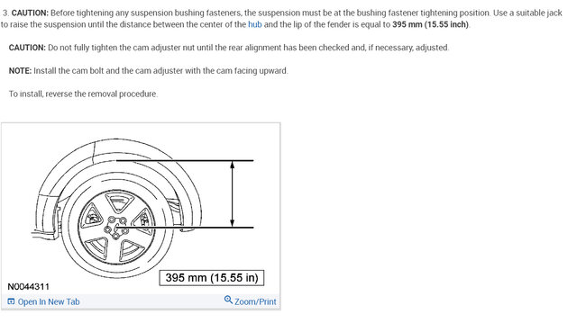

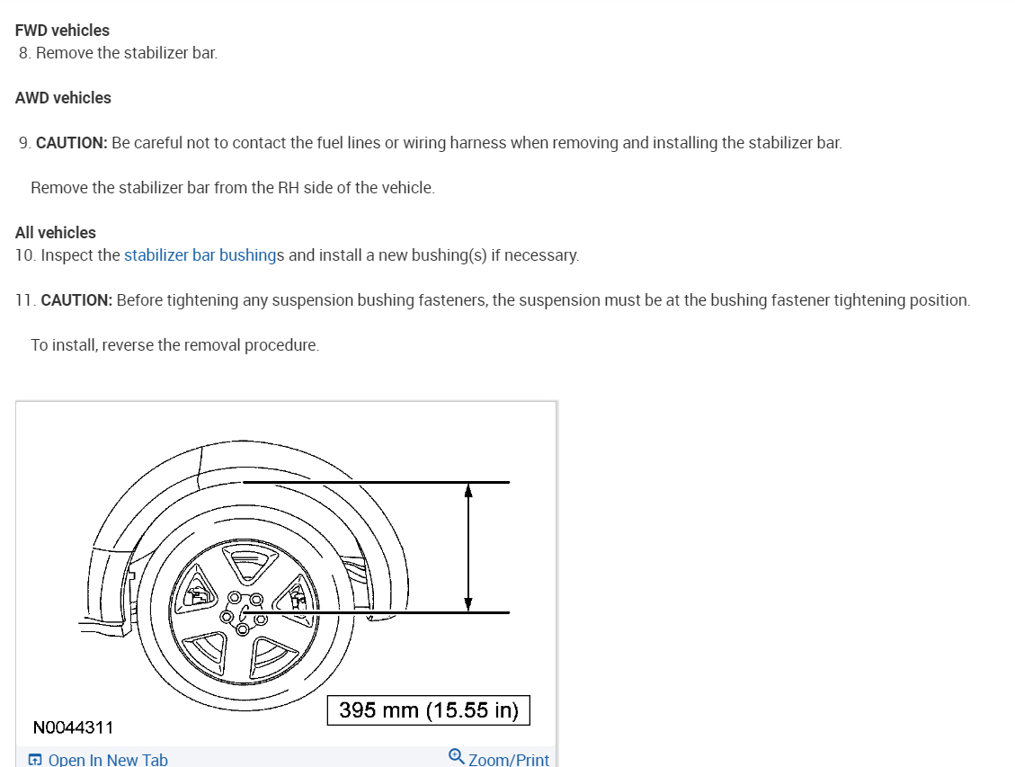

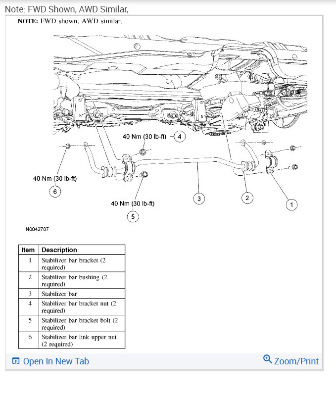

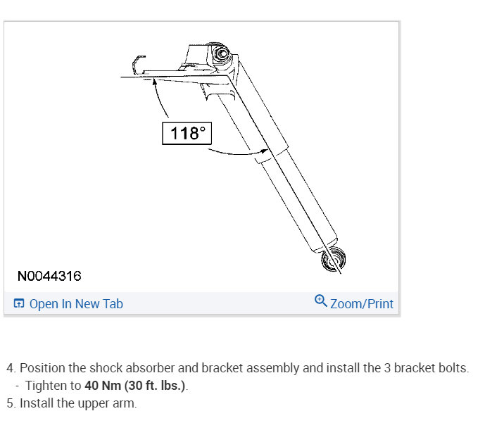

Sure, here are the instructions to replace the items on the list including the lower control arm, sway bar link and the rear shocks. Check out the images (below). Please let us know if you need anything else to get the problem fixed.
