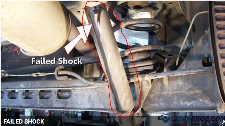

Hi Theresa. Is there anything you can think of that may prompt this to happen? For example a bump, turning, accelerating or decelerating? Are you certain the wheel is tight?
I ask because there are so many different things that can make a thumping sound. There are rubber bushings, strut mounts, a flat spot on a tire, a bad shock and so on.
To get started and try to narrow this down, here is a link that discusses different causes of such noises. Some of the things listed are specific to the front, but others are not.
https://www.2carpros.com/articles/popping-noise
Now, if you feel a vibration when this happens, check the right rear shock to see if it is leaking and bounce the vehicle on that side to see if it seems weak. If the vehicle continues to bounce more than three times when you stop, the shocks should be replaced.
I attached a picture of what to look for as far as a shock leaking. If you find this is the issue, here is a link that shows how to replace them:
https://www.2carpros.com/articles/replace-shock-absorber
