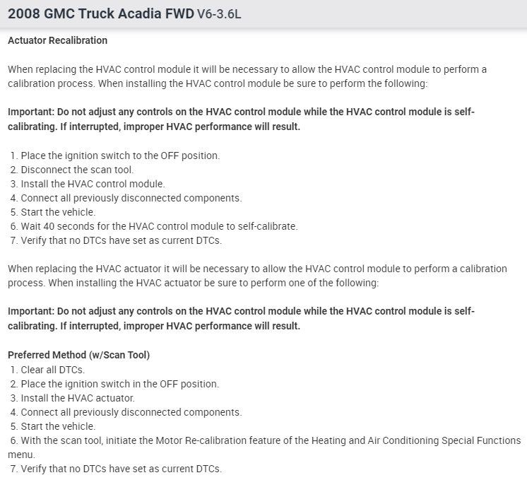

My rear blower works but it is not blowing heat. Front heat works just fine.
Dec 5, 2019 at 2:37 AM
DANNY L
  • 5,648 POSTS
Hello, I'm Danny.

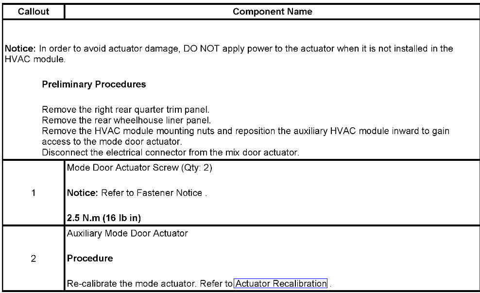

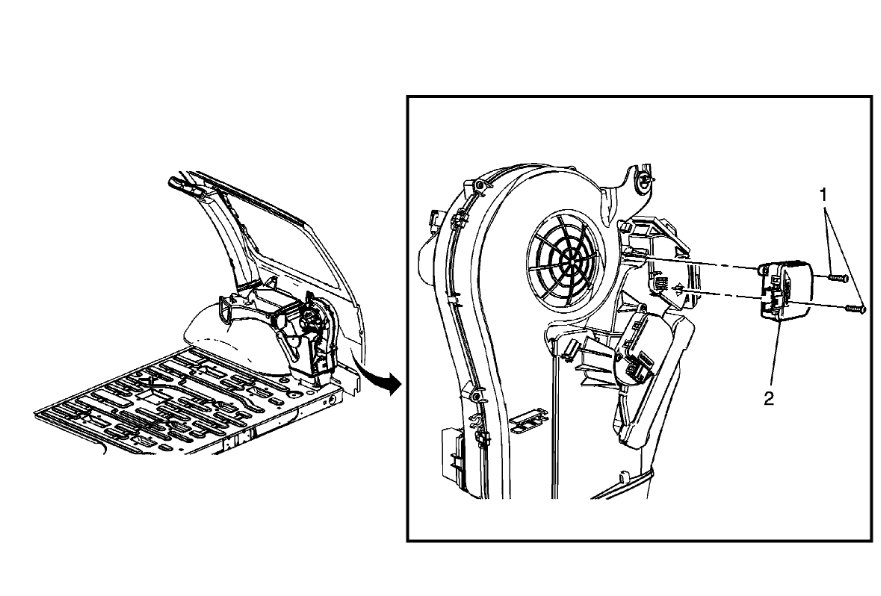

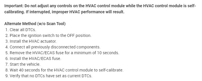

It sounds like you are having an issue with the rear auxiliary HVAC unit blend door actuator.It is a small electric motor that diverts air flow through the specific vents. Here is a tutorial showing what is involved to replace:
I've attached step-by-step picture instructions below on how to replace and its location. I've also include the steps on how to re-calibrate the actuator after replacement.Hope this helps and thanks for using 2CarPros.
