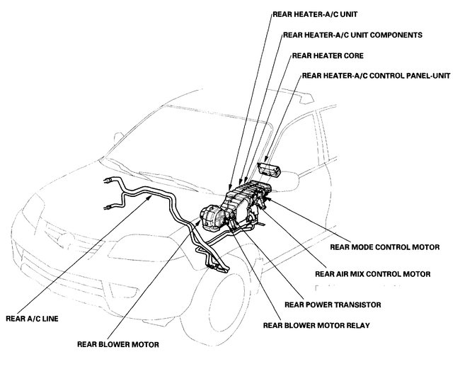

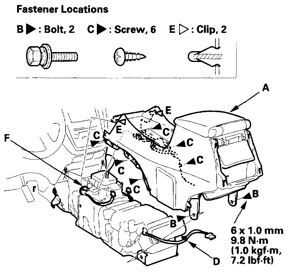

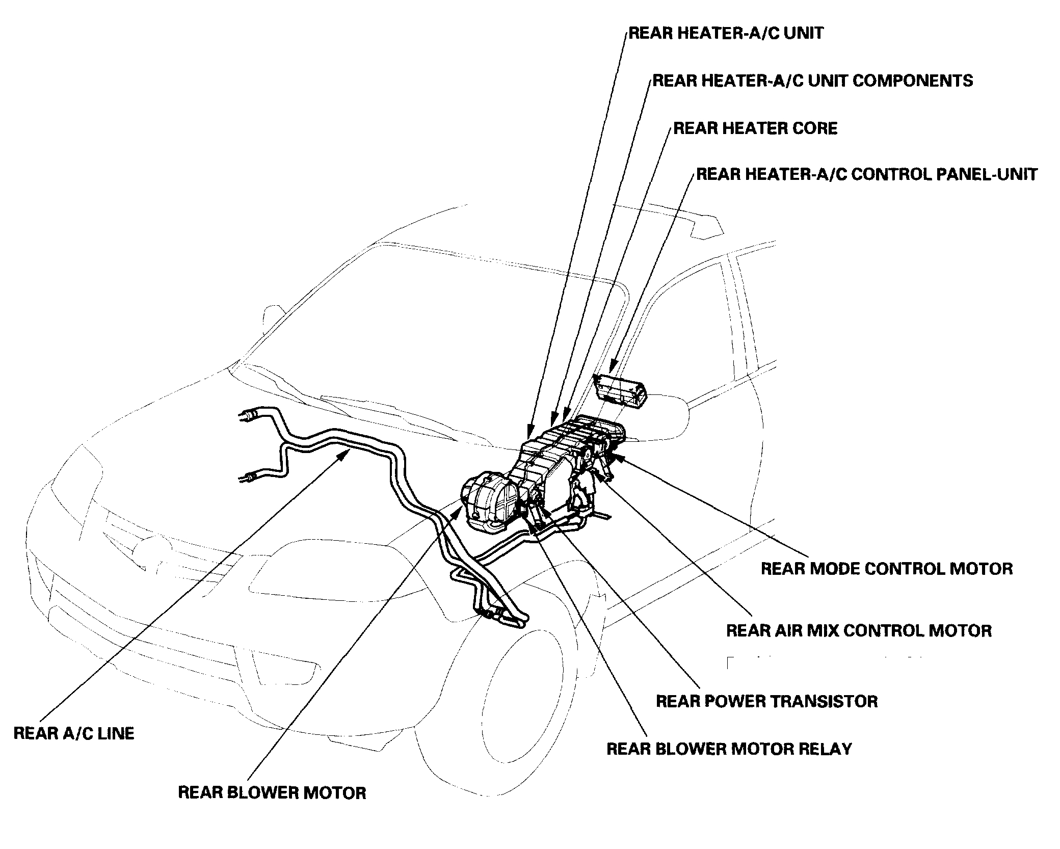

Hi, the rear air in the back of my vehicle is not working. A mechanic looked at it and said it would be expensive to fix and said he could fix it inexpensively but I can either have A/C or heat, not both. It was in the summer so I went with air but now it is getting cold. What is the switch he is referring to? Can I do it myself? What part would need replacing? Short on cash but just want to be comfortable driving. Also, the lighter does not work, did not know if that is connected to the other problem.
Thank you!
Linda
Nov 29, 2018 at 7:23 AM
  • 110,251 POSTS
Based on your description, it sounds like the rear air mix control motor is bad (AKA, blend air door actuator). Basically, that is what determines if you get heat or AC. Most likely, he disconnected it in the position you requested.
With that in mind, you should be able to replace it yourself. In general, a air mix control motor is a pain, but this should not be too bad,
Here is link that shows in general how one is replaced. It is being done on the front system.

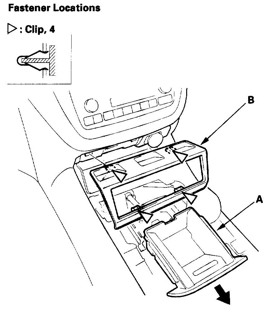

Now for yours, here are the specific directions. The hardest part will be getting into the center console. The first two pictures show the component and its location.

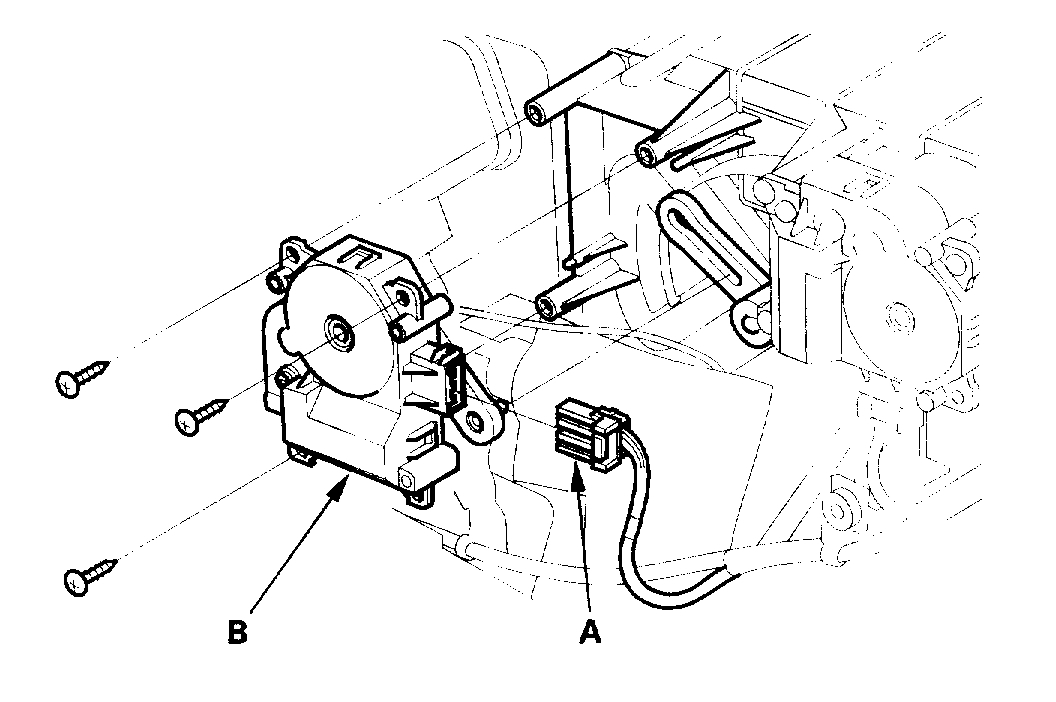

Rear Air Mix Control Motor Replacement
1. Remove the center console.
2. Disconnect the 7P connector (A) from the rear air mix control motor (B). Remove the self-tapping screws and the rear air mix control motor from the rear heater-A/C unit.
3. Install the motor in the reverse order of removal. Make sure the pin on the motor is properly engaged with the linkage. After installation, make sure the motor runs smoothly.

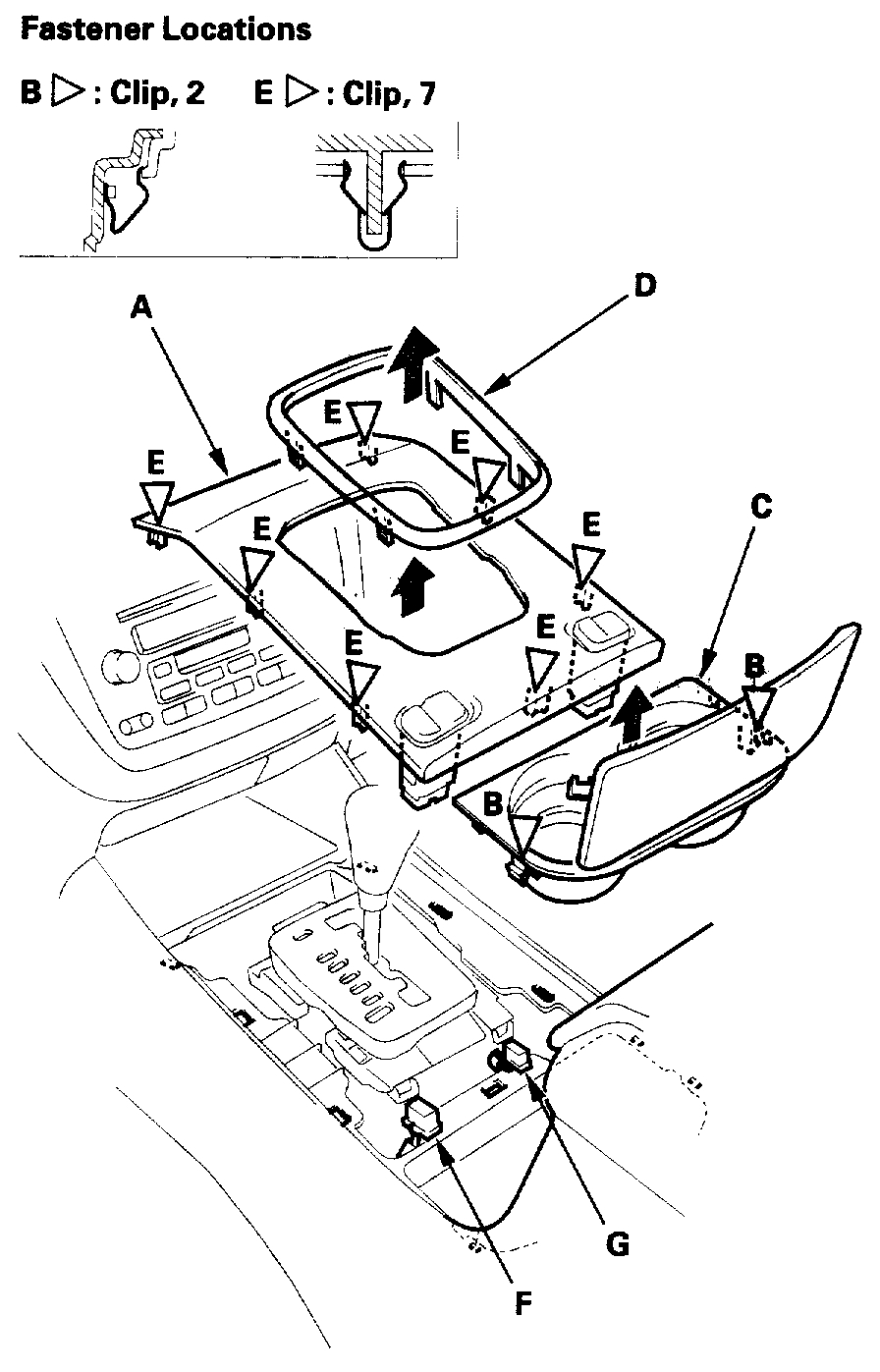

If you decide to do it, here are the directions for removing the center console. It looks intimidating, but if you take your time, you will be fine.
_________________________________________________________
Center Console Removal/Installation
The remaining pictures correlate with these directions.

1. Remove the console pane: (A).
1. Detach the clips (B) by pulling the beverage holder (C) up, then remove it.
2. Remove the shift indicator trim ring (D).
3. Gently detach the clips (E), then remove the console panel.
4. '04-06 models disconnect the footwell light connector (F) and ambient light connector (G).

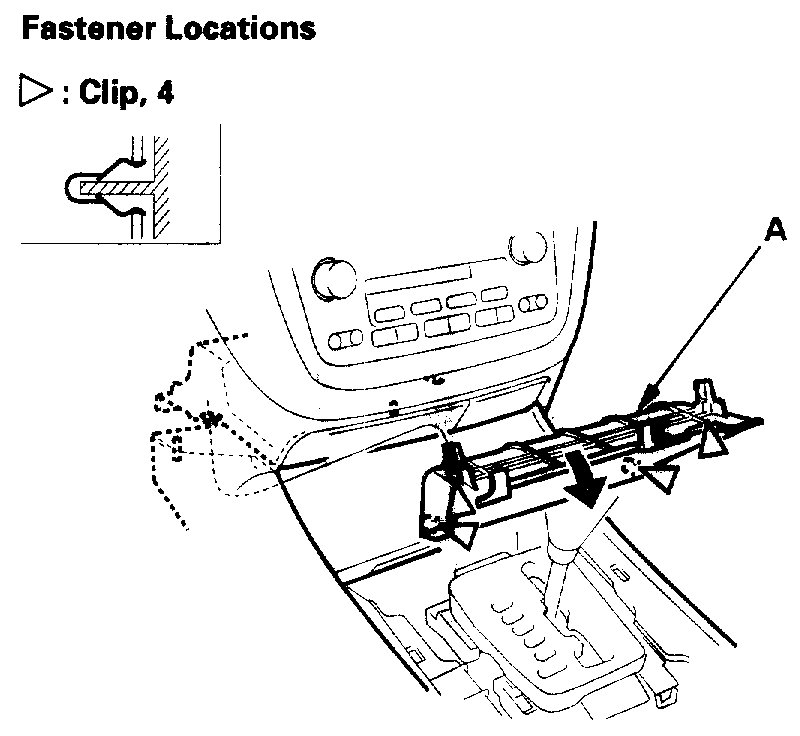

2. Without rear entertainment system: Detach the clips by hand, and remove the center panel lower trim (A).
3. With rear entertainment system: Remove the coin pocket (A). Pull the DVD panel (B) out to detach the clips, then remove the panel.

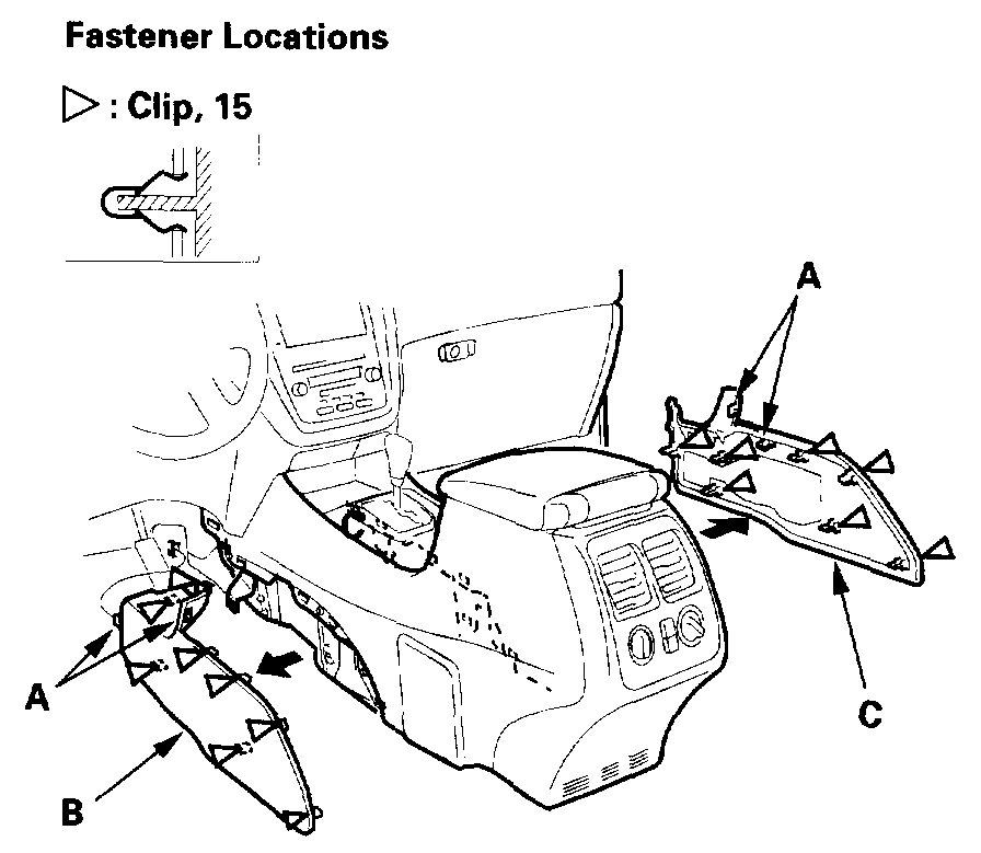

4. Remove both front seat riser covers.
5. Detach the clips and release the hooks (A), then remove the driver's console side trim (B) and passenger's console side trim (C).

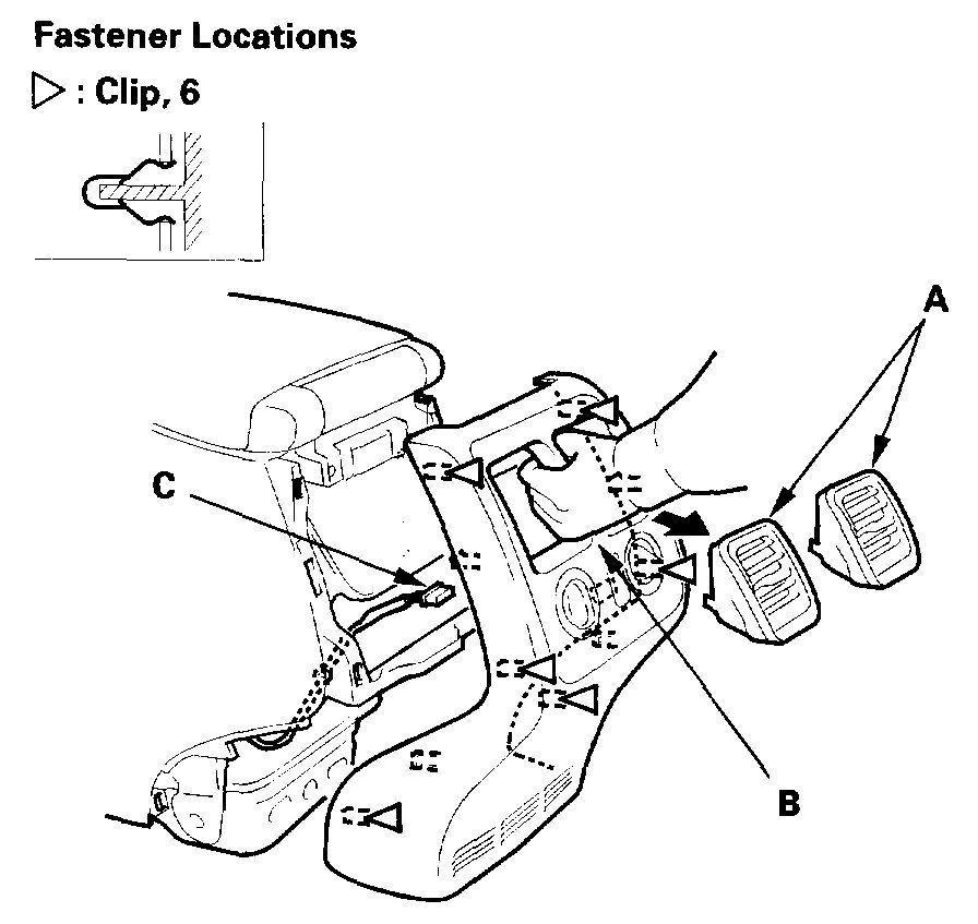

6. Remove both vents (A). Reach into the air vents holes as shown, grab the console rear trim (B) and pull it out. Then disconnect the rear heater-A/C passenger's control panel-unit connector (C).
7. Remove the center console (A).
1. On both sides, remove the bolts (B) and screws (C).
2. Detach the harness clip (D).
3. Pull the center console back to detach the clips (E).
4. While lifting up on the console, disconnect the accessory socket subharness connector (F), and remove the console.
