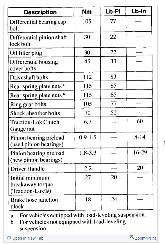

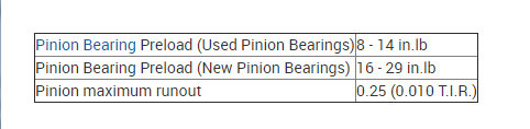

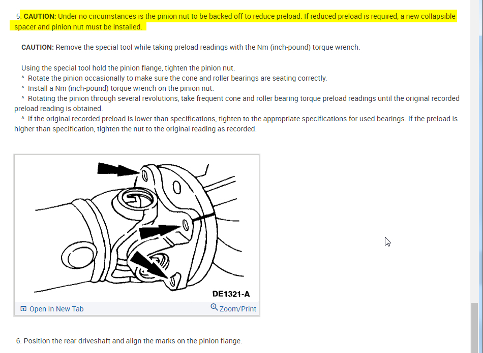

I'm changing the pinion and carrier bearings, 8.8 rear end 2 wheel drive. what it's the pinion bearing pre load? And what's the easiest way to do it?
Nov 19, 2020 at 2:49 PM

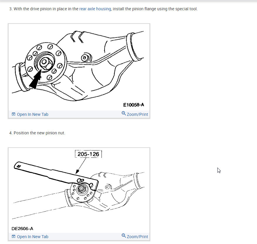

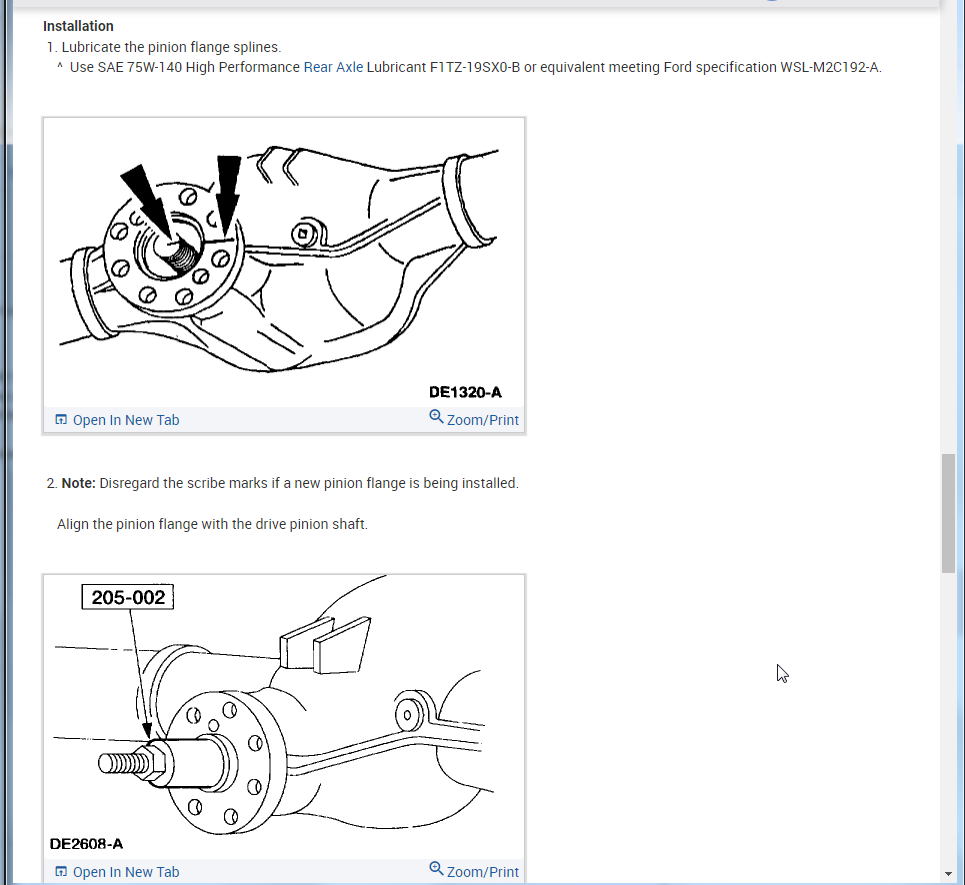

I attached the spec for the preload. The easiest way to install it is shown in the manual. Once you install it you need to use something to hold the flange in place while you crush the new sleeve. You can use the tool shown which you can get at most parts stores or you can put two bolts in the flange and use a pry bar to hold it in place.
Let us know if you have questions. Thanks

Okay. Thanks. One more question. What's the carrier bearing caps torqued at. I can't find a manual anywhere and the internet is of no real help. thanks

Isn't pre load done with just the pinion and bearings in the case by itself?
May 17, 2021 at 2:32 PM
I attached the specs for the rear end. This should be all of them.

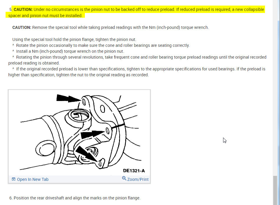

As for the preload. No this can be done with the carrier in place. Basically it is done anytime the pinion comes out or if you remove the pinion nut. You can reuse the crush sleeve if you are not taking the pinion out like if you are just replacing the pinion seal. This would just require you to measure the turning torque in inch pounds before you take the nut off. Then you tighten the pinion nut back to this inch pound. If you go to far, you cannot loosen the nut to reach the proper torque because you have crushed the sleeve more and it will loosen up and cause noise and other issues.

Okay, took rear end apart changed all bearing. Yes they are seated. went to tighten pinion.. tightened until almost broke my breaker bar. Still have play in it. yes the crush sleeve is in.. bearings all the same size as old ones... what do you think happened? It's like the nut bottomed out but yet never tightened yoke.
Can you get a video or some pictures or how you are doing this? Then at least a video of the play that you are seeing? That way we can figure out what may have happened.
Normally if you still have play and everything is installed correctly then you have not crushed the sleeve yet. Are you using a cheater pipe? If not that may be your issue. You need a lot of torque on this to crush the sleeve to leave you with the proper turning torque, which is the part measured in inch pounds.

Yes, I had a 2 1/2 f150 breaker bar and a 3 ft pipe on that. I was at the point of snapping breaker bar.
Holy cow. So in the video I posted, after he tightened the nut and stopped he showed the play in the flange. That is where you have play? As much as was shown there?
If so, clearly something isn't right and I have not experienced that before. So unfortunately I would think we need to take it back out and start over. If you replaced the pinion bearings, did you replace the races as well?

I bought new bearing kit. Checked bearings they are the same seated all races and maybe the yoke nut needs a thick washer? I don't know. Really upsetting me.. I took care to make sure everything went together as it was took apart. is something missing? Is there a washer behind yoke nut? Didn't have one and kit didn't give me one.
Okay. If you changed the bearings, then you should have measured backlash and pinion depth. If you did not check this then I am sure the pinion depth is not correct.
Here is a video that goes through the entire process for the 8.8 inch. Clearly pay attention to the shimming of the pinion but if you did not shim it then that is the issue. There is no washer as the slack is taken up by the shims.
