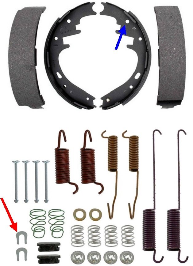

When replacing the rear drum brakes, in the replacement spring kit is a c-clip washer. Where does that go? Thank you!

That holds the parking brake lever to the brake shoe at the hole by my blue arrow. Those clips are often reused. It's the return springs that should be replaced during a professional brake job. The color they're painted denotes their strength. That strength weakens from repeated heating cycles over time.
Watch out for a real common mistake. The shoes with the shorter linings go toward the front of the van. You might find more useful information in this article:

This brake job is being done on a Toyota, but the brake design is very similar to that on your van. They're removing the clip you asked about in one of the first steps.
